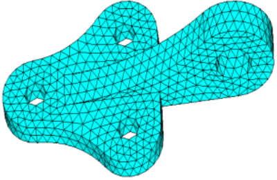

Create Tet Mesh
Use the Tet: Create tool to create tetra mesh from closed volumes of shell elements, or from solid or closed surface geometry.
From the 3D ribbon, click the tool.
