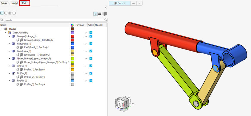

Part Browser
Use the Part Browser to create, organize and manage the CAE part structure/hierarchy.
By default, the following attributes are listed as columns.
Add or remove columns by right-clicking on a column and checking/unchecking the appropriate attribute.
- Entity
- List of the Model, Part Assemblies, Parts and Components. By default the browser is displayed in Hierarchical View.
- Color
- Displays the Component and Part entity colors.
- UID
- Displays the Part Assembly and Part Unique IDs.
- Revision
- Displays the Major revision, Study revision, and Library Part revision.
- Representation
- Displays the in-session/loaded representation.
- Active
- Displays the Part entity active status.

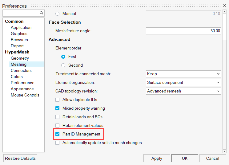

Import of a CAD Geometry
- Preference setting
- Upon opening HyperMesh, you can set the user
profile to Abaqus
Standard2D/Standard3D/Explicit via . Further, click Preferences in the
File menu and check the Part ID Management
option, as shown below.
Figure 8.

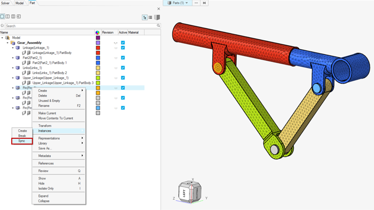

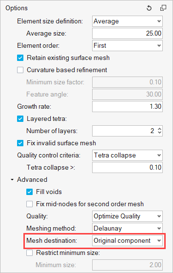

- Meshing Abaqus parts and instance format geometry
- Meshing parts individually is always recommended. When there are
multiple instances of the same part, it is crucial to mesh the first
instance of the part and synchronize the mesh to other parts. It is
always important to ensure that the part geometry that is meshed has the
mesh stored in its original component.
Figure 10.

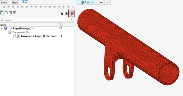

- Part content (Property, Sets, Surfaces, System, and so on)
- A double-click on any instance in the Part Browser will take it to an isolated part edit mode. Here, you can set up all the part content, such as a property with a material orientation system, sets, and surfaces that can be contained within a part. If the part has multiple instances in the model assembly, upon exiting the part edit mode, the changes and additions are automatically synchronized with other instances of the same part.

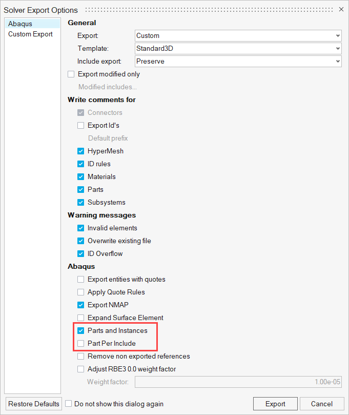

- Export
- Exporting a solver input file with Parts and Instances format requires
activating a checkbox in the solver export options, as shown below.
Figure 13.

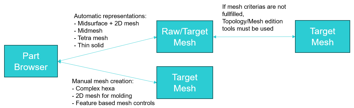

Representation Controls
A representation control is the set of settings for a given mesh strategy (2D mesh, midmesh, tetra mesh, and so on) and a target mesh size.
Set Mesh Flag equal to PDM Mesh Flag for one given method/mesh size.
Representations can be shared across multiple people by using shared libraries.
For 2D mesh representation controls, param and criteria files need to be properly set up.
