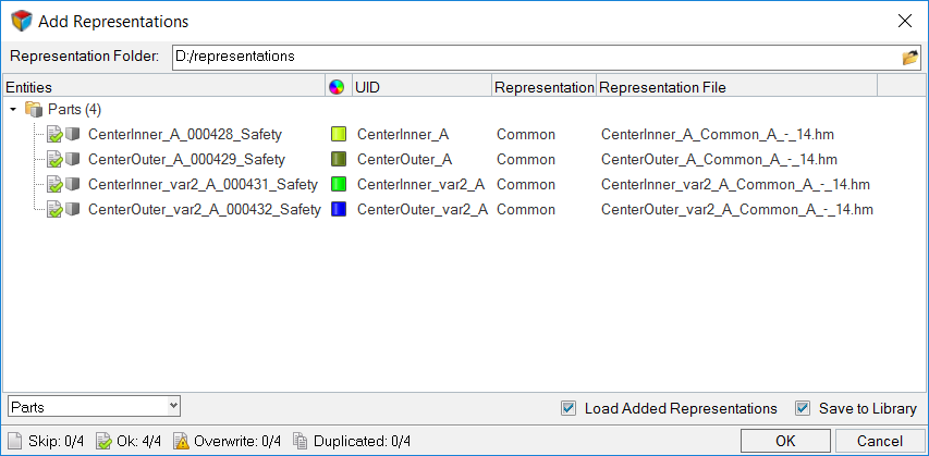

| Add | Adds representations for selected part(s) based on the chosen alias and file
type or from the Part Library. When adding representations for multiple parts or
part assemblies from external sources, the Add
Representations dialog enables you to map and associate
representation files to multiple parts simultaneously. ![]() If appropriate metadata is available in the BOM, then the alias values will be preselected. After choosing a Representation Folder, representation files will be mapped according to the Teamcenter naming convention. You can then manually select or update any of the alias and representation file values. Indicators are displayed for each part to
indicate the status of that row.
You cannot click OK to add the representations when representations are duplicated. |

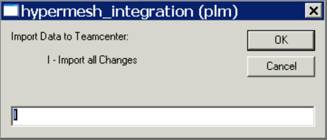

Update Teamcenter via Teamcenter-HyperMesh Integration
If HyperMesh was launched via the Teamcenter - HyperMesh Integration, you will be prompted to import updated data back to Teamcenter.

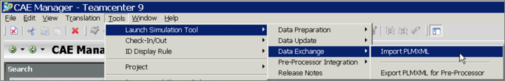

Update Teamcenter via Manual PLMXML Import in Teamcenter
If the BOM was loaded manually, for example HyperMesh was not launched via the Teamcenter-HyperMesh Integration, then the updated PLMXML package can be manually imported into Teamcenter.
- Copy the exported BOM PLMXML, along with the folder(s) containing the monolithic file, if saved, and any saved/updated representations to a convenient folder accessible by Teamcenter.
Select Import PLMXML to import the updates.

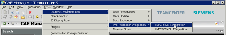

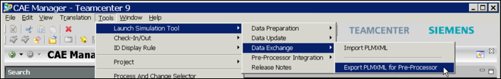

In Teamcenter, select the Pre-Processor Integration
option to export the PLMXML package to the last run folder, which Teamcenter
continues to interact with until the HyperMesh
session is closed.
Once closed, Teamcenter prompts you to accept or reject updates. The last run folder is then automatically cleaned up.
Export the PLMXML package so that you can work on it over time by selecting the
Export PLMXML for Pre-Processor option.

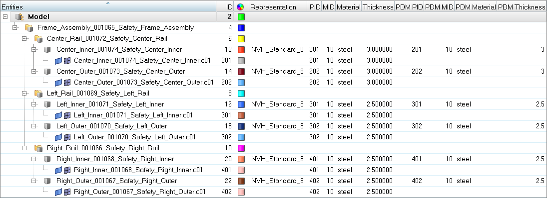

- The resulting PLMXML BOM file, along with its associated data files, will be exported to the last data folder and can be imported directly into HyperMesh via .
The BOM is displayed in the Part Browser.

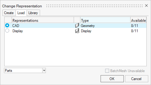

Load Representations from Current HyperMesh Session
- In the Part Browser, right-click on part assemblies or parts and select from the context menu.
In the Change Representation dialog, Load tab, select a
type of representation to load.
Representations that exist in the repository are shown in the Representations column, and their availability is indicated in the Available column.
Figure 6.
To send unavailable representations to the BatchMesher directly from the Change
Representation dialog, select Batch Mesh
Unavailable.
Note: Available representations will also be loaded when you click OK if Batch Mesh Unavailable is selected.
- To save the representations to the Part Library, select the Save to Library checkbox.
- Click OK.
In the Confirm Load Representation dialog, specify how
representations are loaded.
- Click Load All to load all available representations into the current session for selected parts.
- Click Skip Loaded to ignore representations that are already loaded for selected parts.

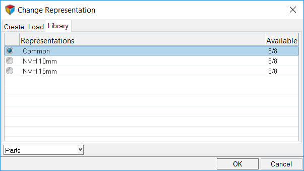

Load Representations from the Part Library
After importing a BOM that has representations saved in the Part library, you can load the saved representations.
- In the Part Browser, right-click on a part/part assembly and select from the context menu.
- In the Change Representation dialog, Library tab, select representations and click OK.

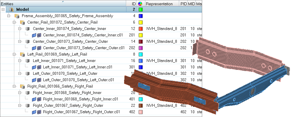

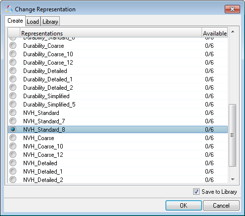

Create Mesh Representations
- In the Part Browser, right-click and select from the context menu.
In the Change Representation dialog, Create tab, select
the NVH_Standard_8 representation.
Each representation is uniquely identified by its alias and file type. For example, “NVH_Standard_8/HyperMesh” and “NVH_Standard_8/Nastran” representations.
The appropriate representation will automatically be selected, based on the available PLMXML metadata: discipline, mesh representation, and mesh density. If the appropriate metadata is unavailable, then you can select the desired representation type to create. In the Change Representation dialog, Create tab, only HyperMesh representations can be created.
Per the current Teamcenter-HyperMesh integration rules, only one representation per file type is allowed per part. This means that you can only have a single HyperMesh file type representation, Nastran file type representation, CAD representation, and so on for each part. For example, if you create a NVH_Standard_8/HyperMesh representation and then subsequently create a NVH_Coarse_15/HyperMesh representation, the NVH_Coarse_15/HyperMesh representation will become the only HyperMesh representation for the given part.Figure 8.
- To save the newly created representations to the Part Library select the Save to Library checkbox.
- Click OK.
BatchMesher is invoked, and meshes are created using the appropriate batch meshing parameter and criteria files.
The parameter and criteria file mappings are configurable based on the batchmesher_config.cfg file available in the installation.
