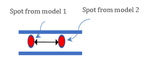

- position
- Position (Coordinates) difference between spot weld 1 and spot weld 2
will be reported if ON. Allowable positional difference is less than
tolerance value.
Figure 3.

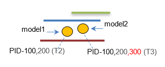

- part-id
- Part ID differences between spot weld 1 and spot weld 2 will be reported
if ON.
Figure 4.
