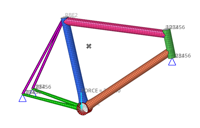

    A finite element model appears in the modeling window.

  2. In the modeling window, select the blue seat_tube property and the orange down_tube property.
  3. In the microdialog, click Create.
    Two gauge design variables are created.
