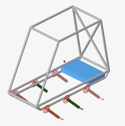

- Open the Track_Start.mdl model file.
Review the model.
- The model is in the mm, Kg, N, sec unit system.
- The model has two systems: Body and Suspension.
- The Body system contains the Vehicle body (Frame) and Engine fixed to each other.
- The Suspension system has three trailing arms connected with a torsional spring damper.
- There are two unresolved motions used to drive the vehicle, Motion Left and Motion Right.

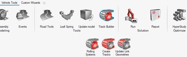

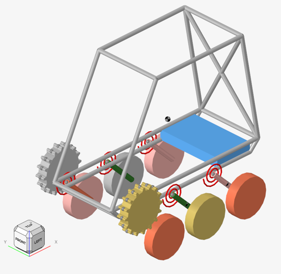

Create Rolling Systems
From the Vehicle Tools menu, under Track
Builder select Rolling systems.
Figure 3.

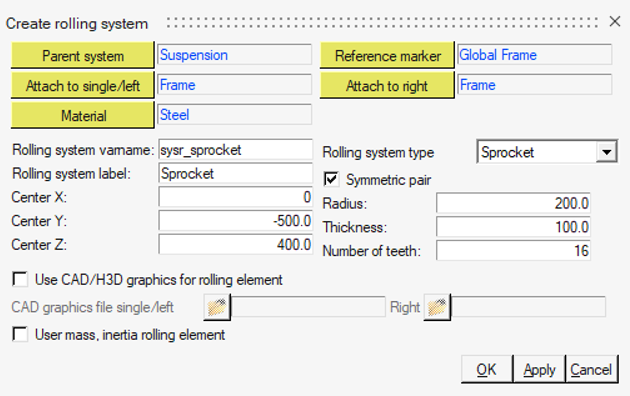

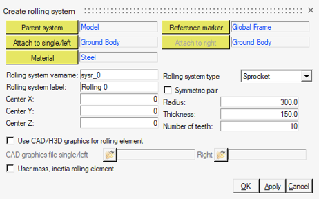

The Create rolling system dialog is shown below:Figure 4.
- Under Parent System, select Suspension.
Select the Symmetric pair check box to create both the
left and right rolling system together.
Note: The symmetry needs to be about the x-z plane. The Symmetric pair does not create MotionView pair entities, instead it creates two entity copies positioned in the symmetry plane.
- Click on Attach to single/left and select the Frame body.
- Click on Attach to right and select the Frame body.
- Specify sysr_sprocket and Sprocket as the Rolling system varname and Rolling system label.
- Select the Rolling system type as Sprocket.
Enter the following parameters:
Center X Center Y Center Z Radius Thickness Number of Teeth 0 -500 400 200 100 16 -
Click Apply to create the sprocket systems and continue
in the Creating rolling system dialog.
The complete dialog is displayed below:
Figure 5.
Repeat steps 2 to 9 using the following table to create three symmetric rolling
systems of type Wheel.
Tip: Use the Apply button to keep the dialog open when creating multiple rolling systems.
Parent System Attach to Single/Left Attach to Right Rolling system varname Rolling system label Center Radius Thickness X Y Z Suspension Front Arm-Left Front Arm-Right sysr_frontwheel Front Wheel 300 -500 0 200 100 Suspension Mid Arm-Left Mid Arm-Right sysr_midwheel Middle Wheel 800 -500 0 200 100 Suspension Rear Arm-Left Rear Arm-Right sysr_rearwheel Rear Wheel 1300 -500 0 200 100 The model with the rolling systems is shown below:Figure 6.

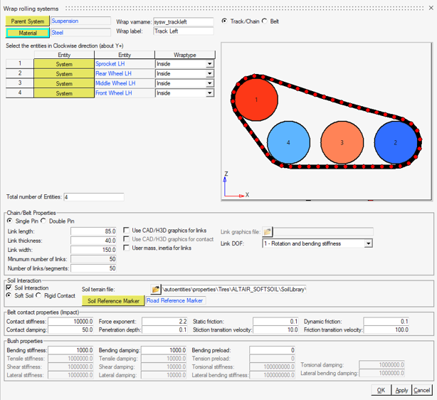

Create Track Systems
Builder select Create Tracks.
Figure 8.

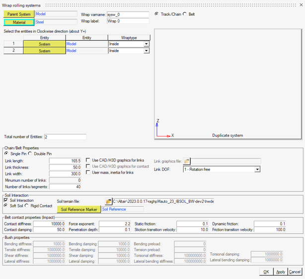

The Create track dialog is displayed:Figure 9.
- Select Suspension as the Parent System.
- Set the Wrap varname as sysw_trackleft and the Wrap label as Track Left.
Enter 4 in the Total number of
Entities field to wrap on the four rolling systems that were
created.
This will update the entity selector table to enter four values.
Select Systems to wrap in the order shown below. Keep
Wraptype as Inside for each
system.
- Sprocket LH
- Rear Wheel LH
- Middle Wheel LH
- Front Wheel LH
- Select Single Pin as Chain/Belt Properties.
- Enter Link length as 85.0, Link thickness as 40.0, and Link width as 150.0.
- Enter 50 for Number of links/segments as suggested in the Minimum number of links.
- Select 1-Rotation and bending stiffness for Link DOF.
- Under Soil Interaction, select Soft Soil.
- Under Soil terrain file, select heavy_clay_25_custom_obs.rdf from Altair HyperWorks installation directory <install_dir>\hwdesktop\hw\mdl\autoentities\properties\Tires\ALTAIR_SOFTSOIL\SoilLibrary.
Select the Road Reference Marker as Soil
Reference Marker.
Figure 10.
Click OK to create the left side track.
Figure 11. Left Side Track Created

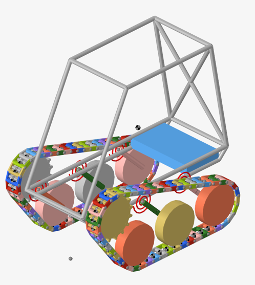

- Open the Create Tracks dialog to build the right side track. The previous selections are stored in the dialog.
- Set the Wrap varname as sysw_trackright and the Wrap label as Track Right.
system.
- Sprocket RH
- Rear Wheel RH
- Middle Wheel RH
- Front Wheel RH
- All other fields are already populated with the parameters from the left side track. Click OK to create the track and close the window.

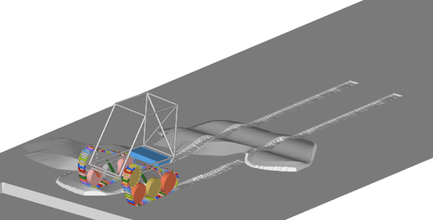

The completed model is shown below.
Figure 12.

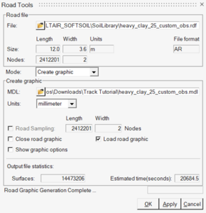

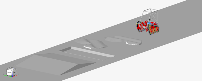

Click on Road Tools to invoke the dialog.
Figure 13.
- Under File, load the heavy_clay_25_custom_obs.rdf file from the installation directory <install_dir>\hwdesktop\hw\mdl\autoentities\properties\Tires\ALTAIR_SOFTSOIL\SoilLibrary.
Under MDL, select a location to save the
heavy_clay_25_custom_obs.mdl file in the
<working directory>.
Figure 14.
- Click OK to create the road graphics.

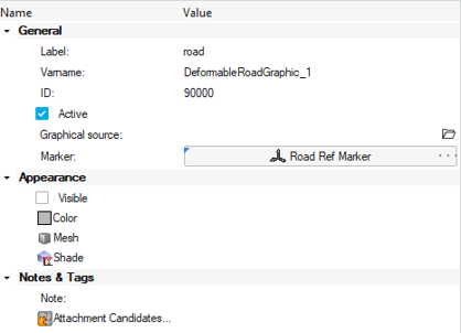

After road graphics creation, select the road graphics
in the Model Browser under the created Road Graphics systems
and define the Road Reference Marker in the Entity Editor.
Figure 15.
Figure 16.
The Track with Terrain Graphics is shown below.
Figure 17.
- Save the model as Track_complete.

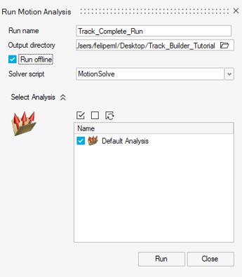

Simulation and Post-Processing
Under the Vehicle Tools menu, go to Run and open the
Analysis settings dialog.
Figure 18.
Select the Run Offline check box and click the
Run button.
Figure 19.

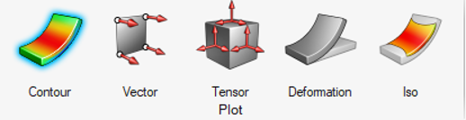

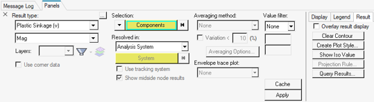

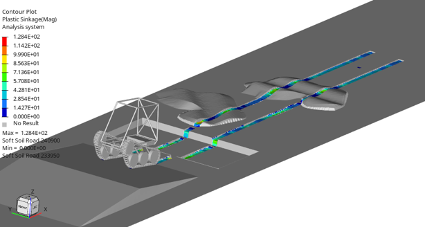

Click on the Contour option in the Ribbon to visualize
the soil plastic sinkage.
Figure 22.
From the panel, select Plastic Sinkage as result type
and click Apply.
Figure 23.
Figure 24.

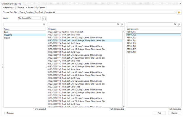

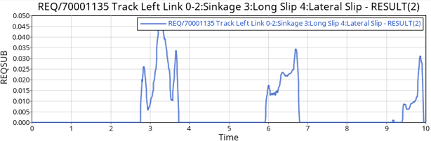

- Click on Open model and load the Track_complete.abf file from the MotionSolve run.
Under Y type select REQSUB, a list of soft soil results
is displayed. Select Track LH Link 0 and
RESULTS(2) to plot the sinkage of the left track link
0.
Figure 26.
