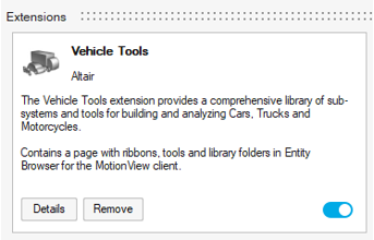

  2. From File, click Extensions and load the Vehicle Tools extension.
    Figure 1. Load Vehicle Tools

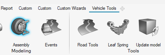

  3. From the Vehicle Tools ribbon, click on the Assembly icon to open the Assembly Wizard.

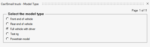

  4. Select Full vehicle with driver from the wizard and click Next.
    Figure 3. Select Type of Model

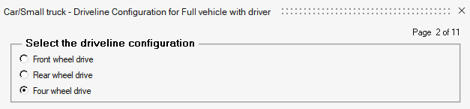

  5. Select the Four Wheel Drive option for driveline configuration and click on Next.
    Figure 4. Select Driveline Configuration

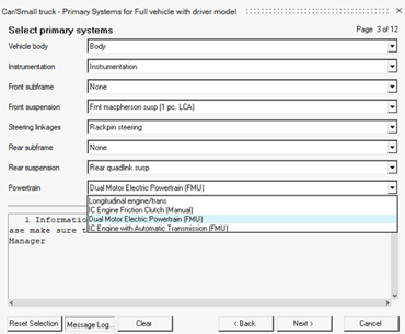

  6. In Primary systems page, select Dual Motor Electric Powertrain (FMU) under powertrain.
    Figure 5. Select Type of Powertrain

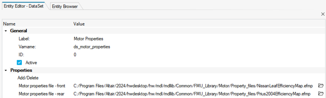

  1. In the Model Browser, expand the Dual Motor Electric Powertrain (FMU) system.
  2. Locate the Motor Properties dataset menu under Data Sets. In Entity Editor, there are two files:
    1. Motor properties file - front
    2. Motor properties file - rear
    Figure 8. Motor Properties File

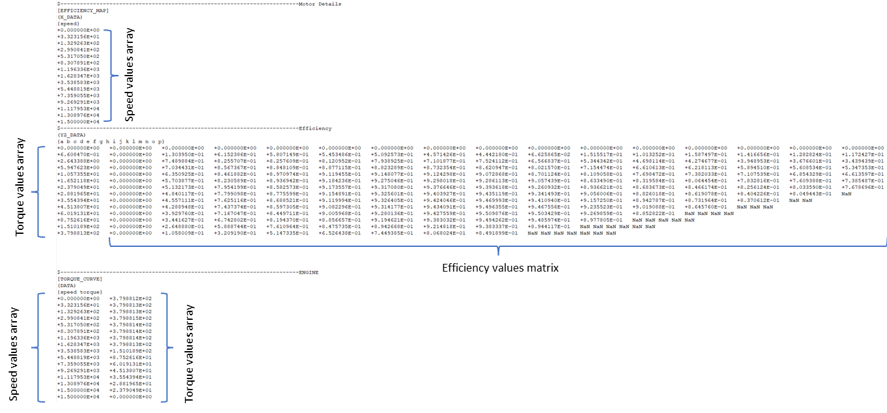

    Both contain information regarding each motor’s efficiency and maximum torque. This data is organized in teimorbit format files and is derived from the FMU to contribute to motor control.
    The default files consist of two motors with different specifications. Specifically, the first section of the file contains data related to the efficiency map of the motors. Motor’s torque limits data is included in the file’s second section.
    Figure 9. Motor Properties .efmp File
  3. To replace the front motor with a new one, click on the open icon and select the ‘Front_Motor.efmp’ file from the tutorial folder. Repeat the process for ‘Rear_Motor.efmp’ to also change the rear motor.
    Figure 10. Selected Motor Property Files
    The front motor has a power output of 64.5 kW and a rated torque of 382 Nm, while the rear motor has a power output of 97 kW and a rated torque of 219 Nm.
    Instead of using new files, you can also try to modify the existing ones by saving them in a directory separate from the system’s installation.

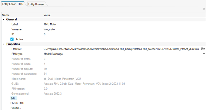

  1. Click on the FMU Dual Motor and select Edit in Entity Editor.
    Figure 11. FMU Properties Section in Entity Editor
  2. Within the FMU, the VCU defines a torque distribution strategy, with respect to system’s efficiency optimization. Currently, there are four options available: ‘Evenly Distributed’, ‘Single Axle’, ‘Switch after Threshold’ and ‘Optimal Torque Ratio’.
    1. Evenly Distributed (ED): The torque distribution is evenly split between the front and rear axles, constituting a 50-50 balance. Input 1 as ‘vcu_type’ parameter value to select this control strategy.
    2. Single Axle (SA): all of the torque is directed to the rear axle, representing a 100% rear axle torque distribution. Input 2 in ‘vcu_type’ parameter to select.
    3. Switch after Threshold (ST): the power losses are calculated and the VCU selects between SA and ED, with respect to power loss reduction. Input 3 in ‘vcu_type’ parameter to select.
    4. Optimal Torque Ratio (OTR): an optimal 3D torque map is formed offline, that establishes the optimum torque distribution in the range 0-100%, for all possible speed- torque demand scenarios. During the simulation, the right torque distribution is decided using it as a Look-up Table. Input 4 in ‘vcu_type’ parameter to select.
  3. Navigate to parameters section, locate parameter vcu_type and pick value 3. This way, the torque distribution strategy ‘Switch after Threshold’ is selected.

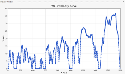

  4. Check the curve shape to make sure the correct values are selected, by clicking on Show Curve.
    Figure 16. WLTP Cycle

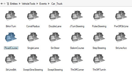

  5. From the Entity Browser, navigate to Vehicle Tools → Events → Car & Truck and double-click on the Road Course event.
    Figure 17. Choose an Event
  6. In the Entity Editor, label the Event as ‘WLTP cycle’ with Varname ‘wltp’.

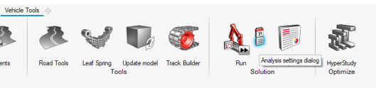

  1. Under the Vehicle Tools ribbon, go to Run and open the Analysis settings dialog.
    Figure 20. Open Run Motion Analysis Settings Dialog

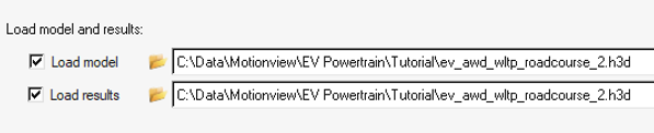

  6. After the simulation finishes, open a new HyperView window to visualize the results.
    1. Click on the Open Model button, load the .h3d file in the panel, and click Apply.
      Figure 22. Open Model
      Figure 23. Load .h3d File

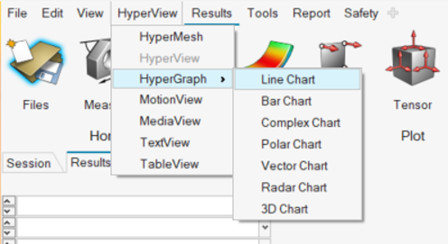

  9. Select the HyperGraph> Line Chart application.
    Figure 24. Switch to HyperGraph to Plot the Results

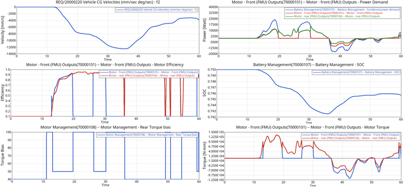

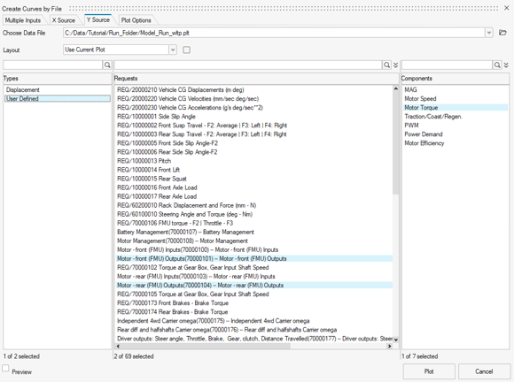

  12. Select the following results file outputs from User Defined type:
    • Vehicle CG Velocities
    • Battery Management → SOC
    • Motor Management Rear → Torque Bias
    Figure 26. Plotting Outputs in HyperGraph
    Figure 27. Simulation Results
    These results contain important information for monitoring vehicle’s overall efficiency, power consumption and torque distribution.
    • Top-Right Plot: This plot displays the power demand inputs from each motor's inverter to the battery pack, along with the combined power from both motors. Positive values indicate discharging (tractive) regions, while negative values represent charging (regenerative) regions.
    • Middle-Left Plot: In this plot, you can observe the efficiency of the motors as they vary over time.
    • Middle-Right Plot: This plot illustrates the state-of-charge of the battery. A decrease in the state-of-charge is a result of battery discharge, while an increase is due to charging from regenerative braking.
    • Bottom-Left Plot: Here, you can find the torque distribution ratio, which is determined by the 'Switch after Threshold' method. This method dynamically switches between values 0.5 (ED) and 1 (SA), depending on power losses and 0.4 during regenerative braking. The selection of a 0.5 ratio at this point significantly minimizes power losses, when compared to the 1(SA) setting.
    • Bottom-Right Plot: This plot displays the torque outputs of both motors. Positive values indicate the tractive region, while negative values represent the regenerative braking region.
    Optionally, you can repeat this process for different torque distribution strategies by selecting a different ‘vcu_type’ in the third step of the tutorial. For example, choosing the ‘Optimal Torque Ratio’ method would result in a different torque bias diagram, utilizing all possible torque ratios in the range of ‘0-1’. This, in turn, leads to different power consumption for the same speed profile.

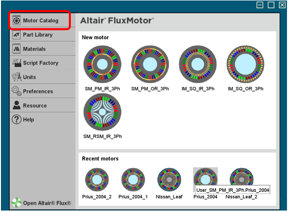

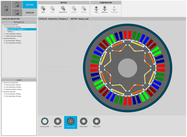

  1. Start FluxMotor and click on Motor Catalog.
    Figure 28.
  2. In motor catalog, choose Automotive Transport and double-click on the Nissan Leaf icon.
    Figure 29.

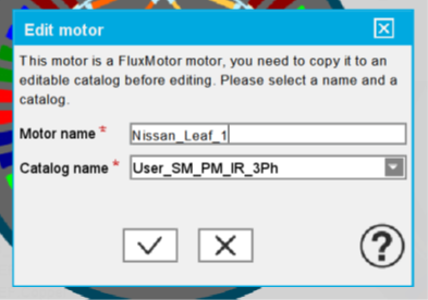

  3. Specify the Motor Name as Nissan_Leaf_1, keep Catalog Name as User_SM_PM_IR_3Ph and click the Check button to open the Motor Factory.

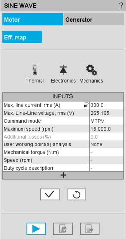

  5. The analysis inputs are displayed in the SINE WAVE dialog.
    Figure 32.

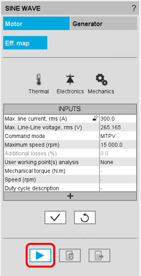

  7. Click on the Start icon to launch the analysis.
    Figure 34.

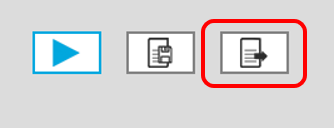

  8. After the FluxMotor analysis is finished, you can review the results of motor’s performance and click on Export results icon to save them.
    Figure 35.

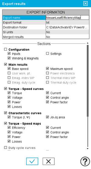

  9. In the Export results dialog, enter the Export name as NissanLeafEfficiencyMap and set the Destination folder as your <working directory>.
  10. Make sure you have selected all the check boxes as shown below and click on the Check button:
    Figure 36.
    FluxMotor exports 27 .txt files containing the motor’s characteristics. From these, two files will be used to create the efficient map file used in the Dual Motor Electric Powertrain FMU, namely NissanLeafEfficiency map_torque_curve.txt and NissanLeafEfficiency map_efficiency_map.txt. Open the files in a text editor to see the motor characteristics tables.

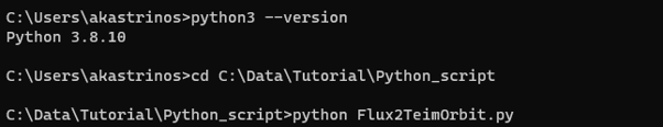

To continue the tutorial, it is important to have Python installed in your machine. For the next steps, it is assumed that Python is installed and accessible through the Command Prompt.
In this step you will use the script provided in the tutorial folder to convert the FluxMotor’s result files into the .efmp file to be used in the Dual Motor Electric Powertrain.
  1. Copy the following files into a new directory:
    • Flux2TeimOrbit.py: python script used to generate the .efmp file
    • NissanLeafEfficiencyMap_efficiency_map.txt: FluxMotor output efficiency map related .txt file
    • NissanLeafEfficiencyMap_torque_curve.txt: FluxMotor output torque curve related .txt file
  2. Open the Command Prompt.
    1. Insert the following command to register the script’s directory: cd <new_directory>
    2. Once the directory is registered, enter python Flux2TeimOrbit.py to execute the script, as shown below:
      Figure 37.

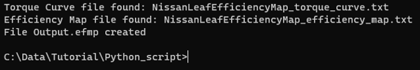

    3. If the script is executed properly, you will receive the following outputs:
      • A printed message detailing the files used for the data extraction, thus the Torque Curve and Efficiency Map file names.
      • A printed message ‘File Output.efmp created’.
      • The Output.efmp file saved in the script’s folder.
      Figure 38.
    Note: The script searches for the result files with suffixes ‘_torque_curve.txt’ and ‘_efficiency_map.txt’. Therefore, you should not keep files from different motor models in the same directory or remove these suffixes from the file names.
  3. With the generated .efmp, you can now update the Dual Motor Electric Powertrain FMU with the new motor characteristic.
  4. (Optional) With Output.efmp motor file, return to Step 2 and enter the file as Motor properties file - front in the Motor Properties Dataset to change the electric vehicle’s front motor. Re-run the simulation to test the vehicle’s performance with the new electric motor.
