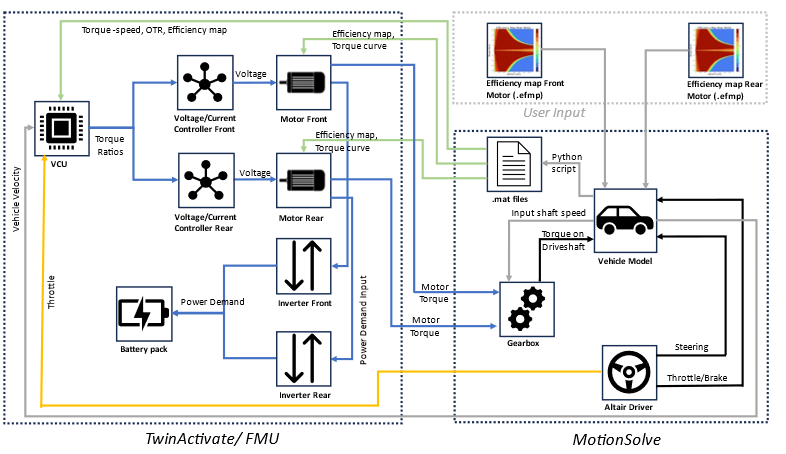

Powertrain Architecture in Twin Activate

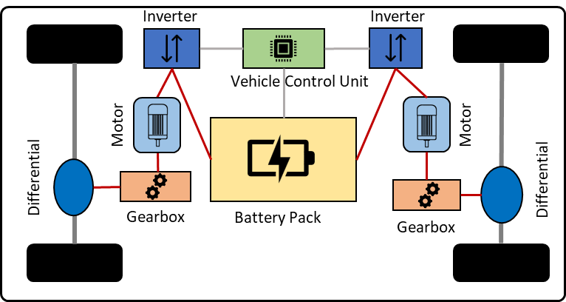

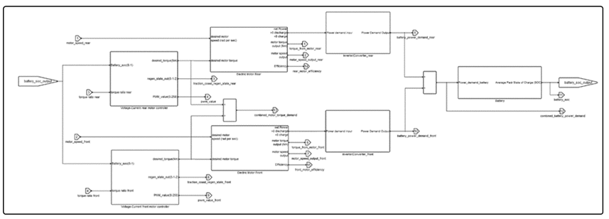

- Dual Motor Superblock
- The Dual Motor superblock constits of two Permanent Magnet Synchronous Motors, two
Voltage-Current controllers, two Inverter/Converters, and a Battery Pack.
Figure 3. Dual Motor Superblock in Twin Activate

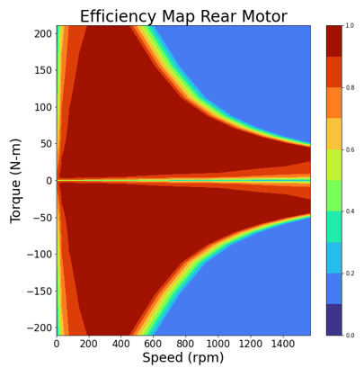

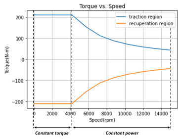

vehicle simulations and ensures accurate calculation of power consumption.The Torque-Speed characteristic curve is particularly significant as it delineates the torque boundaries for both the motor's tractive (positive) and regenerative braking (negative) regions, as shown in the figure below. These boundaries illustrate the maximum positive and negative torque that the motor can generate. The PMSM motor's characteristics encompass two distinct regions: a constant torque region and a constant power region. The motor can deliver its maximum torque up to its rated speed, and beyond that point, it can supply its maximum power.
Figure 4. Torque-Speed Characteristic Curve
The Torque-Speed-Efficiency curve, also known as efficiency map, is responsible for providing the efficiency values for each motor depending on its operating region. It also contains information for the motor’s traction and regenerative braking region as shown in the figure below.Figure 5. Torque-Speed-Efficiency Characteristic Curve

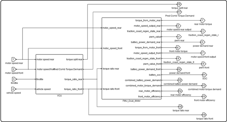

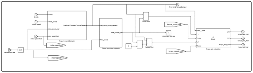

- Vehicle Control Unit Superblock
- The Vehicle Control Unit block consists of the Torque Demand Estimation, the Torque
Distribution Algorithm, and the Torque Ratio Calculation.
Figure 6. 1D Representation of the Vehicle Control Unit’block in Twin Activate

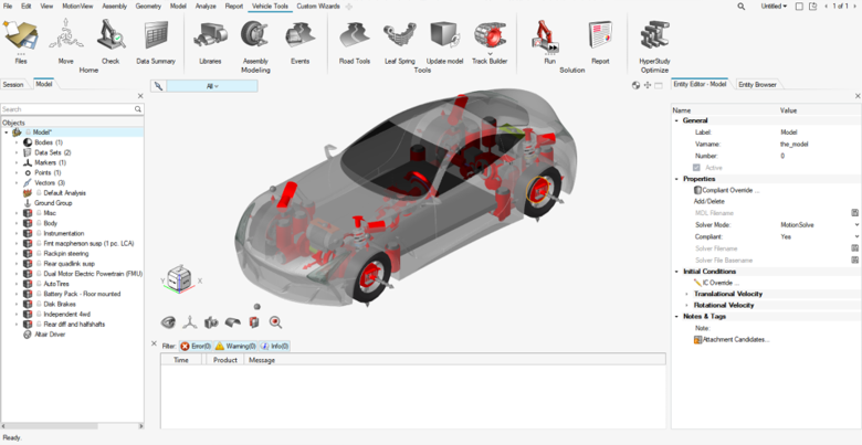

Powertrain Model in MotionView
In the MotionView MDL system, the motors, inverters, and battery are represented as rigid bodies including their mass and inertia properties, which are a significant portion of BEV’s total mass and inertia. Two forces under Gearbox systems represent the driving torques attached to the driveshaft. Four Solver variables connect the FMU channels to the Altair Driver. Datasets contain crucial information on motor bodies’ properties. Moreover, each motor’s bushings are provided, that define the positions where the motors are based. Finally, the Altair Driver uses a Feedback Controller for speed and acceleration control.

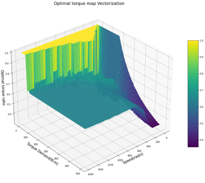

- And finally, execute – if selected - the OTR torque distribution strategy to generate the optimal torque ratio map.

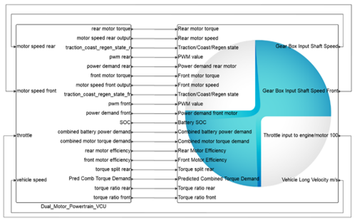

- Represents the FMU of the Dual Motor Electric Powertrain with inputs, outputs,
parameters, and solver settings. The inputs of the FMU powertrain can be customized
and you are free to change the system, however some inputs and outputs need to be
present to correctly simulate a driver event. The schematic below shows the necessary
inputs and outputs of the FMU powertrain block. The powertrain receives throttle,
transmission input shaft speed front and rear, vehicle speed and outputs torque.
Figure 11. Dual Electric Motor Powertrain with VCU Co-simulation in Twin Activate
- FMU Inputs
Connections Description Units Comments Motor speed rear Rear Gearbox input shaft speed rad/s Motor speed front Front Gearbox input shaft speed rad/s Throttle from driver The accelerator pedal’s input from driver 0 - 100 Unit conversion required from MV’s 0-1 to FMU’s 0-100 Vehicle speed Vehicle’s longitudinal velocity m/s Unit conversion required from MV’s mm/s to FMU’s m/s - FMU Outputs
Connections Description Units Comments Torque from rear motor The output torque from the rear motor N-m Unit conversion required from FMU’s N-m to MV’s N-mm Motor speed rear output rear motor shaft speed rad/s Traction Coast Regen State rear Integer value that shows the operating mode of the rear motor: -1 indicates that powertrain is in regenerative braking mode, 0 means it is operating in coasting band and a value of 1 indicates that the motor is operating in tractive region -1, 0, 1 PWM rear value It corresponds to the pulse width modulation value which can be converted to voltage applied to the rear motor 0-250 Power demand rear motor Power demand from rear motor to the battery Watt Torque from front motor The output torque from front motor N-m Unit conversion required from FMU’s N-m to MV’s N-mm Motor speed front output Front motor shaft speed rad/s Traction Coast Regen State rear Integer value that shows the operating mode of front motor: -1 indicates that powertrain is in regenerative braking mode, 0 means it is operating in coasting band and a value of 1 indicates that the motor is operating in tractive region -1, 0, 1 PWM front value It corresponds to the pulse width modulation value which can be converted to voltage applied to the front motor 0 - 250 Power demand front motor Power demand from front motor to the battery Watt Battery SOC The state of charge of the battery 0 - 1 Combined battery power demand The combined battery demand from both motors Watt Combined Motor Torque Demand The combined torque demand from both motors N-m Unit conversion required from FMU’s N-m to MV’s N-mm Rear motor efficiency Rear motor’s efficiency 0 - 1 Front motor efficiency Front motor’s efficiency 0 - 1 Rear torque spit Torque distribution, using rear motor as a reference point 0 - 100 Predicted combined torque demand The combined motor torque demand predicted by the VCU N-m Unit conversion required from FMU’s N-m to MV’s N-mm Torque ratio rear Rear motor’s torque ratio 0 - 100 Torque ratio front Front motor’s torque ratio 0 - 100 - FMU Parameters
Parameters Description Units converter_efficiency Converter’s efficiency value inverter_efficiency Inverter’s efficiency value num_modules_pack_parallel Number of module packs in parallel num_cells_per_module_parallel Number of cells per module in parallel capacity_cell Cell’s capacity Amp-hours battery_charging_losses Coefficient to determine battery charging losses while at recuperation region nominal_voltage_cell Cell’s nominal voltage V num_cells_per_module_series Number of cell rows per module num_modules_pack_series Number of module packs rows SOC_initial Initial State-Of-Charge level (%) battery_discharging_losses Coefficient to determine battery discharging losses while at tractive region emotor_efficiency_scale Parameter to enable efficiency scaling max_pwm Maximum PWM value pwm_zero_torque PWM value corresponding to 0 torque output SOC_limit_high Upper limit for SOC SOC_limit_low Lower limit for SOC max_vehicle_speed Vehicle’s maximum velocity m/s coast_m Polynomial degree to determine coasting region coast_phi At what pedal value coasting is desired coast_ch Range of coasting to define pcl and pcu values max_pedal Maximum throttle value 0 - 100 traction_gamma Polynomial degree to define the correlation between throttle and torque ratio for the traction region regen_psi Order of polynomial to define the correlation between throttle and torque ratio for the regenerative region traction_max Percentage of maximum available torque N-m pedal_0_regen_percent 1-4 These parameters define the percentage of regenerative braking contribution to total braking as a function of velocity. Specifically, you can specify the regenerative braking percentage to determine the three sections of Figure 8. pedal_0_vx 1-4 These parameters specify the corresponding velocities at specific regenerative braking percentages. Specifically, they are used to define the velocity values that designate the three sections of Figure 8. Path char Warning: This parameter is automatically updated, it should not be manually modified.Mat file path that contains both motor characteristics, such as rated and maximum speed, rated torque Vcu_type Set VCU torque distribution strategy: 1: ED

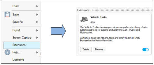

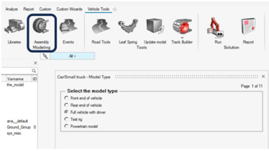

Access the Electric Powertrain for Full Vehicle Models
- The Vehicle Tools extension must be loaded.
- From the menu bar, select .
- Load the Vehicle Tools extension by sliding the Load button to the right.The Vehicle Tools ribbon is add in MotionView.
Figure 12.
- In the Vehicle Tools ribbon, click the Assembly tool to open the Assembly Wizard.
- Select the Full Vehicle with Driver model and click
Next.

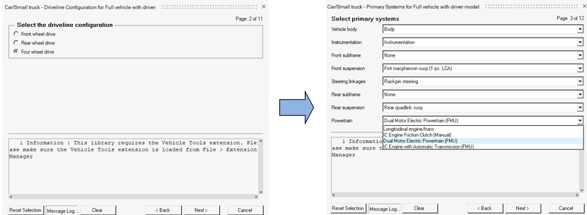

Figure 13. Select Model Type

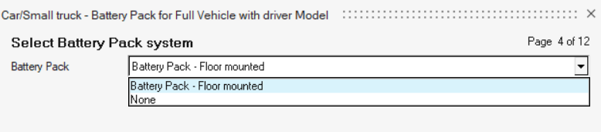

- Choose the Four wheel drive driveline configuration and then
select the Dual Motor Electric Powertrain (FMU), which is listed
in the Powertrain drop-down menu.
Figure 14.
- After selecting the vehicle’s powertrain type, you can also opt for a Battery Pack
body.
Figure 15.

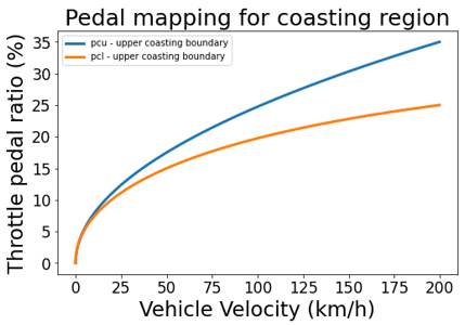

Throttle response within the traction region is influenced by two key parameters: ‘ ’ and ‘ ’. The right setting should offer the correct balance between smoothness and responsiveness. Fine-tuning these settings can result in an improved driving experience by providing the desired balance between these two factors.

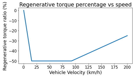

You can also determine the vehicle’s regenerative braking amount by handling the relevant parameters. The equations that determine the regenerative braking amount are derived by 1. Regenerative braking distribution is fixed by default to ’60-40’ front-rear. The traction, coasting and regeneration region for motor mapping are described in detail in 1. Vehicle’s coasting boundaries ‘ ’ and ‘ ’ are defined by the parameters ‘ ’, ‘ ’, ‘ ’ and vehicle’s maximum velocity ‘ ’. Vehicle’s regenerative amount for different speeds is determined by a map used as a Look-up table. ‘ ’ and ‘ ’ are the parameters responsible for the speed – regenerative braking mapping. Finally, ‘ ’ is used to define the correlation between throttle and output torque.
