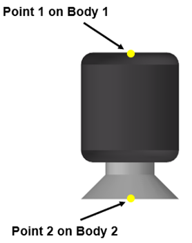

Typically, air springs act between the chassis and an axle. Point 1 on Body 1 defines the top of the air spring, while Point 2 on Body 2 defines the bottom of the air spring.
Figure 1. AirSpring connection points

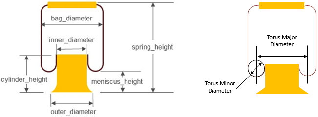

'm' 'newton' 'radians' 'kg' 'sec'Parameters Block
- Torus Major Radius = Inner Diameter/2+(Bag Diameter-Inner Diameter)/4
- Torus Minor Radius = (Bag Diameter-Inner Diameter)/4
$--------------------------------------------------------------Airspring Properties
[PARAMETERS]
inner_diameter = .100
bag_diameter = .200
spring_height = .460
cylinder_height = .250
outer_diameter = .200
meniscus_height = .153

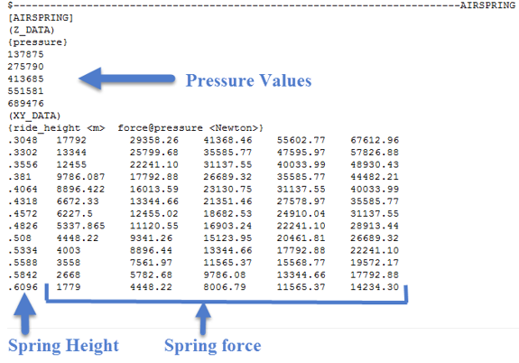

AirSpring Block
- Z_DATA
- XY_DATA
The Z_DATA sub-block gives the nominal internal spring pressure for each force versus deflection curve. The XY_DATA sub-block contains multiple force versus deflection curves.
The first column of the XY_DATA sub-block is spring height and each subsequent column is the spring force for one pressure defined in the Z_DATA sub-block. Therefore the forces in the second column correspond to the first internal pressure (137875 Newton/Meter2), and the forces in the third column correspond to the second internal pressure (275790 Newton/Meter2), and so on.
The spring height provided in the first column should cover the full range of the air spring heights. During a simulation if the spring height outside the range of height provided, MotionSolve linearly extrapolates the spring force with spring height.
Based on the trim load and trim height provided in the user interface, the Newton Raphson method is used to evaluate the equilibrium pressure from the spline data and subsequently, the force-displacement curve corresponding to the equilibrium pressure calculated is used for the simulation.
