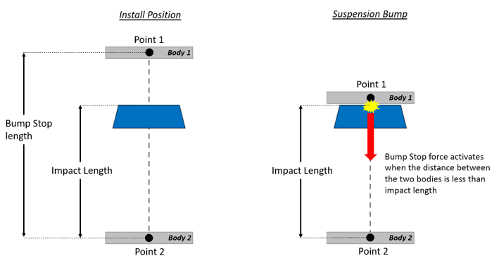

- Impact LengthThe impact length represents the distance between the Bump Stop attachment points when the impact happens.
Figure 1. Impact Length method
When the distance between the Body 1 and Body 2 is less than the impact length, the Bump Stop force acts. When the Impact Length install method is used, its value is directly used to activate the Bump Stop force between the two bodies.

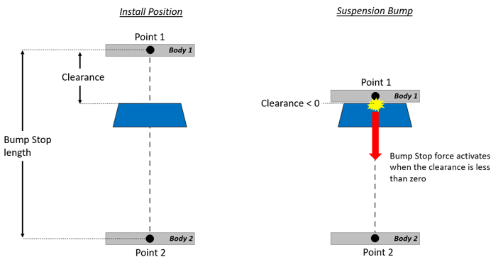

- ClearanceUsing the clearance method, the Bump Stop force is activated when the distance between the Body 1 and Body 2 is less than the Bump Stop Length minus the Clearance value, that is, when the clearance reaches a value lower than zero.
Figure 2. Clearance method
