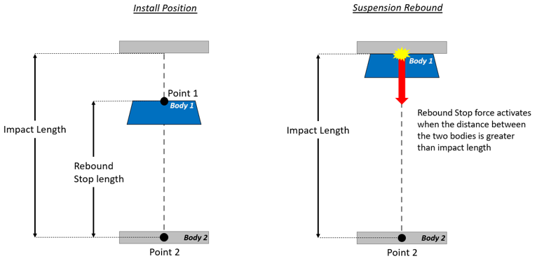

- Impact LengthThe impact length represents the distance between the Rebound Stop attachment points when the impact happens.
Figure 1. Impact Length method
When the distance between the Body 1 and Body 2 is greater than the impact length, the Rebound Stop force acts. When the Impact Length install method is used, its value is directly used to activate the Rebound Stop force between the two bodies.

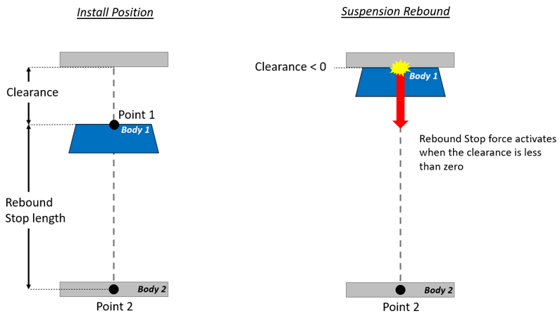

- ClearanceUsing the clearance method, the Rebound Stop force is activated when the distance between the Body 1 and Body 2 is greater than the Rebound Stop Length minus the Clearance value, that is, when the clearance reaches a value lower than zero.
