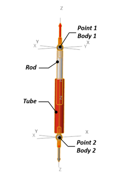

Connecting a Shock Absorber
1. From the guidebar, select the first body to connect.
- Click Body 1 and select a
body from the modeling window.
OR
- Click the Body 1 Advanced Selector and select the required body from the dialog.
- Similarly, select the second body to connect by clicking the Body 2 input collector.
Select a point and enter the location where the Shock Absorber connects to Body
1.
- Click Point on Body 1 and select a point from the
modeling window.
OR
- Click the Point on Body 1 Advanced Selector and select the required point from the dialog.
modeling window.
- Similarly, select the second point by clicking the Point 2 on Body 2 input collector.
Open the Shock Absorber Entity Editor to edit the
parameters.
Figure 1. Shock Absorber connectivity
