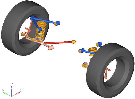

A Short-Long Arm or SLA suspension is included in the vehicle library as both a front and rear suspension. This configuration is also known as a Double Wishbone suspension. This variant of the suspension uses a two-piece lower control arm. The SLA name is derived from the length of the control arms. The lower arm is typically long to provide a good spring lever ratio. The upper arm is typically short to provide the proper camber curve. This suspension is widely used on cars, light trucks, and on independent suspension heavy trucks.

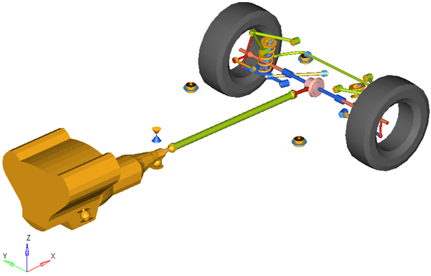

- A wide variety of combinations of suspensions and subsystems can be built using the
Assembly Wizard. You are encouraged to build systems and
understand the resulting model using the graphical user interface.

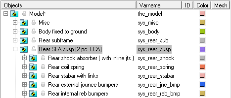

When building a new suspension model, build the model with all of the optional systems (stabilizer bar, etc) included in the model. Immediately turn off the systems using the Project Browser and run an analysis on the base suspension to ensure it solves properly. As data becomes available for the optional systems; activate those systems and populate them with data.

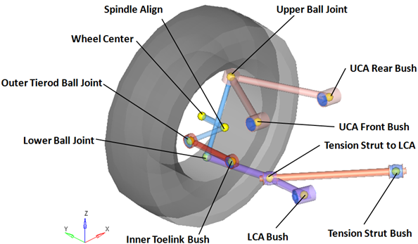

Points

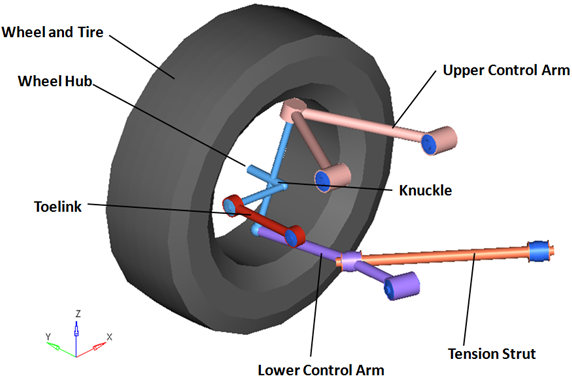

Bodies
- The wheel hub body has no associated graphics and therefore is not visible in the image above.
- Only right side bodies are shown (as the left side bodies are symmetrical), and the coil spring has been omitted from the image above for clarity.

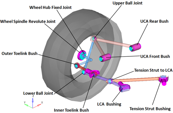

Bushings and Joints
| Label | Type | Body 1 | Body 2 | Point | Notes |
| Lower Ball Joint | Spherical | Knuckle | Lower Control Arm | Lower Ball Joint | |
| Upper Ball Joint | Spherical | Knuckle | Upper Control Arm | Upper Ball Joint | |
| Wheel Spindle | Revolute | Wheel Hub | Knuckle | Wheel Center | |
| Wheel Hub Fix Jt |
Fixed-Joint | Wheel | Wheel Hub | Wheel Center | When Spindle compliance is set to Yes, the joint type changes to universal and a bushing is superimposed to model the wheel bearing compliance. |
| Tension Strut Bushing | Universal | Tension Strut | Subframe, Vehicle Body, or Ground | Tension Strut Bush | When the Compliant option is set to No, this joint compliance is turned "Off" and behaves as a pure universal joint. |
| LCA Bushing | Bushing | Lower Control Arm | Subframe, Vehicle Body or Ground | LCA Rear Bush | When the Compliant option is set to No, this joint compliance is turned "Off" and behaves as a pure universal joint. |
| UCA Front Bush | Bushing | Upper Control Arm | Subframe, Vehicle Body or Ground | UCA Front Bush | When the Compliant option is set to No, this bushing becomes a revolute joint. |
| UCA Rear Bush | Bushing | Upper Control Arm | Subframe, Vehicle Body or Ground | UCA Rear Bush | When the Compliant option is set to No, this bushing is deactivated. |
| Inner Toe Link Bush | Universal Joint | Toe Link | Subframe, Vehicle Body or Ground | Inner Toe Link Bush | When the Compliant option is set to No, this joint compliance is turned "Off" and behaves as a pure universal joint. |
| Outer Toe Link Bush | Spherical Joint | Toe Link | Knuckle | Outer Toe Link Bush | When the Compliant option is set to No, the compliance for this joint is turned "Off" and behaves as a pure spherical joint. |
