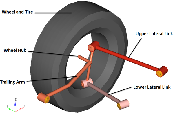

- The wheel body represents the mass and inertia of the tire and the rim.
- The wheel hub body represents the mass and inertia of other rotating bodies such as a brake rotor, but not the half-shafts if the suspension is driven. The wheel hub and brake rotor have no associated graphics.

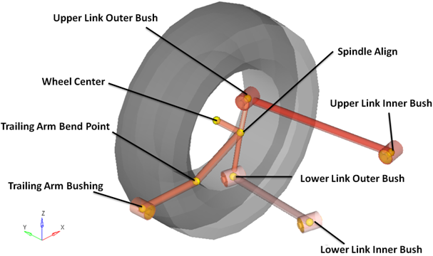

- The wheel and wheel hub parts use the Wheel CG location as the center of gravity.
- Each body’s Center of Gravity (CG) is estimated from the body’s geometry. The formulas are coded into the point panel and can be seen via the graphical user interface. If more accurate CG locations are available they should be used.

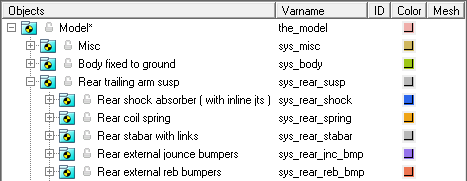

When building a new suspension model, build the model with all of the optional systems (stabilizer bar, etc) included in the model. Immediately turn off the systems using the Project Browser and run an analysis on the base suspension to ensure it solves properly. As data becomes available for the optional systems; activate those systems and populate them with data.

Points
Bodies
- The wheel hub body has no associated graphics and therefore is not visible in the image above.

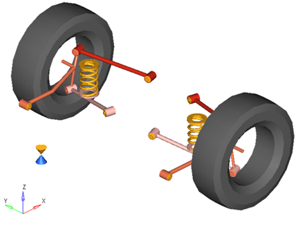

- Only right side bodies are shown (as the left side bodies are symmetrical), and the coil spring has been omitted from the image above for clarity.

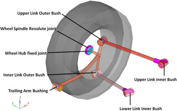

Bushings and Joints
| Label | Type | Body 1 | Body 2 | Point |
| Wheel Spindle Joint | Revolute | Wheel Hub | Trailing Arm | Wheel Center |
| Wheel Hub Fixed Joint | Fixed | Wheel | Wheel Hub | Wheel Center |
| Trailing Arm Bush | Ball | Trailing Arm | Vehicle Body | Trailing Arm Bush |
| Lower Link Outer Bush | Ball | Lower Lateral Link | Trailing Arm | Lower Link Outer Bush |
| Upper Link Outer Bush | Ball | Upper Lateral Link | Trailing Arm | Upper Link Outer Bush |
| Lower Link Inner Bush | Universal | Lower Lateral Link | Ground Body | Lower Link Inner Busy |
| Upper Link Inner Bush | Universal | Upper Lateral Link | Ground Body | Upper Link Inner Bush |
