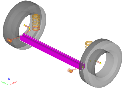

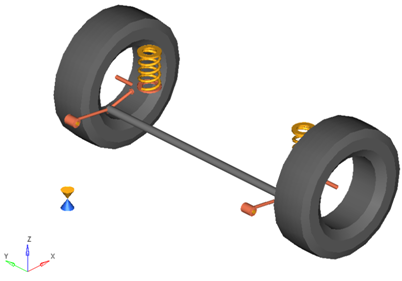

- Beam at the bushing center.
- Beam partway between the bushings and the wheel center.
- Cross beam at the wheel centers.
The figure shown above is a rear wheel twist beam suspension system of the second type. The model can be easily modified to represent all three types of axles.

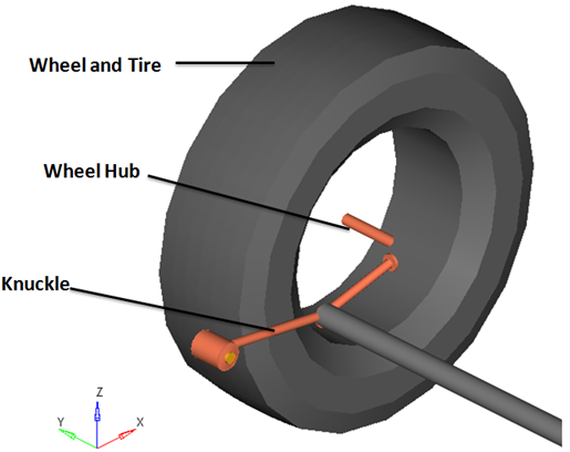

- The wheel body represents the mass and inertia of the tire and the rim.
- The wheel hub body represents the mass and inertia of other rotating bodies such as a brake rotor, but not the half-shafts if the suspension is driven. The wheel hub and brake rotor have no associated graphics.
- The wheel and wheel hub parts use the Wheel CG location as the center of gravity.

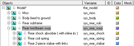

When building a new suspension model, build the model with all of the optional systems (stabilizer bar, etc) included in the model. Immediately turn off the systems using the Project Browser and run an analysis on the base suspension to ensure it solves properly. As data becomes available for the optional systems; activate those systems and populate them with data.

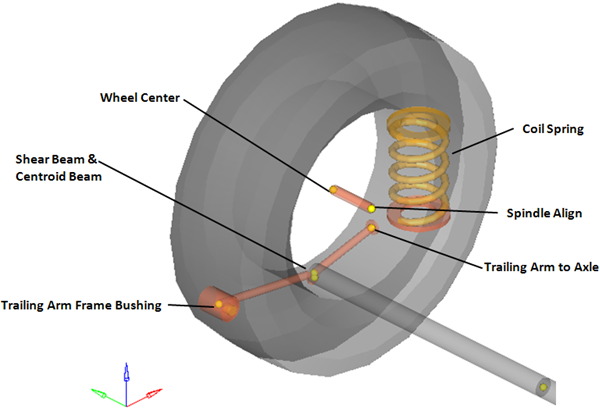

Points
Bodies
- The wheel hub body has no associated graphics and therefore is not visible in the image above.
- Only right side bodies are shown (as the left side bodies are symmetrical), and the coil spring has been omitted from the image above for clarity.

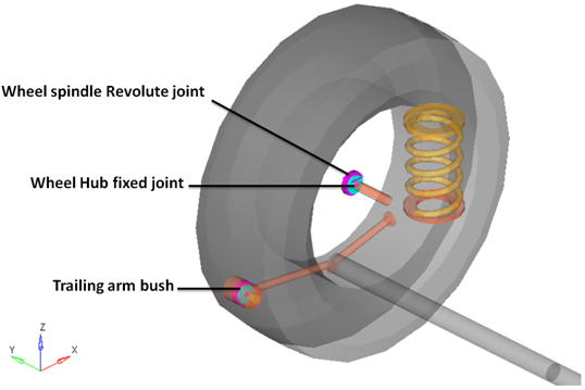

| Wheel Hub Fixed Joint | Fixed | Wheel | Wheel Hub | Wheel Center | When the Spindle compliance option is set to Yes, the joint type changes to universal. |
| Trailing Arm Bush | Revolute | Knuckle | Vehicle Body | Trail Frame |
