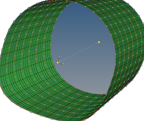

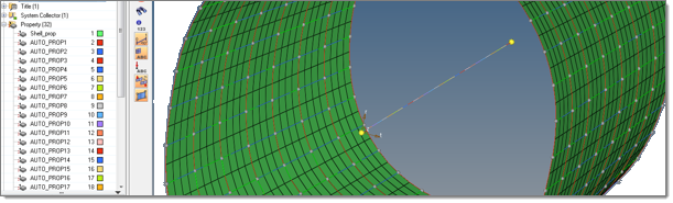

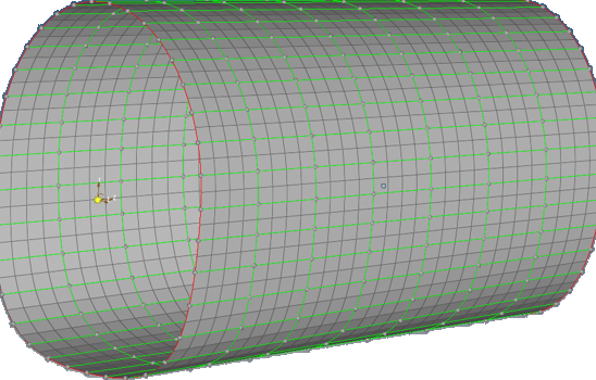

- Select all of the surface edges. This tool works on surface edges without free floating lines. Therefore, you need to mask or delete all of the free lines.

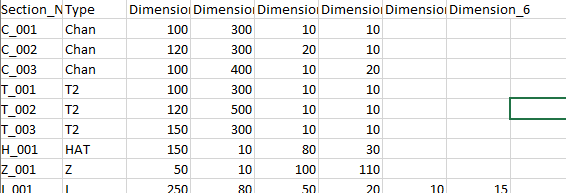

- From the Mesh ribbon, click the arrow next to the 1D Mesh
tool set name and select Beam Sections from
CSV to import the standard beam section from a
.csv file. In this example the CSV format and the
+Y axis of the beam will be aligned with the shell normal.
Figure 2. Standard Beam Section Definitions from a .csv File

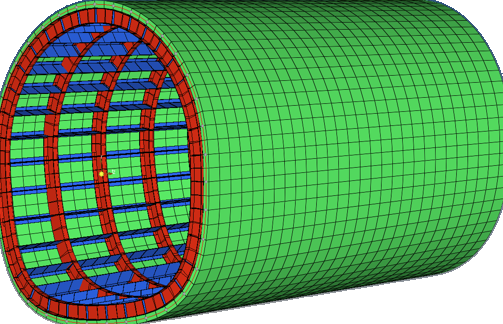

- Select Local as the System Type.
- Assign beam section to each system axis. If the axis does not need a beam, you can make the selection Unspecified.
- Click Create. A beam will be created with the correct
beam section properties and type (CROD, CBAR, CBEAM) along each system
axis.
Figure 3. 1D Elements are Created to Match the Shell Elements and Correct Beam Sections are Assigned

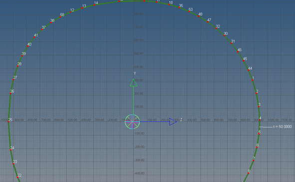

Use this tool to update 1D element properties, change the orientation, or assign offset to existing BEAM elements. The offset and orientation is based on the attached shell element normal and shell element thickness.
Using the Beam Update tool, beam sections can be automatically calculated from 3D solid or FE shell/beam models.
