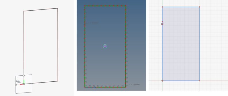

Tip: Orientation tips:- Beam section 2D space is considering (Y,Z) axis, assuming X as inward normal (screen depth). This was done to match with the beam elemental system where the X axis is along Ga → Gb.
- Sketch plane is using (X,Y) plane with outward normal Z.
- The manipulator is also displaying Normal like Z axis.
The recommendation is to always plane normal inward from the selection while selecting the Y axis of the manipulator as the desired vertical axis in beam section space. Hence, proper transformation is done. See Figure 7, which illustrates manipulator selection and the resulting sketch and beam section.
While assigning a sketch (defined in an X,Y plane) to a beam section, there is always a transformation done so the Y axis remains as-is. The sketch X:Z axes are swapped then one axis is flipped to maintain a direct system following right-hand side rule.
Figure 7. Sketch orientation

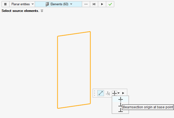

Select a beam section center location from the drop-down in the microdialog.
- Base points
- Aims to use the plane base point as the beam section’s origin.
- Centroid
- Uses calculated centroid as the beam section's origin.
- Shear center
- Uses calculated shear center as the beam section's origin.
If a Sketch is created, this origin option is reflected in beam section dataname Center in the Entity Editor.

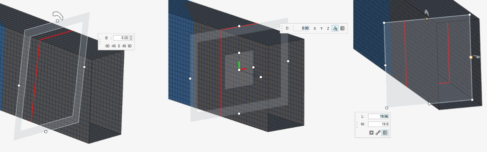

Figure 8. Section cut manipulators
Tip: Orientation tips:The same explanation as for creating beam sections from planar entities is still valid:
The recommendation is to always plane normal inward from the selection while selecting the Y axis of the manipulator as the desired vertical axis in beam section space. See Figure 7, which illustrates manipulator selection and the resulting sketch and beam section.
