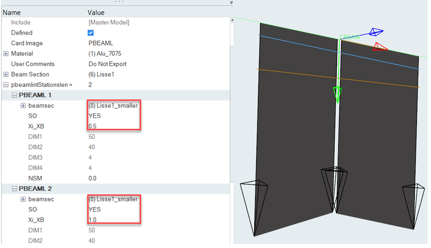

The selected element must have a beamsection entity assigned to its property in order to extract data names to contour or vector plot. If a material is assigned with young modulus or shear modulus available, stiffness terms are calculated. Shear modulus is not recalculated from Poisson's ratio.

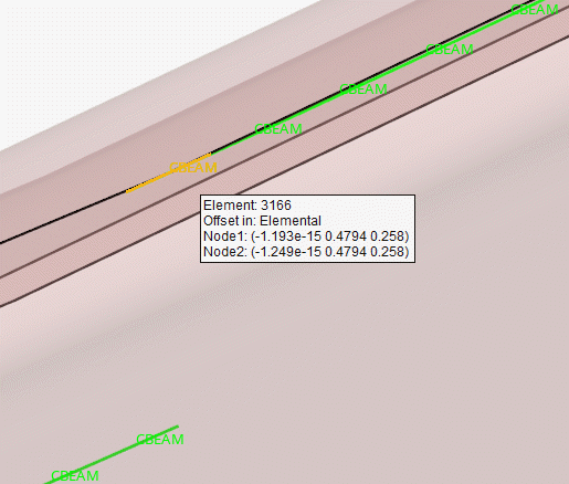

Contour and vector plots enable you to see stiffness drop along a path. Vector plots capture all beamsections assigned to a PBEAM/PBEAML and can plot every intermediate station.Figure 2.
In the image above, the neutral axis line shows discontinuities in neutral axis position. This could be due to element formulation changes (CBAR vs. CBEAM) or inconsistent offset values. The shear center line displays the shear center position after offset. This is useful when you do not know the actual section shape.
If the Review offset checkbox is enabled, you can hover over an element to review its current offset values and whether it's in a displacement system or elemental system.Figure 3.
