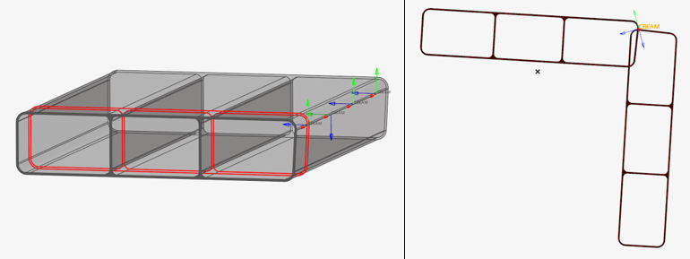

Figure 2. Section Cut: a) Single cut b)Per element c)Per node

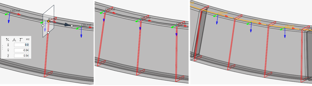

- Single cut
Update a list of elements with a single property extracted from a single user-defined location. Click
to define the cutting plane.
You can adjust the base point and plane normal. Placing the
cutting tool on a target element will adjust the plane’s
normal along the selected element’s X axis.A single preview shows intersections before proceeding. Changing the source updates the preview.

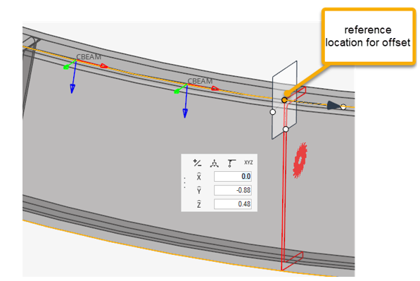

The reference point (see Orientation and Offset) is the intersection of the cutting plane with a target element. This defines the reference orientation and offset.
If you perform a section cut using a plane which does not intersect any of the target elements (Figure 3), then the reference point is extracted from the plane's base point.
You need to pay attention to the local normal and relative position of the manipulator in the section cut to obtain accurate result to assign to its target selection. Target elements must have consistent orientation.

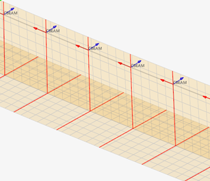

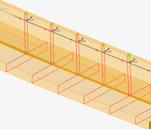

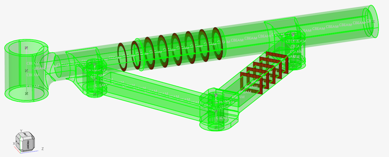

- Cut per element
- Automatically perform a section cut on each target element. As
explained in Orientation and Offset, the resultant section is valid per element no matter its
orientation. The intersection is done by default on the midpoint
of the target element. You can set a value (0 to 1) to specify
the parametric position between the target element’s nodes
(Figure 4). The orientation can’t be changed. The
plane is normal to the target’s X axis.

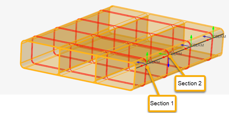

Since a cut is performed per element, all meshing processes and calculations are done as many times as target elements selected. This is obviously more time consuming than a single cut. Whenever a region of multiple targets share the same section, it is advisable to use the Single Cut method to reduce computation time.
However, it is possible to consolidate and reduce the number of beam sections created if they fall within the same range of values. Associated properties can also be consolidated. These options are accessed from the guide bar menu (
). - Cut per node
- A cut is performed on each node of the target elements. If adjacent elements form a vertex angle between their X axis below the threshold angle tolerance, a single cut is done for common nodes; otherwise, one cut per element is performed at the same node using different normal. No additional test is done on (Y,Z) axis deviation from adjacent elements. Properties will be created with two beam sections: one at each end station. If a single cut is done on a node, the two adjacent properties share the same beam section for their relative station.

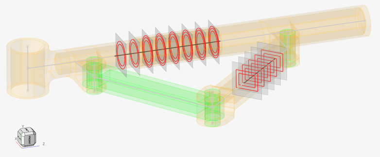

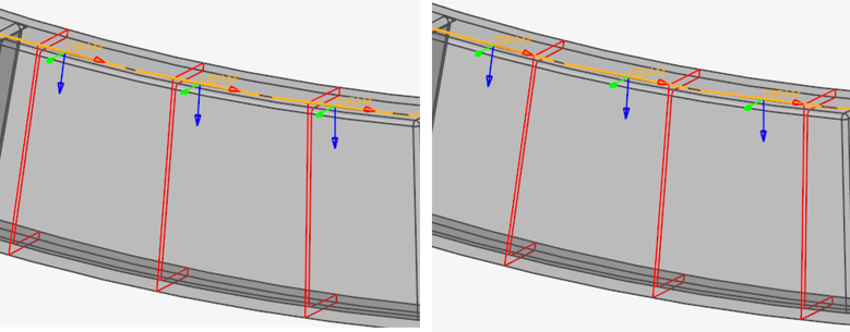

Click
in the microdialog to
toggle between a finite and infinite plane.
In some situations, it is best to consider a finite plane to intersect sources. In the Figure 5, using the (default) infinite planes would result in undesired regions considered during trimming. In such cases, you can switch to a finite plane and define the width and height of the section cut. However, it is not possible to define the size location per location. The width and height will be common for all intersections.
Figure 5. Finite size planes

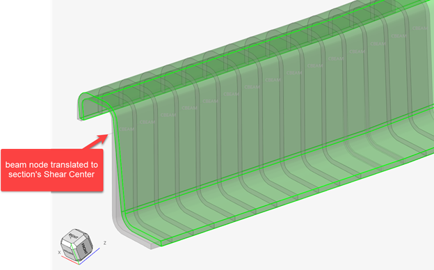

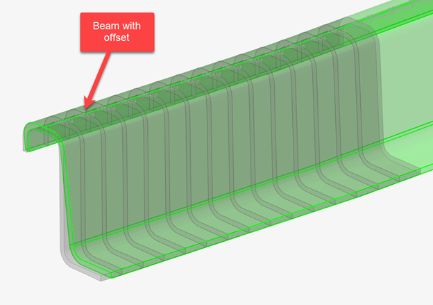

Use the second icon menu in the microdialog to choose
between offsetting or translating the beams.
Translating will actually translate beam nodes to match the source and can be done to the shear center or the centroid.
Figure 6. Beam offset
Figure 7. Beam translate

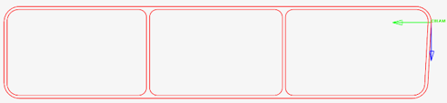

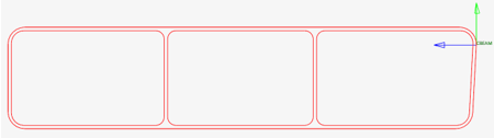

The elemental system of target 1D elements remain unchanged during the update process.
When a cross section is performed on a 1D element, its local X axis is taken as the section plane’s normal. The beam section local 2D system (Y, Z) matches with the elemental axis (Y, Z). Sectional properties are hence valid in elemental system as defined. If orientation needs to be adjusted, it is advisable to update the element orientation first (see Orient Bar2 or Bar3 Elements).
Since a cut is performed per element in Figure 13, each section has its own local system matching the elemental system, as shown in Figure 14 & Figure 15. The origin of the system, from which Centroid and Shear Center coordinates are saved in the beam section entity, is taken at the center of the bounding of the section in the local system.
After proceeding, a 3D detailed visualization of updated beams shows the resulting beam cross section taking into account orientation and offset.
