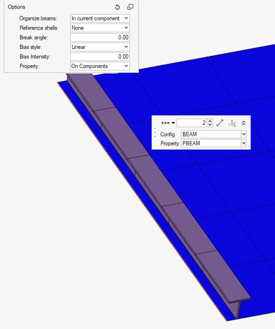

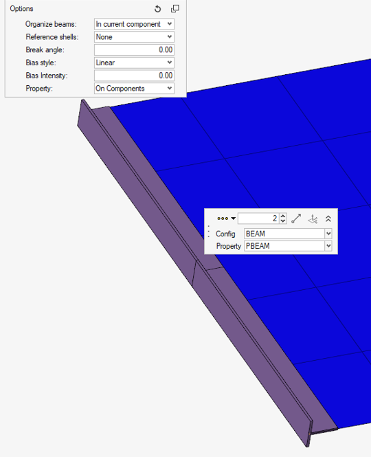

For edges and nodes, mesh is honored if the reference shells option is set to displayed or all. If it is set to none, mesh density is honored even if there is shell mesh.Figure 2. Seed, Orient, and Offset Beams from Displayed
Figure 3. Seed Based on Size, Orientation from Line
