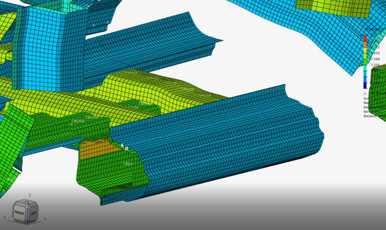

Convert Beams to Equivalent 2D Shell Mesh or 3D Solids
Use the Inflate tool to create 2D shell mesh or 3D solids from 1D beams.
- Surfaces
- Shell Mesh
- Solids
It also supports options to create surfaces/mesh congruent with beam nodes.

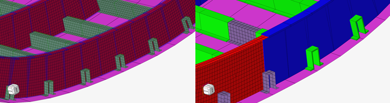

Surface Continuity
- Path vertex angle
- Threshold vertex angle between adjacent beams under which surfaces are interpolated.
- Orientation tolerance
- Threshold angle between local Y axis of adjacent beams under which surfaces are interpolated.
- Shell parts
- How to generate surfaces from shell beamsection parts (see further explanation).

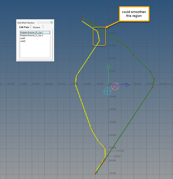

Further Explanation of Shell Beamsections
Shell beamsections are a collection of parts with a name. Parts with the name weld* are ignored.
Parts are a collection of ordered vertices. Lines are first generated by parts either as straight segments or smooth lines and used to create surfaces from station to station.
- Whether straight segments are created from points
- If a smooth line is generated while keeping straight regions if more than two points were originally aligned.
