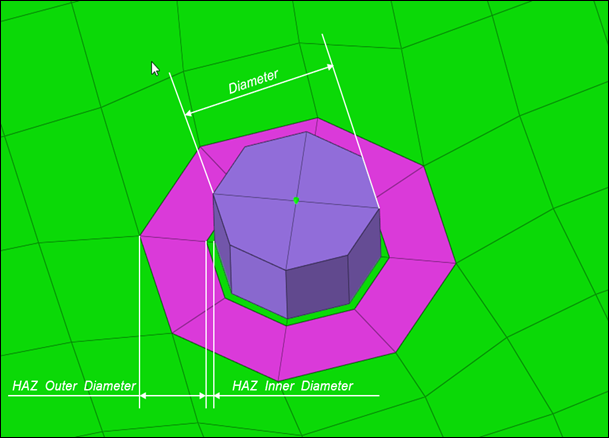

| Diameter Option | Choose how the diameter is defined. This field is used for
realizations based on hexa elements, where the size of the
realized element (hexa) is created based on the diameter value.

| HAZ Dimension Scheme | Choose a setting for defining HAZ diameters. |
| HAZ Inner Diameter |
| HAZ Outer Diameter |
| HAZ Layer 2 | Enables you to specify the HAZ Outer Diameter 2. By default, this checkbox is cleared and the HAZ Outer Diameter 2 cannot be defined. |
| HAZ Outer Diameter 2 |
