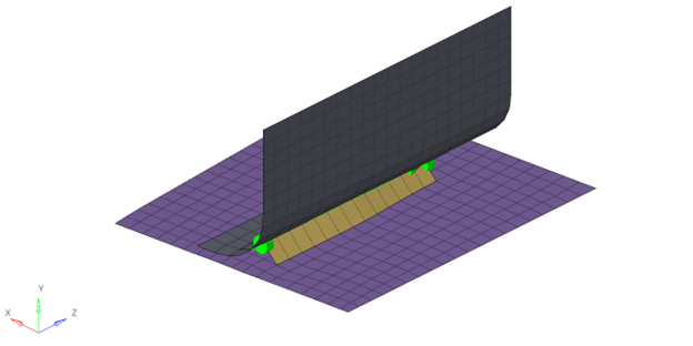

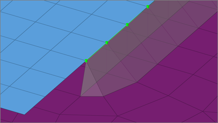

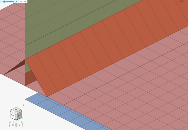

Seam Quad
This realization realizes t-welds, lap-welds, laser-welds, and butt-welds.
This weld type is identified automatically based on the orientation of the links to each other.

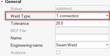

- Weld Type
- Defines weather to setup a configuration exclusively for a T, L, or B connection, or automatically setup a configuration for each connection based on the angle.

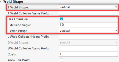

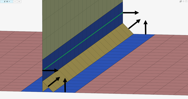

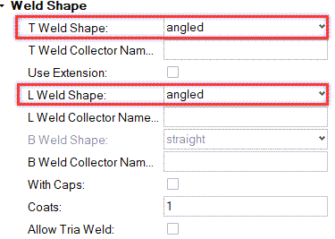

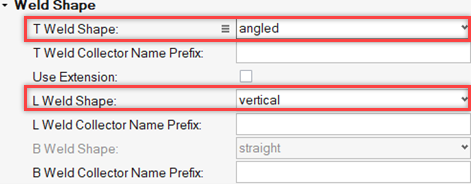

Weld Shape

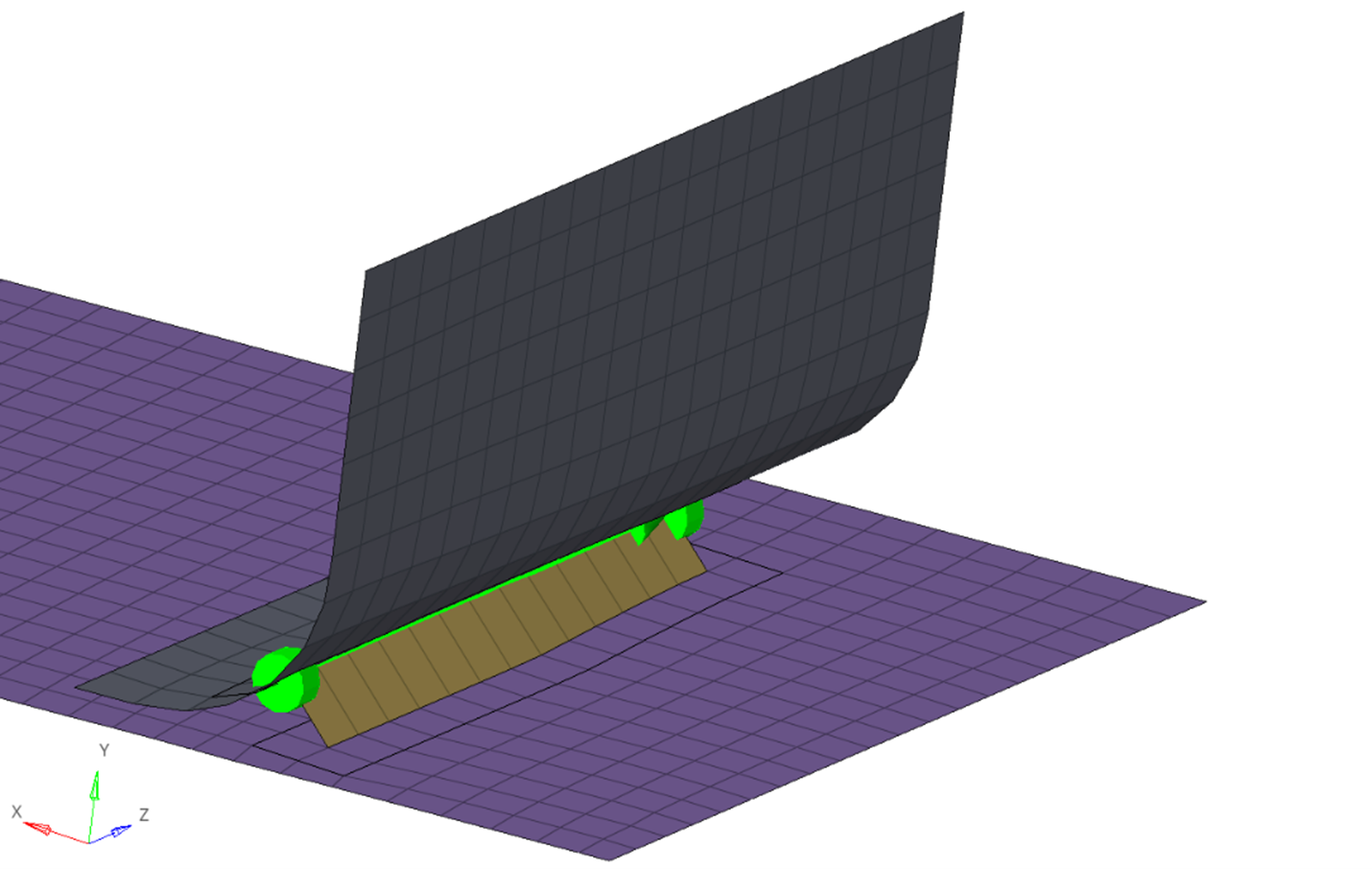

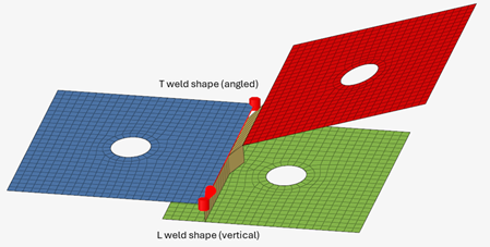

- T Weld Shape
- Defines how the T weld is created.

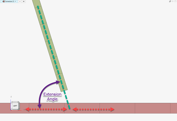

- Use Extension
- Interpolate an extension of the T joint and calculate the weld dimensions from this location.
- Extension Angle
- If the Links are at an angle greater than the “Extension Angle” then the “Use Extension” operation is used.
- L Weld Shape
- Defines how the L weld is created.
- B Weld Shape
- B welds are always created straight.

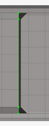

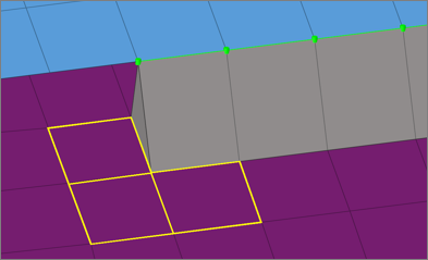

- With Caps
- When enabled, seams are closed with a tria element.
- Coat
- The number of elements in the weld.

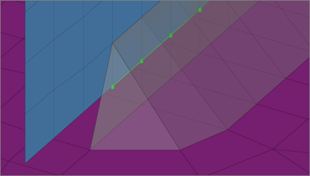

- Allow Tria Weld
- This option allows the realization to use Trias in the weld and HAZ. This can improve element quality on connectors with a very tight radius.

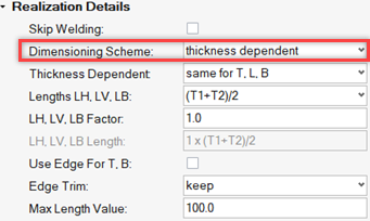

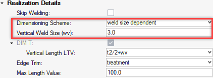

Realization Details

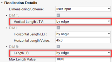

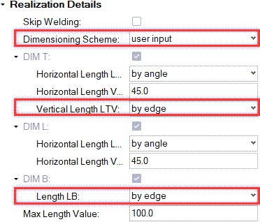

- Dimensioning Scheme
- Defines the dimensioning scheme for the dimensions of the T weld, L
weld, and B weld connections.

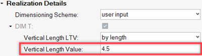

- user input
- Manually define discrete values for the weld dimensions, shown in black in Figure 16, Figure 17, and Figure 18. The horizontal dimensions can be defined using a length or an angle.
- thickness dependent
- Choose a formula to define the weld dimensions, shown in black in Figure 16, Figure 17, and Figure 18. The provided formulas are all dependent on the thicknesses t1 and t2. A formula can be chosen individually for each verticalV and horizontalH distance, or the same formula can be used for T, L and B.
- weldsize dependent
- Manually define discrete values for the weld dimensions, shown in red in the Figure 16, Figure 17, and Figure 18. The verticalV and horizontalH distances are defined with formulas reflecting the weld sizes and the t1 and t2 thicknesses.
- DIM T (Dimensioning T)
Input Thickness dependent Weldsize dependent Horizontal Lengths LTH - by angle
- by length
- Pitch Size
- T1
- T2
- (T1+T2)
- (T1+T2)/2
- T Minimum
- T Maximum
- Lh, LB, LV Factor*
t1/2+wh/2 Vertical Length LTV - by length
- by edge
- By Edge
- Pitch Size
- T1
- T2
- (T1+T2)
- (T1+T2)/2
- T Minimum
- T Maximum
- By edge + 0.4*T1
- t2/2+wv/2
- by edge

Input Thickness dependent Weldsize dependent Lengths LB - by length
- by angle
- Pitch Size
- T1
- T2
- (T1+T2)
- (T1+T2)/2
- T Minimum
- T Maximum
- wb
- by edges

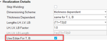

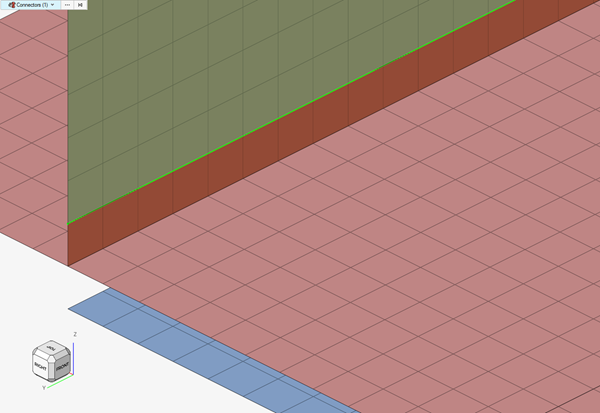

- Use Edge to T, B
- If the weld is classified as a T or a B weld, the weld is created from the edge. You do not need to put any values in for Vertical Length for T welds and Width for B welds.

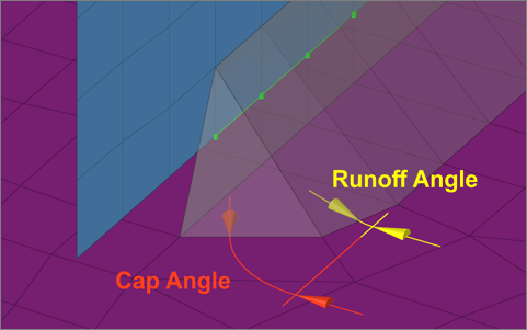

- Caps
- Determines how caps are created.
Figure 19. Cap Angle and Runoff Angle
Figure 20. Sharp Corner Enabled
Figure 21. Sharp Corner Disabled

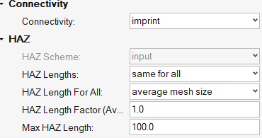

Connectivity Info
The following options give you the ability to change how the realization connects to the mesh.

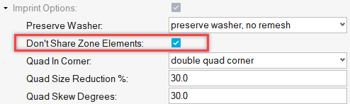

- imprint (default)
- Creates quad weld elements and stitches them to both links by adjusting their mesh. The HAZ is created in this option.
- skip imprint
- Creates quad weld elements but does not change the meshes of the links. Instead, additional elements are created to represent the requested HAZ. These elements are organized in the ^conn_imprint component and can later be used for a manual imprint after they have been manipulated to your needs. This option is helpful when working with more complex areas, where the standard imprint functionality fails, for example, conflicting connectors.
- imprint/no HAZ
- Creates quad weld elements and stitches them to both links by adjusting their mesh. Mesh modifications are as minimal as possible and no HAZ are performed.
- none
- Creates quad weld elements only. Quad weld elements will not be attached to the links. The connection will need further attention.

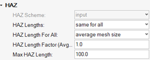

HAZ Info
The HAZ Info settings define the lengths of the different heat affected zones (HAZ), which are dependent on the HAZ lengths for T, L and B (defined in Realization Details). The HAZ length settings vary depending on the defined weld shapes (vertical, angled, vertical and angled, caps).
- First try to realize with user-specified HAZ lengths.
- If step 1 fails, realize with reduced HAZ lengths/reduced HAZ’s elements length at certain position on connectors.
- If step 2 also fails, realize with no HAZ’s.
- HAZ Scheme
- Choose a dimensioning scheme for the HAZ lengths of T, L, and B.
- input
- Enables you to decide if the HAZ lengths should be defined individually, or if all HAZ lengths are determined using the same approach (same as all).
- Only available if weldsize dependent has been chosen for the Dimensioning Scheme as well.
- HAZ Lengths
- same as all
- Assigns the same length to all HAZ lengths.
- individual
- Assign HAZ lengths individually.
- HAZ Lengths (various)
- The following options are available in the various
HAZ length settings.
- input
- Requires a discrete value be specified for the length.
- average meshsize
- Length is dependent on the average mesh size in the local area where the imprint is performed.
- by thickness
- Sets the length to the same value as the thickness of the link getting the HAZ.
- LTH
- Horizontal length for T connections, which is the length between the foot points of the vertical and angled part of a seam.
- LLH
- Horizontal length for L connections, which is the length between the foot points of the vertical and angled part of a seam.
- LB
- Butt weld length.
- skip HAZ
- Skips individual HAZ that are not required.
- same as positive side
- Assigns the same length as the positive side to the negative side.
- wh or wh/2
- Length is dependent on the horizontal weld size. Only available when HAZ Scheme is set to weldsize dependent.
- wv or wv/2
- Length is dependent on the vertical weld size. Only available when HAZ Scheme is set to weldsize dependent.
- wb or wb/2
- Length is dependent on the butt weld size. Only available when HAZ Scheme is set to weldsize dependent.
- LTVedge
Choose between skip HAZ and LTVedge. Only available for the HAZTvedge length.
- HAZ Length Factor (Avg. Meshsize/Thickness)
- Factor that increases or decreases the HAZ lengths, which have been defined using the average meshsize or by thickness length options.
- Max HAZ Length
- Maximum length for all HAZ lengths. If the HAZ length is greater than this value, then the Max HAZ Length is used.

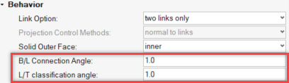

Behavior

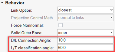

- B/L classification angle
- Angle that is automatically determined for each individual seam connector, whether it is to be considered a butt weld or a lap weld. Default is set to 10.0°.
- L/T classification angle
- Angle that is automatically determined for each individual seam connector, whether it is to be considered a lap weld or a t-weld. Default is set to 10.0°.

- Do Not Share Zone Elements
- Seam imprint allows heat affected zones (HAZ) to be merged in close areas. In this situation, one element might touch the weld elements from two different connectors. Do not share zone elements prevents zone elements from being shared.
- Quad In Corner
- Controls whether a single or double element is created in corners of quad seam connectors with a certain vertex.
- Quad Control
- Controls the maximum deviation from the perfect quad element for the heat affected zone (HAZ). It can be controlled, if the element size or the element skew is more important to retain.
- Max Quadsize Reduction In % / Max Quad Skew In Degrees
Figure 46. Max Quad Size Reduction: 80.0 / Max Quad Skew: 5.0
Figure 47. Max Quad Size Reduction: 5.0 / Max Quad Skew: 45.0

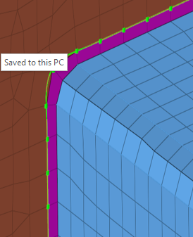

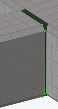

Profile Welding Use Case
For models that have profile sections that need to be welded, there is often a requirement for vertical/straight seams.
By using Seam Quad connectors, this can be achieved. Below is an explanation of the options that need to be defined to achieve this, as well as some tips and example cases.
Define the Control
For the shape of the weld, only vertical shapes for both T and L type connections needs to be defined.
Use Extension is selected. A low value is defined for this option (in most cases a value of 1 is sufficient). This will ensure that the projection is kept straight.
It is also recommended that Use Edge for T, B is selected. If precise dimensions for the welds is not needed, then this option should be selected.
Since Use Extension is selected, the B/L and L/T Classification angle must also be changed. These values should be the same value as the Extension Angle value. By doing this, it is ensured that the connections will be treated as T-type and straight quads will be projected.
All other options can be left to the default values or changed according to specific needs.

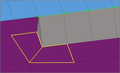

Imprinting Significant Nodes
Before realizing the connector, you should also imprint any corner nodes that do not appear as significant points. When imprinting these corner nodes on the connector, they act as significant points. Therefore, they ensure that during the projection, the corners will be retained, and the projection will be kept straight.

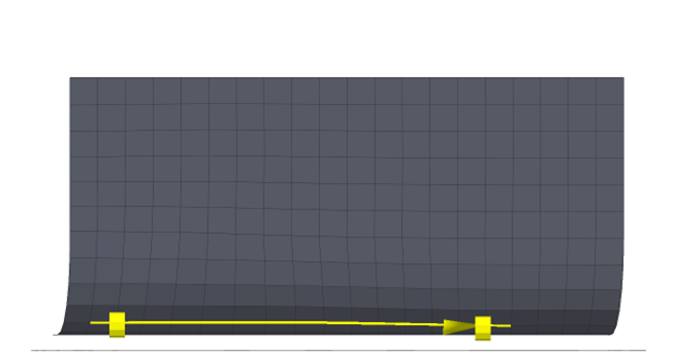

Examples

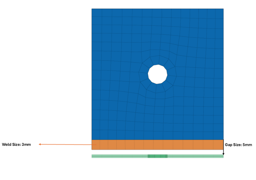

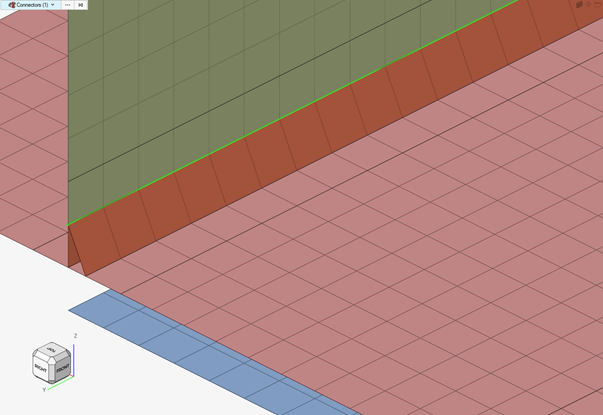

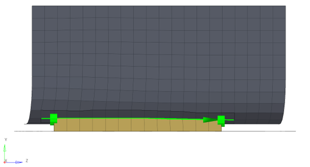

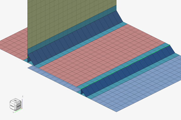

Fillet Weld Use Case
Explore welded connections between a fillet and plane using Seam-Quad connectors.
Define the Control
The required dimensions for the welds must be defined. For applications that require specific dimensions, you can set them directly by selecting user input for Dimensioning Scheme. To avoid errors, it is recommended that the by edge option is used to define the vertical length for T and B type connections.
Define the connectivity and HAZ options. If the HAZ zone is not necessary, it is recommended to use the Imprint/no HAZ option for Connectivity to avoid imprinting errors. In cases where the HAZ zone is critical, the dimensions can be tailored to specific needs.

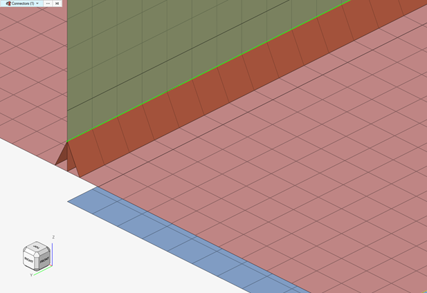

Create the Connector
Examples

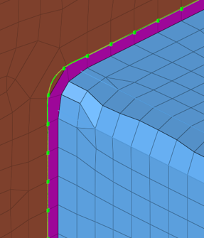

Quad transition errors occur during the imprinting process when realizing the connector. There are a number of these errors, and they can be triggered by various factors. Due to this, it is difficult to document them similarly to the Seam Quad specific errors above.
- In most cases, errors are due to poor quality mesh. Ensuring the underlying mesh, for all links, has good quality is crucial when realizing Seam Quad connectors. You can conduct a Rebuild operation before realizing the connectors.
- When unnecessary, it is recommended to not use HAZ zones when realizing the connector. During Imprinting, the HAZ region must be imprinted on the links. In some cases, there is not enough space for the HAZ region to properly imprint. Changing this option often results in a successful realization.
- Features that are in the imprinting area of the connector create problems during imprinting. You can adjust the weld size as well as the location of the connector to work around such features.
