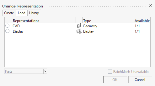

Different methods for modeling a part are called representations.
Each representation has a name and type assigned. The representation types that can be automatically created through BatchMesher are: Geometry, Midsurface, Display, CFD 2D Mesh, Hexa Bounding Box, Hexa Thin Solid, Midmesh, Rigid Body Mesh, Shell and Tetra.

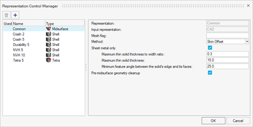

Common Representation
A common representation consists of midsurfaced geometry. It is derived from the CAD representation and forms a single, common input for creating any subsequent discipline-specific shell mesh representations. This common input enables one-time creation and clean-up steps for all future shell representations.
During creation, the CAD is sent to the BatchMesher for midsurface extraction. Upon completion the CAD is saved to the repository and you can opt to immediately load the representation into the session.
Alternatively, you can send solid parts to the BatchMesher. If thin-solid detection is enabled in the Common representation control (see Define Representation Controls), solids are detected and saved as the Common representation without processing. By default, the midsurface algorithm "skin" is used. CAD representation does not need to be loaded into the session to generate the Common representation, since it is sent directly to the BatchMesher for processing.
When you create a Shell representation, the Common representation residing in the repository is automatically sent to the BatchMesher for processing. The Common representation does not need to be loaded in the session to generate Shell representations. In case it does not exist, it is automatically generated by extracting the midsurface from the CAD representation.

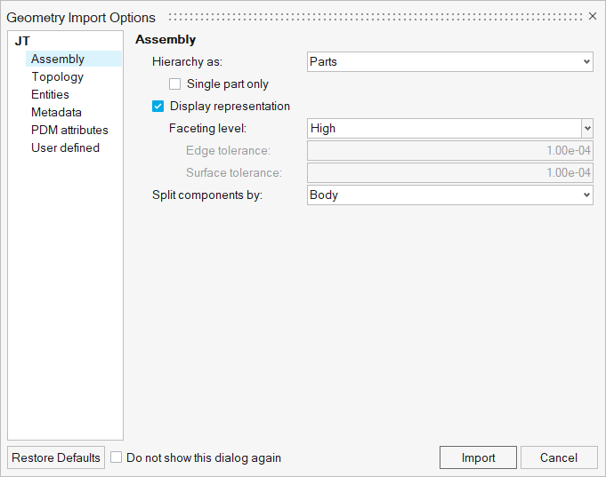

The main purpose of this tool is to provide a lightweight version of imported geometry that allows fast loading of large assemblies, leading to significant time savings. This is a convenient way to perform initial inspections of the model. You can select the Display representation option when importing Geometry files (Figure 4) and after importing a BOM file (Figure 5).
Supported geometry file formats are: Acis, Catia, CatiaV6, Creo, Inspire, Inventor, JT, Rhino, NX native, NX third party, Parasolid, SLDPRT/SLDASM, STEP, VDAFS.
Respective import options can be accessed from the Part Browser using the context menu .
- Choose Low to set the faceting level to the lowest level.
- Choose Medium to set faceting level to its normal (default option).
- Choose High to set the faceting level to its maximum.
- Choose Custom to set the edge and surface tolerance manually (default: 1e-04).
