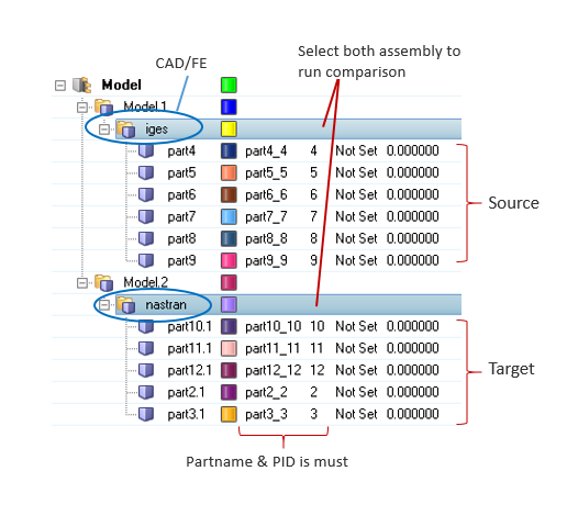

You can select parts directly either from the modeling window or from the Comparison Browser. You must select parts for both the base and the variant. Internally, a quick comparison is executed and results are displayed in the modeling window in addition to the reports.

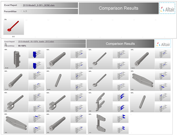

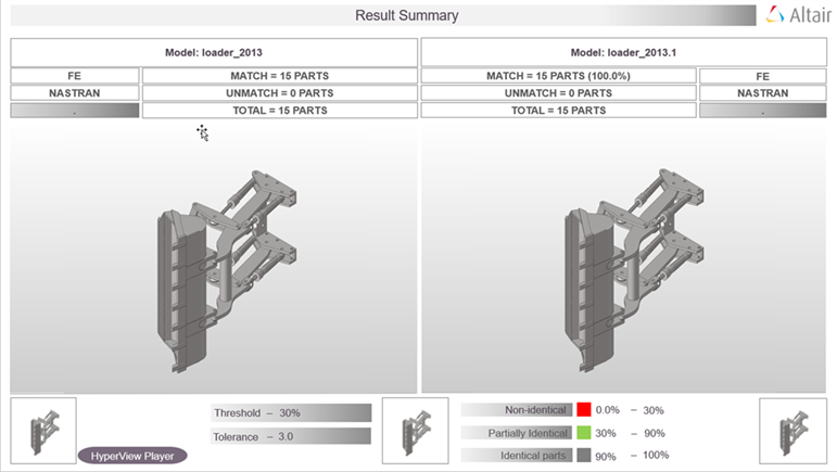

Click View Report to display the Summary PowerPoint
report.
Figure 3. PowerPoint Summary . (Stored in Report Path)
The slide shows the comparison between a source assembly and the target assembly. The left half of the image shows the source assembly and the right half of the image shows the target assembly. In the example illustrated above, the source assembly has a total of 39 parts. The target assembly has a total of 38 parts. The matching parts, between the source and target assemblies, are highlighted in black and the unmatched parts are shown in red.
The second slide shows the matched and unmatched results for individual parts. The number of parts are limited to 40 which matches the Excel report. This limitation can be edited in the configuration.
Figure 4. Matched and Unmatched Results. (from 2nd slide of Summary PowerPoint Report)

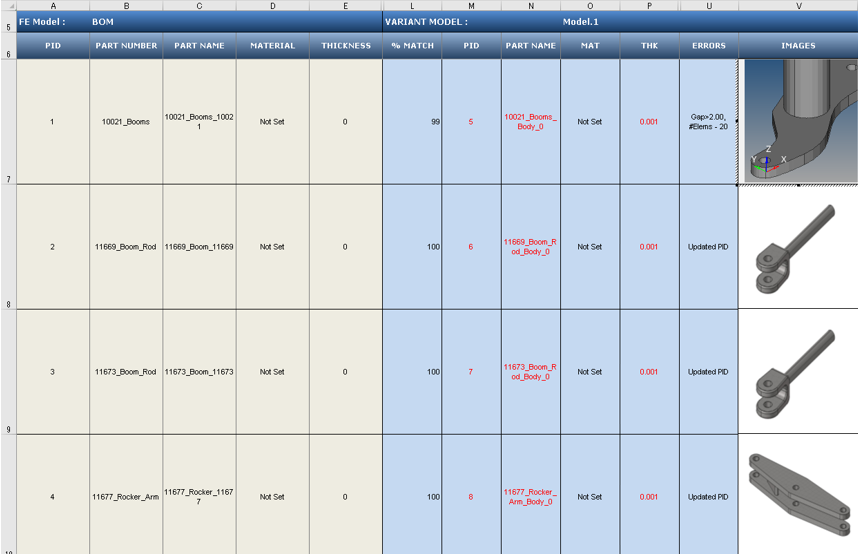

Excel
- Base Model Input
- Input information about each of the parts of the CAD model that the tool uses for performing the a comparison check. The Base Model Input is the first assembly shown in the Part Browser, and can be cross checked at row 5.
- Variant Model Input
- Results of the comparison check. The match percentage column shows a part vise match percentage. If the value of match percentage for a part is 0 or less than the threshold percentage, then the part is said to be unmatched with the corresponding part of the other assembly. If the match percentage is above the threshold value, then the parts are considered matching. The error is reported in the error column. Variant model’s Material name or Thickness values are compared against Base model, mismatch values are shown in red text. Variant Model Input increases depending on the number of Variant model found in the Variant Input folder. Variant model name can be cross checked at row 5.
- Image Type
- Shortcut to the image the part.
- If the image type is JPG, then this shortcut opens the full sized image for viewing.
- If the image type is H3D, then the shortcut opens in the part in H3D format in a new HyperMesh window.
Comparison with Browser Selection
Compare CAD vs. CAD models, FE vs. FE models, and CAD vs. FE models with a Comparison check.

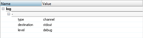

- Turn on the debug log in the Configuration panel by selecting .
Select .
Figure 7.
- Restart HyperMesh.
- Run the check again.

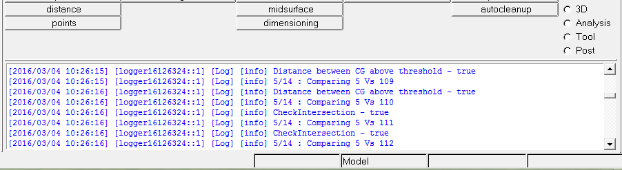

Check the Tk Console of the stdout files.
Figure 8.
Based on the information in the .log file, identify the filters applied on the concern
parts/PID.
Example: 5 vs 109 comparison is ignored due to the centroid distance between these parts are more then value set in the config “cgtolerable-distance” value. In case these two parts need to be compared, increase the “cgtolerable-distance” from 200 to desired value.
