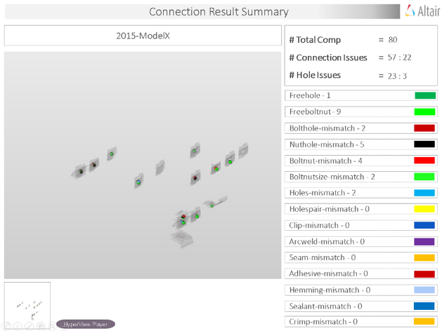

Click View Report to display the Summary PowerPoint
report.
Figure 2. PowerPoint Summary . (Stored in Report Path)

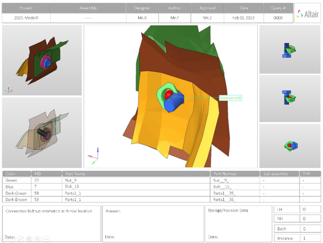

Figure 3. PowerPoint Detailed Report. (Stored in Report Path)
Output
Overview of the PowerPoint report generated from the Connection check.
A PowerPoint report is separated into several sections.
- Report Header
- Project name, assembly name and slide number.
- Full Assembly Picture
- Image of the components that have connection issues.
- H3D Image
- Section can be viewed in the HyperView Player, and shows an H3D image shows the FE model with the connections marked with Cross Hairs.
- Issue Details
- Details of components which have connection issues.
- User Review Section
- Used to add additional information when exchanging information with designers/engineers.
- Additional Info
- Occurrences of the issue shown in the current slide. The number of instances show the number of occurrences of the issue.

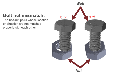

- Bolt-Nut Mismatch
- Detects the bolt nut pairs whole location or alignment direction do not
match properly.
Figure 7.

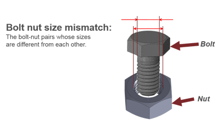

- Bolt-Nut Size Mismatch
- Detects the bolt nut pairs whose sizes are different from each other.
Note: The diameters of bolt, nut and clip are found through a CSV file.
Figure 8.

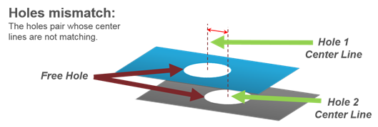

- Holes Mismatch
- Detects pairs of holes whose center axes do not match.
Figure 9.
