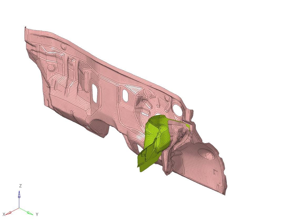

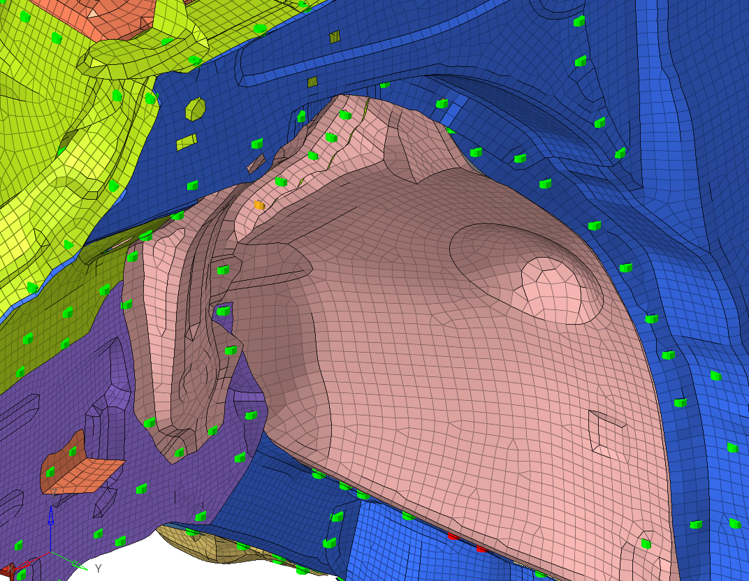

Figure 5. Consider Geometry: Off
Figure 6. Consider Geometry: On
