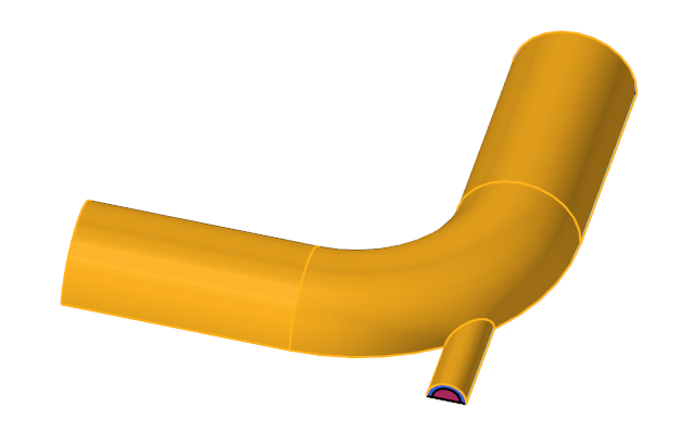

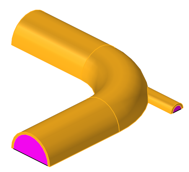

The problem to be addressed in this tutorial is shown schematically in Figure 1. It consists of a mixing elbow made of stainless steel with water entering through two inlets with different velocities and at different temperatures. The geometry is symmetric about the XY midplane of the pipe, as shown in the figure.
Figure 1. Schematic of Mixing Elbow with Stainless-steel Walls

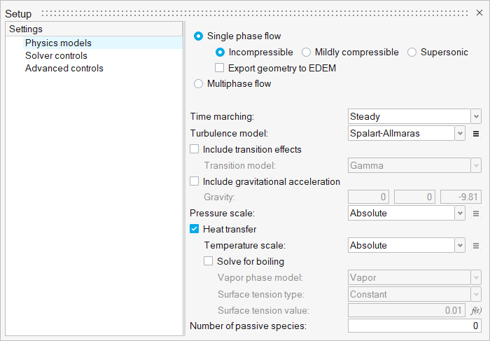

  2. Under the Physics models setting:
    1. Verify that Time marching is set to Steady.
    2. Select Spalart-Allmaras as the Turbulence model.
      The robustness and accuracy of the Spalart Allmaras turbulence model makes it an excellent choice for simulation of steady state flows.
    3. Activate the Heat transfer checkbox.
    Figure 5.

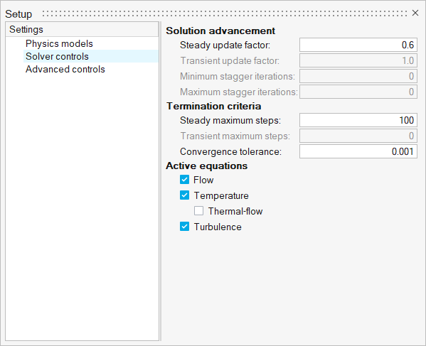

  3. Click the Solver controls setting and verify that the parameters are set as shown in the figure below.
    Figure 6.

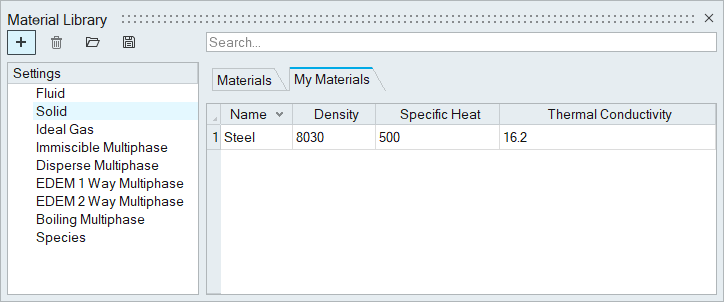

  2. Under Settings, click Solid.
  3. Click the My Materials tab and then click to create a new solid.
    A material creation dialog opens.
  4. Rename the material.
    1. In the top-left of the dialog, click Solid to edit the name.
    2. Type Steel and press Enter.
  5. Change the Density value to 8030.
    Figure 8.
  6. Click the Specific Heat tab.
  7. Change the Specific heat value to 500.
    Figure 9.
  8. Click the Conductivity tab.
  9. Change the Conductivity value to 16.2.
    Figure 10.

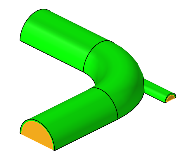

  2. Select the outer pipe solid.
    Figure 13.

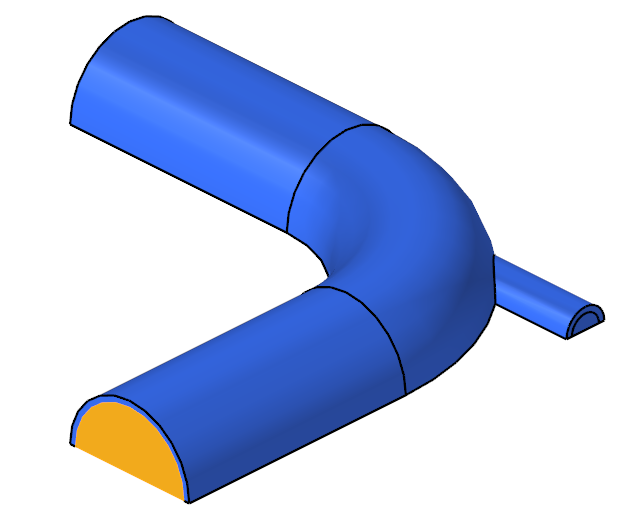

    Figure 15.
  2. Click the face of the large inlet.
    Figure 16.

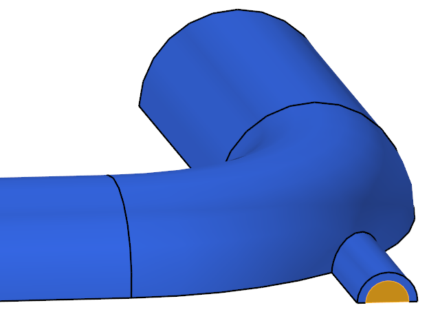

  1. Click the face of the small inlet.
    Figure 17.
  2. In the microdialog, enter a value of 1.2 for Average velocity and 320 for Temperature.

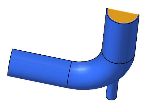

  2. Click the face of the outlet.
    Figure 19.

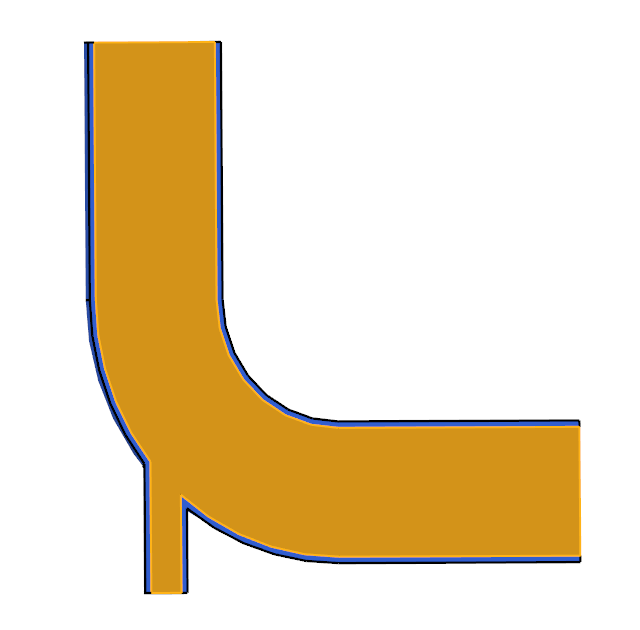

Set Boundary Conditions for the Symmetry Planes
This geometry is symmetric about the XY midplane, and can therefore be modeled with half of the geometry. In order to take advantage of this, the midplane needs to be identified as a symmetry plane. The symmetry boundary condition enforces constraints such that the flow field from one side of the plane is a mirror image of that on the other side.
  1. From the Flow ribbon, click the Symmetry tool.
    Figure 21.
  2. Click the face of the symmetry plane.
    Figure 22.
  3. In the microdialog, accept the default symmetry conditions.
    Figure 23.
  4. On the guide bar, click to execute the command and remain in the tool.

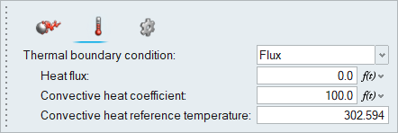

  3. In the microdialog, click to open the temperature tab.
  4. Change the Convective heat coefficient value to 100.
  5. Change the Convective heat resistance temperature value to 302.594.
    Figure 27.

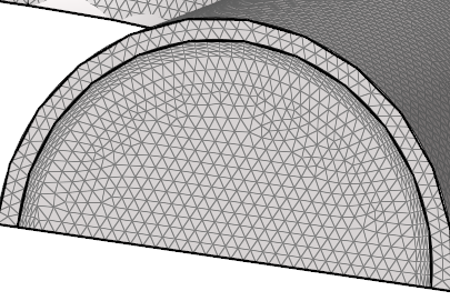

  2. Check that the Average element size is 0.03606.
  3. Accept all other default parameters.
    Figure 29.
  4. Click Mesh.
    The Run Status dialog opens. Once the run is complete, the status is updated and you can close the dialog.
    Tip: Right-click the mesh job and select View log file to view a summary of the meshing process.
  5. Observe the refined mesh around the pipe walls.

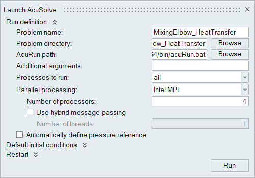

  1. From the Solution ribbon, click the Run tool.
    Figure 31.
    The Launch AcuSolve dialog opens.
  2. Set the Parallel processing option to Intel MPI.
  3. Optional: Set the number of processors to 4 or 8 based on availability.
  4. Deactivate the Automatically define pressure reference option.
  5. Leave the remaining options as default and click Run to launch AcuSolve.
    Figure 32.

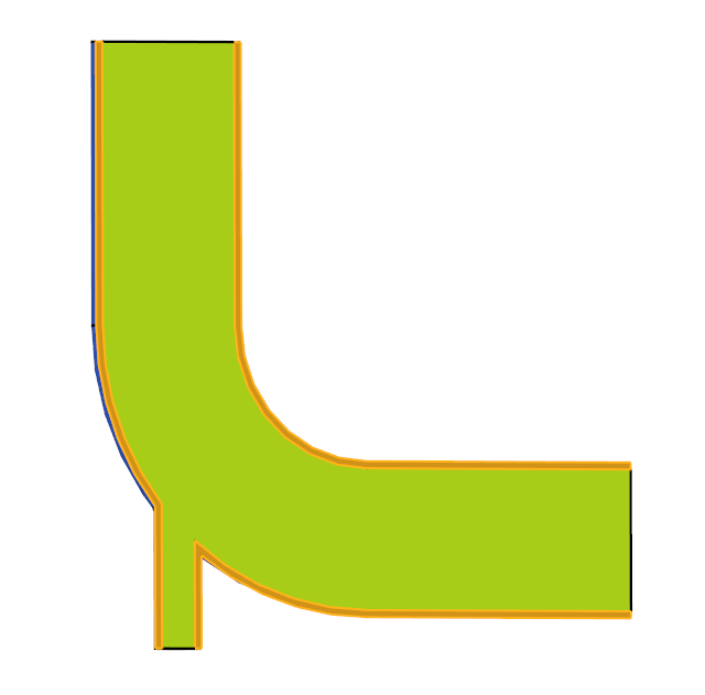

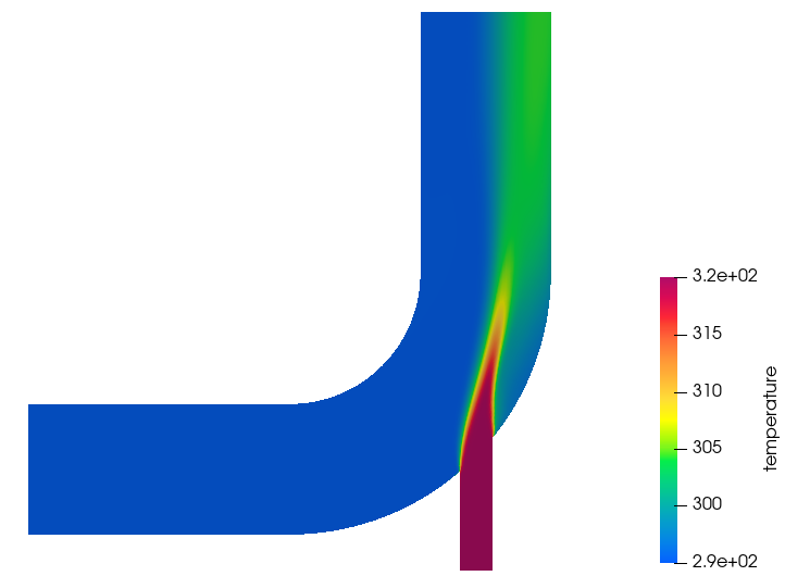

  4. Isolate the Symmetry flow boundary in the Post Browser.
  5. Right-click the Symmetry and select Edit.

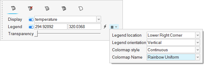

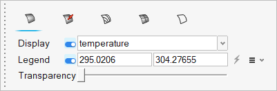

  6. In the display properties microdialog, set the display to temperature and activate the Legend toggle.
  7. Click and set the Colormap Name to Rainbow Uniform.
    Figure 33.
  8. Click on the guide bar.
    Figure 34.

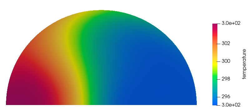

  9. Isolate the Outlet flow boundary in the Post Browser.
  10. Click the Right face on the View Cube to align the model.
    Figure 35.
    Tip: If the orientation is not the standard, click the face again to re-align the model back to the standard orientation.
  11. Right-click Outlet and select Edit.
  12. Display the temperature.
  13. Click to reset the range.
    Figure 36.
