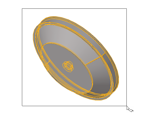

    From the SolidChecks legend, you can see the model's solids have five intersections.
    Figure 8.
  3. Click Intersections.
    A guide bar used to fix intersecting solids displays.
  4. Optional: Click and to review each error.
  5. Activate the Keep common interface option then click Combine All.
    The SolidChecks legend should now display zero for all errors.

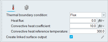

  3. In the microdialog, enter the values shown in the figure below.
    Figure 28.

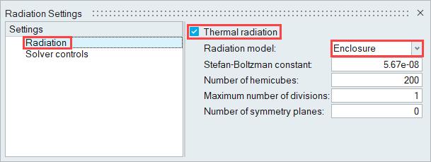

  2. Activate Thermal radiation and set the Radiation model to Enclosure (if not set already).
    Figure 30.

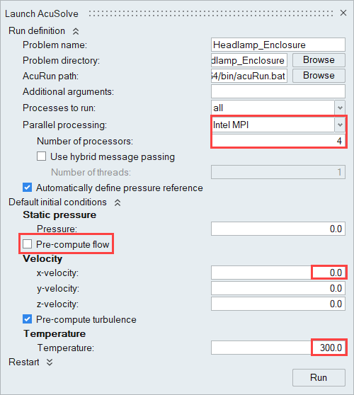

    The Launch AcuSolve dialog opens.
  2. Set the Parallel processing option to Intel MPI.
  3. Optional: Set the number of processors to 4 or 8 based on availability.
  4. Expand the Default initial conditions menu and deactivate the Pre-compute flow option.
  5. Set the x-velocity to 0 and the Temperature to 300.
  6. Leave the remaining options as default and click Run to launch AcuSolve.

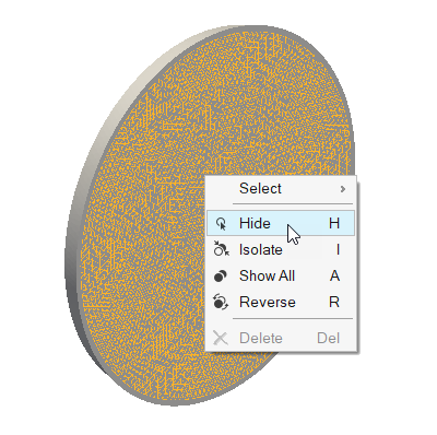

  5. Select the inner surface of the lens in the modeling window, right-click, and select Hide.
    Figure 45.

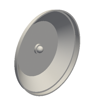

  6. Similarly, hide the outer fluid surface.
    You should end up with a view as shown below.

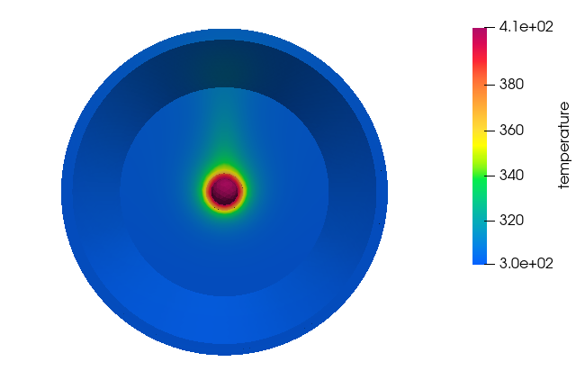

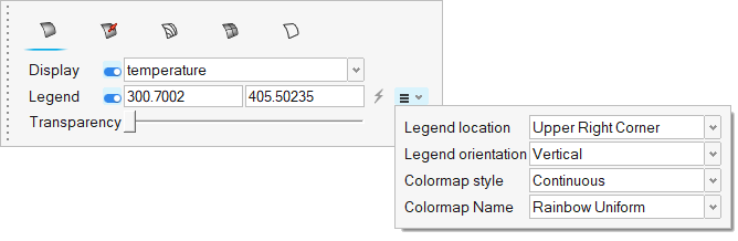

  9. In the display properties microdialog, set the display to temperature.
  10. Activate the Legend toggle and click to reset the range.
  11. Click , set the Legend location to Upper Right Corner, and the Colormap Name to Rainbow Uniform.
    Figure 48.
  12. Click on the guide bar.
  13. Click the Top face on the View Cube to align the model.
    Figure 49.
    Figure 50.
