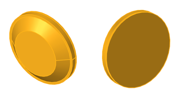

The problem to be solved is shown schematically in Figure 1 and Figure 2. It consists of a simple headlamp with a housing, lens, and a bulb. The inner cavity of the bulb is filled with air and the wattage of the bulb is 1W, which is modeled as a volumetric heat source. The Boussinesq density model is used for the air to consider the natural convection effects in the fluid volume. The heat generated in the bulb is transferred by three means: conduction from the bulb to the housing, natural convection in the air volume, and radiation from the bulb to the air and lens volume. The outer surfaces of the headlamp are assumed to be at a constant temperature of 300 K.
The air and the lens are modeled as participating media for radiation heat transfer. For the purpose of this tutorial, the absorption coefficient of air is considered to be zero. The following radiation material properties are used for the air and the lens volumes.

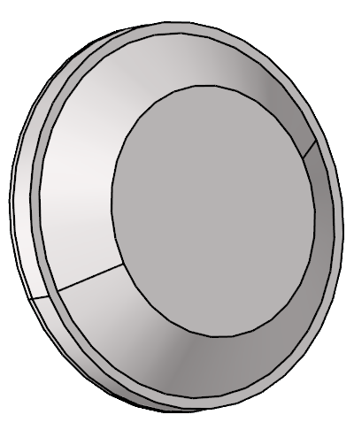

  1. From the menu bar, click File > Import > Geometry Model.
  2. In the Import File dialog, browse to your working directory and then select ACU-T3204_headlamp.x_t and click Open.
  3. In the Geometry Import Options dialog, leave all the default options unchanged and then click Import.
    Figure 5.
    Figure 6.

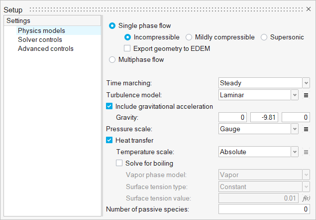

  2. Under the Physics models setting:
    1. Verify that Time marching is set to Steady.
    2. Select Laminar as the Turbulence model.
    3. Activate the Include gravitational acceleration checkbox and set the gravity in the y direction to -9.81.
    4. Activate the Heat transfer checkbox.

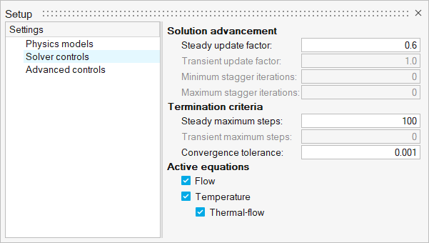

    Figure 12.
  3. Click the Solver controls setting and activate the Thermal flow equation.
    Figure 13.

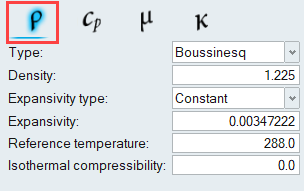

  5. In the Density tab,
    1. Set the Type to Boussinesq.
    2. Set the Density value to 1.225.
    3. Set the Expansivity value to 0.00347222.
    4. Reference temperature value to 288.
    Figure 15.

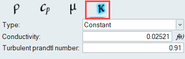

  8. Click the Conductivity tab and set the Conductivity value to 0.02521.
    Figure 18.

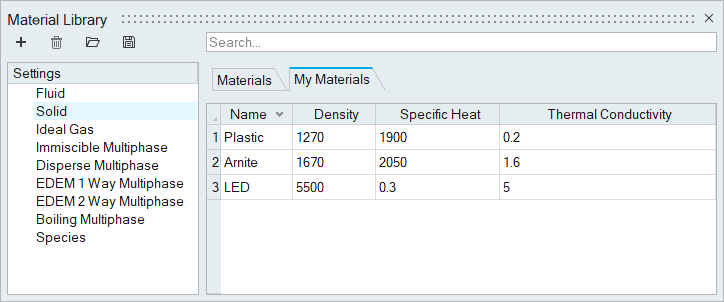

  10. Select Solid in the Settings menu, click the My Materials tab, and then click to create a new solid material model.
  11. Name the material Plastic and set the following values.
    The Type should be Constant for each property.
    • Density: 1270
    • Specific Heat: 1900
    • Conductivity: 0.2
  12. Close the material creation dialog to return to the Material Library dialog.
  13. Similarly, create new solid material models named Arnite and LED with the following properties.
    Arnite:
    • Density: 1670
    • Specific Heat: 2050
    • Conductivity: 1.6
    LED:
    • Density: 5500
    • Specific Heat: 0.3
    • Conductivity: 5.0
    Figure 19.
  14. Close all dialogs and save the model.

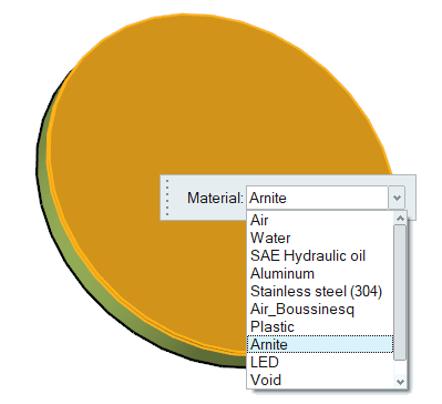

  2. Click the lens volume highlighted in the figure below and select Arnite from the Material drop-down menu.
    Figure 21.
  3. On the guide bar, click to execute the command and remain in the tool.

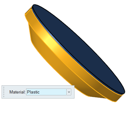

  4. Click the housing volume and assign the Plastic material model.
    Figure 22.

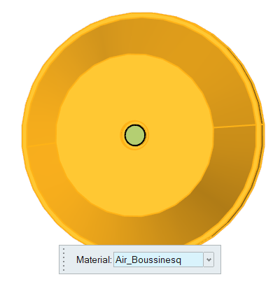

  6. In the Materials legend, right-click Air and select Isolate.
  7. Click the air volume and assign the Air_Boussinesq material model.
    Figure 23.

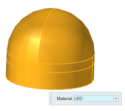

  10. Click the bulb volume and assign the LED material model.
    Figure 24.

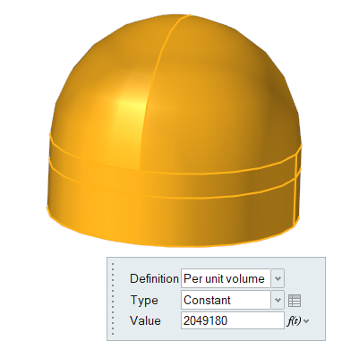

Define the Heat Source
  1. From the Flow ribbon, click the Sources > Heat tool.
    Figure 25.
  2. In the modeling window, select the bulb volume.
  3. In the Heat Source dialog, set the heat source value to 2049180 W/m3.
    Figure 26.
  4. On the guide bar, click to execute the command and exit the tool.

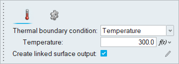

In this problem, all the surfaces are walls and will therefore be assigned the default wall boundary condition. The outer walls of the headlamp will be given a no-slip wall boundary condition with a constant temperature.
  1. From the Flow ribbon, click the No Slip tool.
    Figure 27.
  2. In the modeling window, select the surfaces highlighted in the figure below.
    Figure 28.
  3. In the microdialog, enter the values shown in the figure below.
    Figure 29.
  4. In the Boundaries legend, double-click Wall, rename it to Outerwalls, and then press Enter.
  5. On the guide bar, click to execute the command and exit the tool.

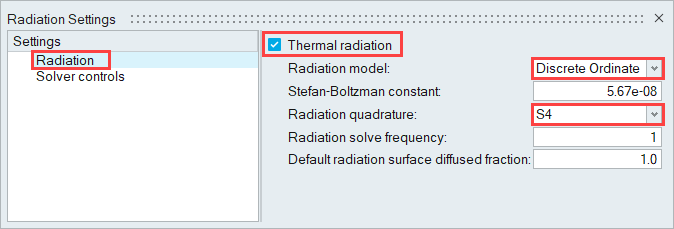

  2. Activate Thermal radiation and set the Radiation model to Discrete Ordinate.
  3. Verify that the Radiation quadrature is set to S4.
    Figure 31.
  4. Close the dialog.

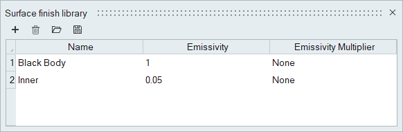

    Click to add a new emissivity model.
  2. Set the Name of the model to Inner and the Emissivity value to 0.05 by double-clicking on the entity fields.
    Figure 33.

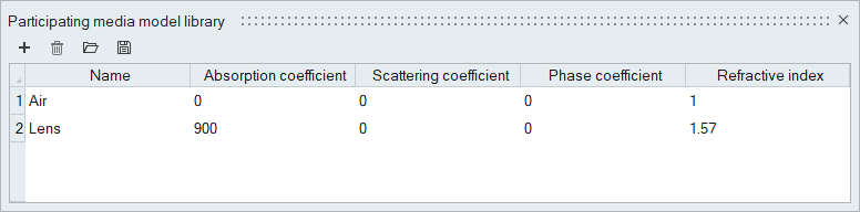

Define the Participating Media Radiation Models
  1. From the Radiation ribbon, Participating Media tools, click the Model tool.
    Figure 34.
    The Participating media model library opens.
  2. Click to add a new model.
  3. Name the new model Air and assign the following property values:
    • Absorption coefficient - 0
    • Scattering coefficient - 0
    • Phase coefficient - 0
    • Refractive index - 1
  4. Similarly, create another model named Lens and assign the following property values:
    • Absorption coefficient - 900
    • Refractive index - 1.57
    Figure 35.

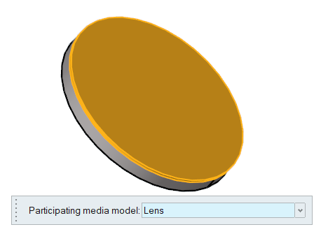

  2. Click the lens volume and assign the Lens model from the microdialog drop-down.
    Figure 37.

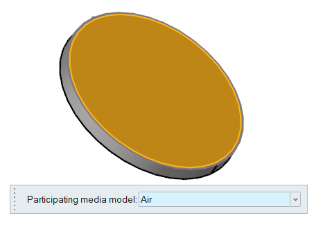

  5. Select the air volume and assign the Air model.
    Figure 38.
  6. On the guide bar, click to execute the command and remain in the tool.

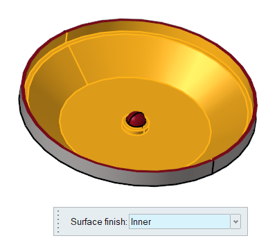

Assign Surface Finish Models
  1. From the Radiation ribbon, click the Surface Finish tool.
    Figure 39.
  2. Select only the inner surfaces of the housing - i.e. the housing-air interface.
    Figure 40.
    A total of nine surfaces should be selected.
  3. Assign the Inner model from the microdialog drop-down

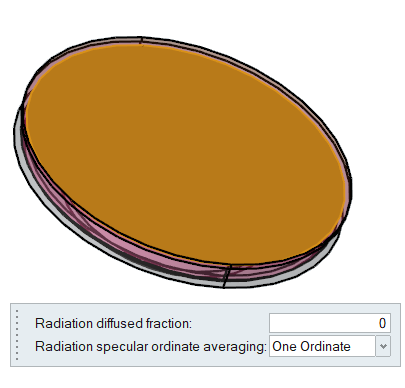

    Notice that all the surfaces except the Lens-Air interface surface are made transparent. Since the Air and Lens volumes are defined as participating media, HyperMesh CFD automatically detects the surfaces that can be defined as an internal radiation interface and only those surfaces will be available for selection when this tool is active.
  2. Using the box selection method, draw a window around the model.
    Observe that the lens-air interface is the only surface that is selected.
  3. In the microdialog, set the Radiation diffused fraction to 0.
    Figure 42.

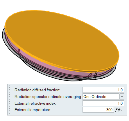

  5. Click the External Boundary tool.
    Figure 43.
  6. Select the three outer surfaces of the lens volume.
  7. In the microdialog, set the Radiation diffused fraction to 1, the External refractive index to 1, and the External temperature to 300 K.
    Figure 44.

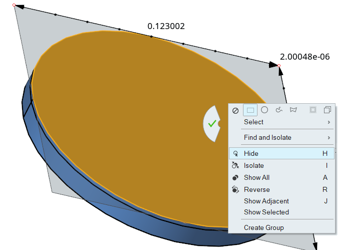

Define the Surface Mesh Controls
  1. From the Mesh ribbon, click the Surface tool.
    Figure 45.

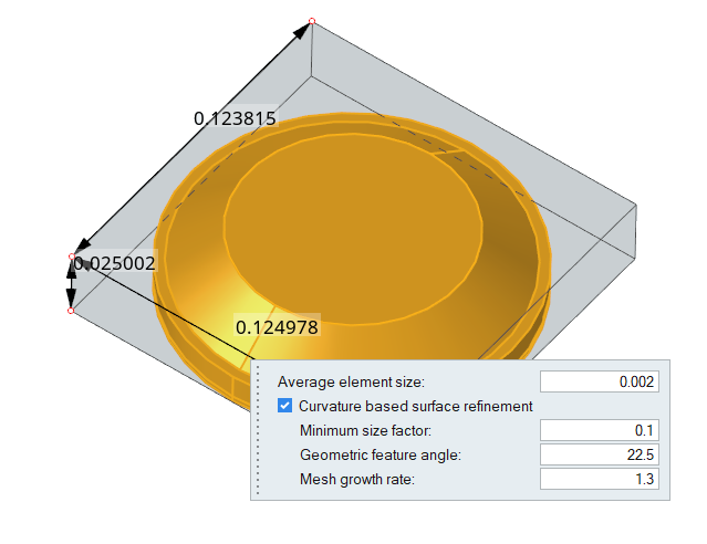

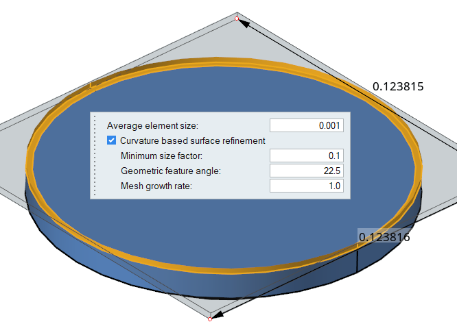

  2. Using the box selection method, select all the surfaces in the model.
  3. In the microdialog, set the Average element size to 0.002.
    Figure 46.
  4. On the guide bar, click to execute the command and remain in the tool.
  5. Select the surface highlighted in the figure below and hide it by pressing the H key or by right-clicking and selecting Hide from the context menu.

  6. Select the three surfaces highlighted in the figure below.
  7. In the microdialog, set the Average element size to 0.001 and the Mesh growth rate to 1.
    Figure 48.
  8. On the guide bar, click to execute the command and exit the tool.

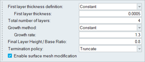

  3. Enter the following values in the microdialog:
    • First layer thickness definition: Constant
    • First layer thickness: 0.0005
    • Total number of layers: 4
    • Growth method: Constant
    • Initial growth rate: 1.3
    • Termination policy: Truncate
    • Activate the Enable surface mesh modification option
    Figure 50.

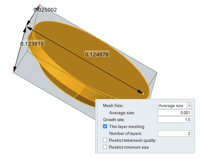

Define the Volume Mesh Controls
Since the thickness of the housing and the lens solids are small, you will use the thin layer meshing tool so that when the volume mesh is generated, there will be two layers across the thickness of those solids.
  1. From the Mesh ribbon, click the Volume Mesh tool.
    Figure 51.
  2. Select the housing and the lens solids.
    1. Set the Average size to 0.001.
    2. Set the Growth rate to 1.0.
    3. Activate the Thin layer meshing option and set the Number of layers to 2.
    Figure 52.

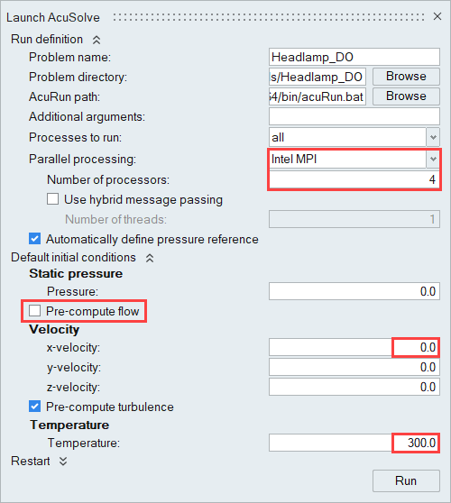

Run AcuSolve
  1. From the Solution ribbon, click the Run tool.
    Figure 54.
    The Launch AcuSolve dialog opens.
  2. Set the Parallel processing option to Intel MPI.
  3. Optional: Set the number of processors to 4 or 8 based on availability.
  4. Expand the Default initial conditions menu and deactivate the Pre-compute flow option.
  5. Set the x-velocity to 0 and the Temperature to 300.
  6. Leave the remaining options as default and click Run to launch AcuSolve.
    Figure 55.
    The Run Status dialog opens. Once the run is complete, the status is updated and you can close the dialog.

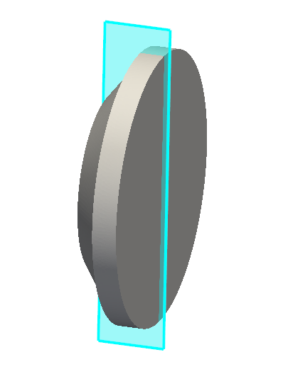

  4. Click the Slice Planes tool.
    Figure 56.
  5. Select the plane perpendicular to the x-axis, as shown in the figure below.
    Figure 57.

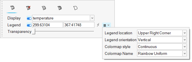

  7. Click in the slice plane microdialog.
  8. In the display properties microdialog, set the display to temperature.
  9. Activate the Legend toggle and click to reset the range.
  10. Click , set the Legend location to Upper Right Corner, and the Colormap Name to Rainbow Uniform.
    Figure 59.

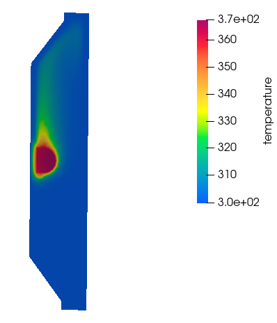

  11. Click on the guide bar.
  12. In the Post Browser, hide the Boundary Collections.
    Figure 60.
    Figure 61.

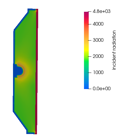

  13. Right-click Slice Plane 1 in the browser and select Edit.
  14. Change the display to incident radiation.
  15. Click to refresh the legend's range.
  16. Click on the guide bar.
    Figure 62.
