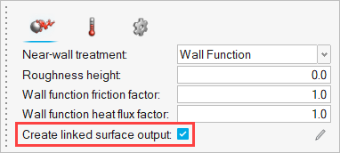

The nodal surface output needs to be activated for all the surfaces in order to create the OptiStruct input deck from the acuOptiStruct command.

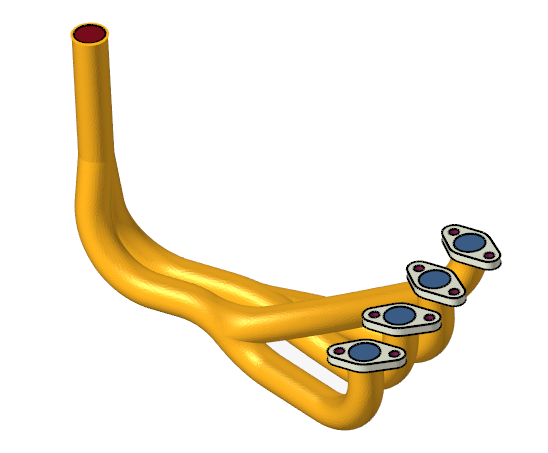

Validate the Geometry
To focus on the physics part of the simulation, this tutorial input file contains geometry which has already been validated. Observe that a blue check mark appears on the top-left corner of the Validate icon on the Geometry ribbon. This indicates that the geometry is valid, and you can go to the flow set up.
Figure 4.

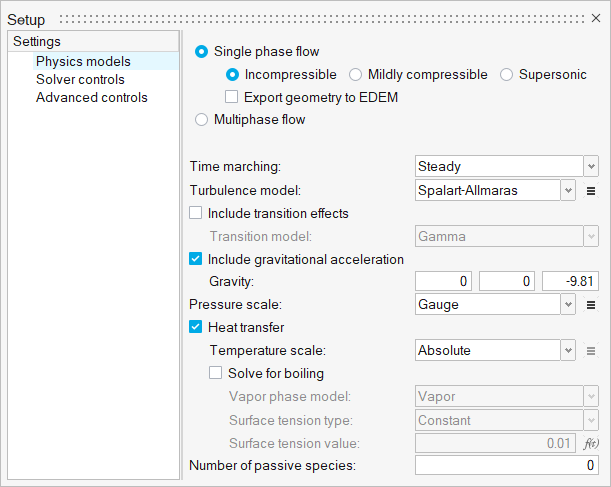

  2. Under the Physics models setting:
    1. Set Time marching to Steady.
    2. Select Spalart-Allmaras as the Turbulence model.
    3. Activate the Include gravitational acceleration and Heat transfer options.
    Figure 6.

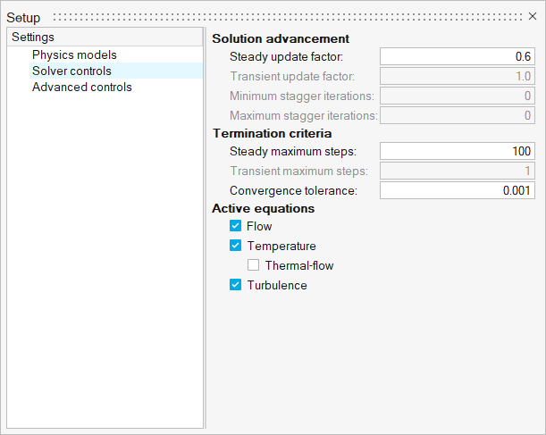

  3. Click the Solver controls setting.
  4. Verify the following parameters.
    Figure 7.

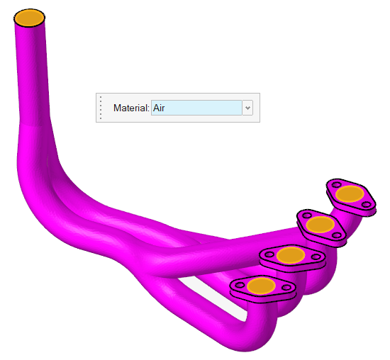

  2. Select the exhaust volume.
  3. In the microdialog, select Stainless steel (304) from the drop-down.
    Figure 9.
  4. On the guide bar, click to execute the command and remain in the tool.
  5. Select the air volume.
  6. In the microdialog, select Air from the drop-down.
    Figure 10.
  7. On the guide bar, click to execute the command and exit the tool.

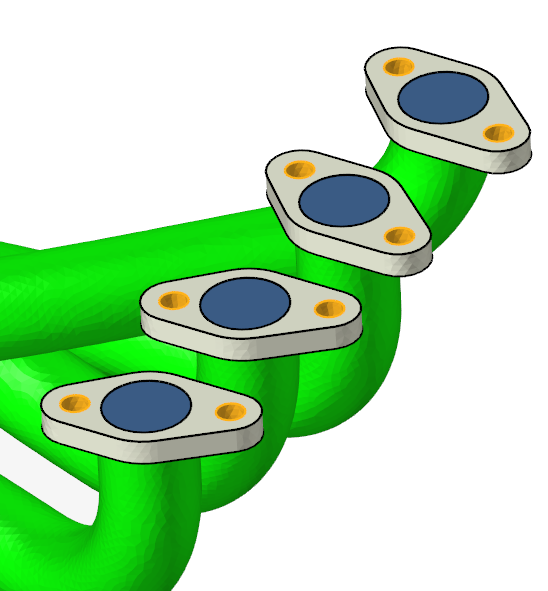

  2. Select the manifold inlets highlighted in the figure below.
    Figure 12.

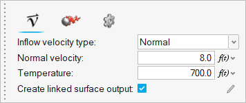

  3. In the microdialog, set the Inflow velocity type to Normal, the Normal velocity to 8.0 and the Temperature to 700.

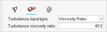

  4. Click the Turbulence tab in the microdialog. Set the input type to Viscosity Ratio and the viscosity ratio value to 40.
    Figure 14.

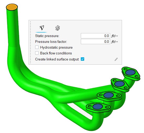

  7. Select the face highlighted in the figure below and verify that both the static pressure and the pressure loss factor are set to 0.

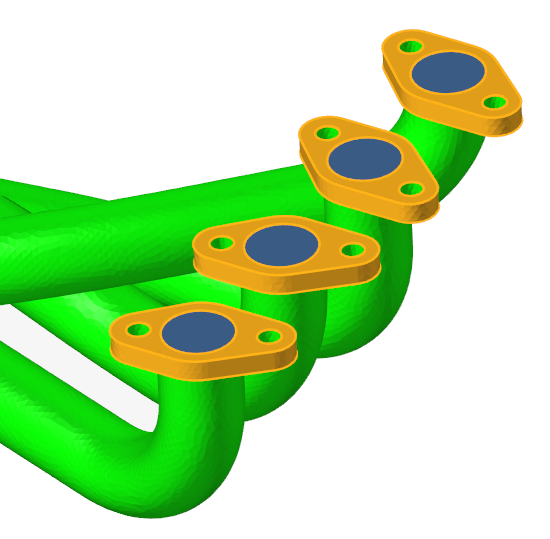

    Figure 17.
  10. Select the wall flanges.
    Figure 18.
    Note: Make sure you select the bottom and side surfaces of the flanges. In total, 12 surfaces should be selected.

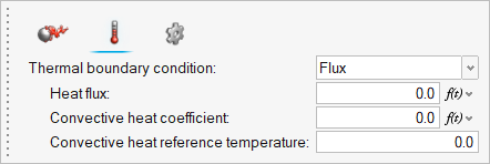

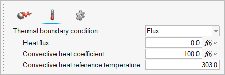

  11. In the microdialog, click the Temperature tab, set the Convective heat coefficient to 100, and the Convective heat reference temperature to 303.
    Figure 19.
  12. Click on the guide bar.
  13. Using the Boundaries legend, rename the surface group to Flanges.
  14. Select the flange bolts.
    Figure 20.
  15. In the microdialog, click the Temperature tab and assign the same parameters as the wall flanges.
  16. Click on the guide bar.
  17. Using the Boundaries legend, rename the surface group to Flange_Bolts.

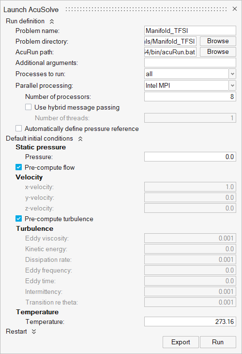

  2. Set the Parallel processing option to Intel MPI.
  3. Optional: Set the number of processors to 4 or 8 based on availability.
  4. Deactivate the Automatically define pressure reference option.
  5. Expand Default initial conditions and check that the Pre-compute flow and Pre-compute turbulence options are activated.
  6. Set the Temperature to 273.16.
  7. Leave the remaining options as default and click Run to launch AcuSolve.

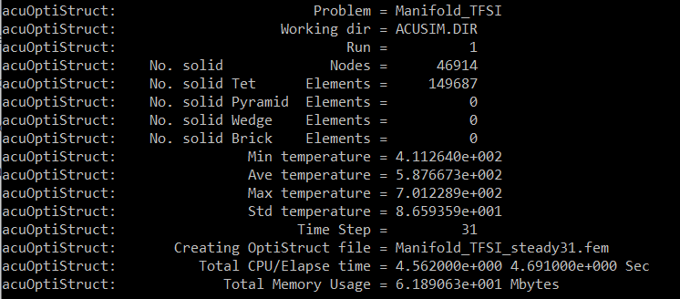

    acuOptiStruct -solids “Exhaust Steel” -spcsurfs “Flange_Bolts – Output”,”Outlet_End – Output” -spcsurfsdof 123456,123456 -spcsurfsdofvals 0,0 -type sl
    You should see a similar output as below when the command executes successfully.

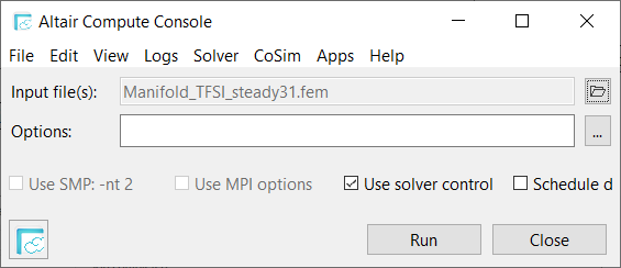

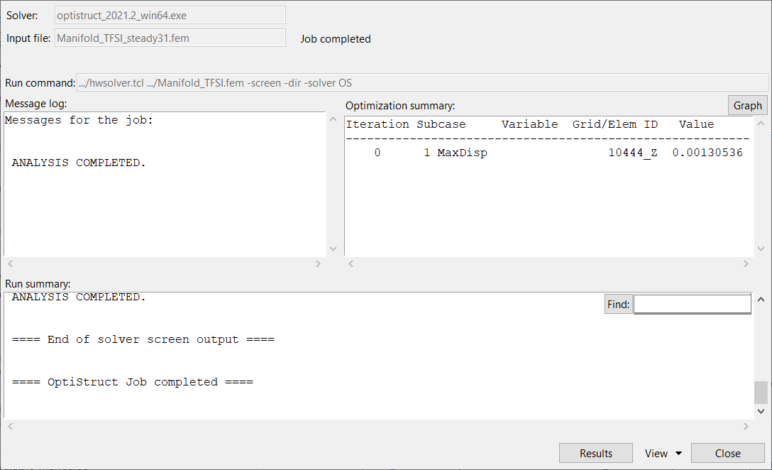

  1. Start OptiStruct from the Windows Start menu by clicking Start > Altair <version> > Compute Console.
  2. Click next to Input file(s).
  3. Browse to the location that you are using as your working directory.
  4. Select the .fem file.
    Figure 30.
  5. Click Run to run the case.
    Figure 31.

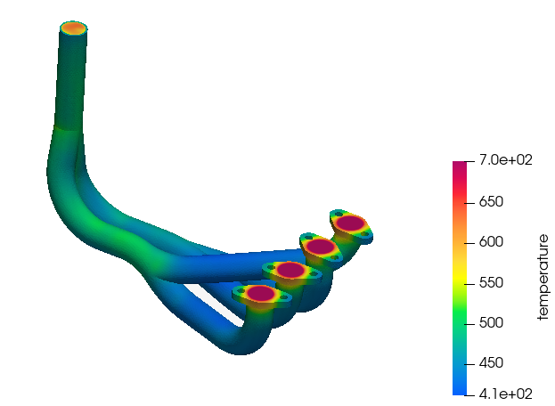

  5. Select all the surfaces.
  6. In the microdialog, set the display to temperature and activate the Legend toggle.
  7. Click and set the Colormap name to Rainbow Uniform.
    Figure 33.
  8. Click on the guide bar.
    Figure 34.

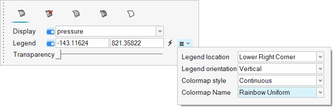

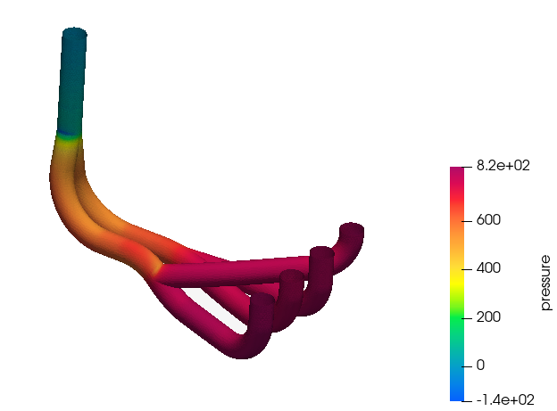

  9. In the Post Browser, right-click Fluid_Walls and select Edit.
  10. In the microdialog, change the display to pressure and activate the Legend toggle.
  11. Click and set the Colormap name to Rainbow Uniform.
    Figure 35.
  12. Hide all other flow boundaries.
    Figure 36.

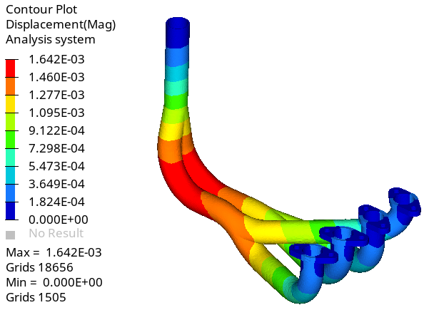

    Observe that this model contains only the solid domain since only the solid is included while generating the OptiStruct solver deck.
  6. Click on the Results toolbar to open the Contour panel.
  7. In the panel area, set the Result type to Displacement (v).
  8. Click Apply to plot the displacement magnitude contours.
    Figure 37.

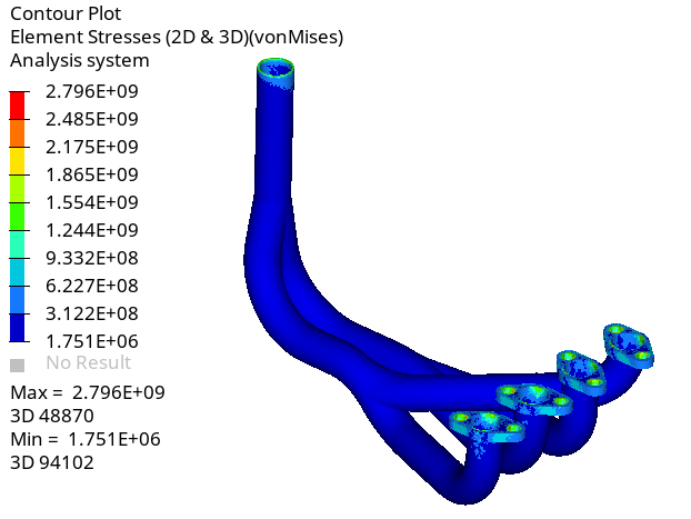

  9. Change the Result type to Element Stresses (2D & 3D) (t) and select vonMises from the drop-down below.
  10. Click Apply.
    Figure 38.
