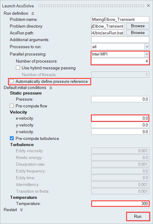

  1. From the Solution ribbon, click the Run tool.
    Figure 5.
    The Launch AcuSolve dialog opens.
  2. Set the Parallel processing option to Intel MPI.
  3. Optional: Set the number of processors to 4 or 8 based on availability.
  4. Deactivate the Automatically define pressure reference option.
  5. Expand the Default initial conditions drop-down and deactivate the Pre-compute flow option.
  6. Set the x-velocity to 0 and the Temperature to 300.
  7. Click Run to launch AcuSolve.

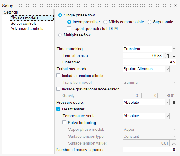

  2. Under the Physics models setting:
    1. Set Time marching to Transient.
    2. Set the Time step size to 0.053 and the Final time to 4.5.
    Figure 9.

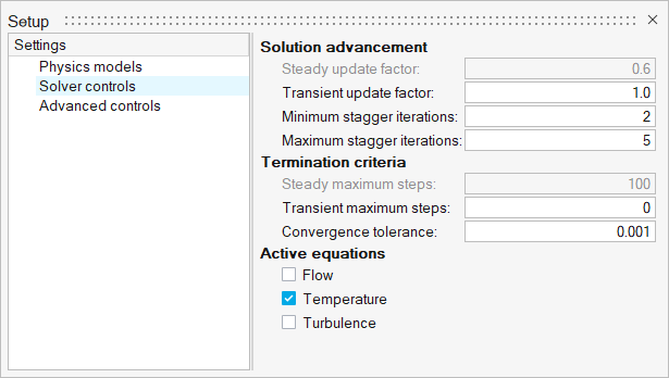

  3. Click the Solver controls setting.
  4. Set the Minimum and Maximum stagger iterations to 2 and 5, respectively.
  5. De-activate the Flow and Turbulence equations.
    By turning these options off, AcuSolve will not update the solution to these equations. Instead, the current flow and turbulence values (generated from the steady state solution for this tutorial) will be used throughout the simulation, and AcuSolve will only solve for the temperature field.

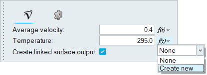

  3. In the microdialog, click multiplier function drop-down menu next to Temperature and select Create new.

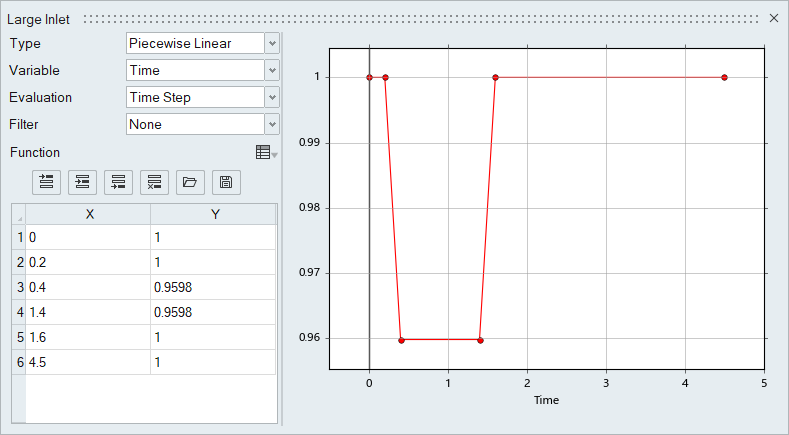

  4. In the dialog that appears, edit the name of the multiplier function by clicking in the top-left corner. Set the name to Large Inlet.
  5. Set the Type to Piecewise Linear.
  6. Verify that the Variable is set to Time and Evaluation is set to Time Step.
  7. Click four times to add four new rows to the bottom of the table.
  8. Enter the table values for the multiplier function as shown in the image below.
    Figure 14.
  9. Close the dialog.

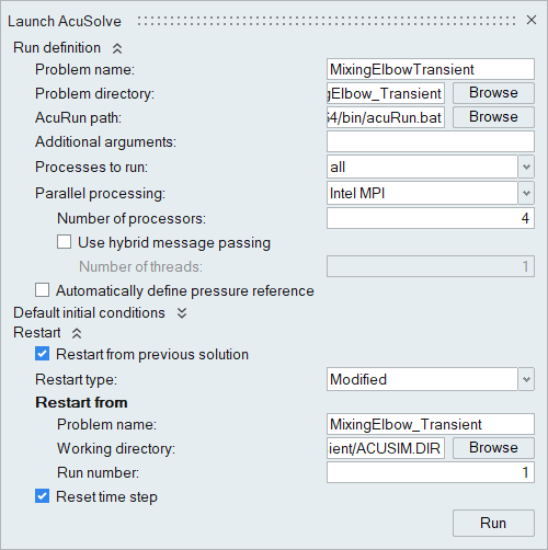

    Figure 18.
  5. Expand the Restart menu and activate the Restart from previous solution option.
  6. Set the Problem name to MixingElbow_Transient (if not set already).
  7. Verify that the Run number is set to 1 and the Reset time step option is activated.
  8. Click Run to start the transient run.

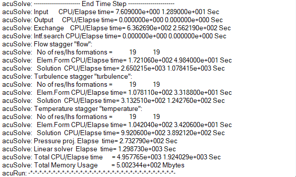

  9. In the Run Status dialog, right-click the second AcuSolve run and select View log file.
  10. Once the solver run is complete, close the Run Status dialog.

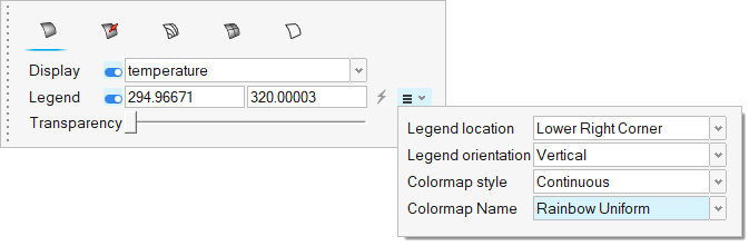

  6. Select all visible surfaces in the modeling window.
  7. In the display properties microdialog, set the display to temperature.
  8. Activate the Legend toggle and click to reset the range.
  9. Click and set the Colormap Name to Rainbow Uniform.

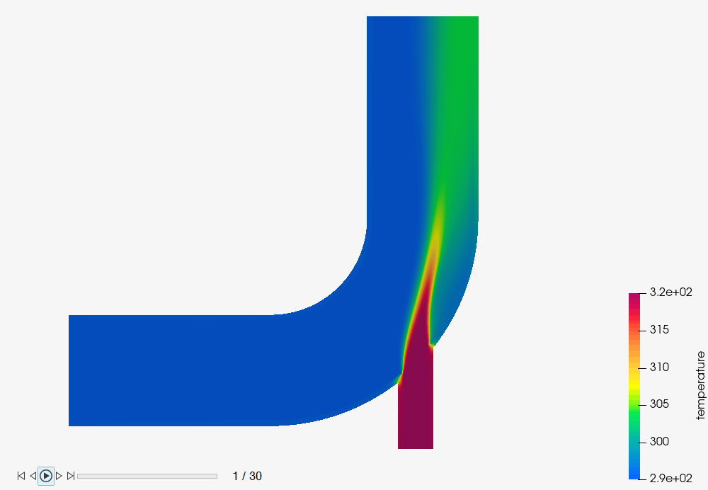

    Figure 22.
  10. Click on the guide bar.
  11. Click at the bottom of the modeling window to view an animation of the transient flow with respect to the temperature contour.
