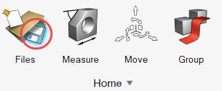

  2. Create a new .hm database in one of the following ways:
    • From the menu bar, click File > Save.
    • From the Home tools, Files tool group, click the Save As tool.
      Figure 4.

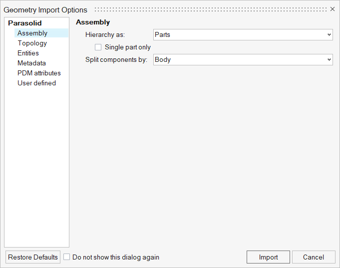

  1. From the menu bar, click File > Import > Geometry Model.
  2. In the Import File dialog, browse to your working directory then select ACU-T3201_Atrium.x_t and click Open.
  3. In the Geometry Import Options dialog, leave all the default options unchanged and then click Import.

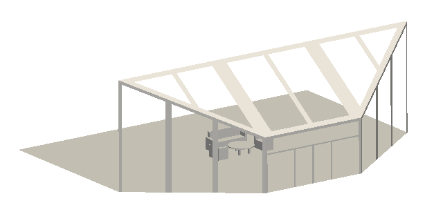

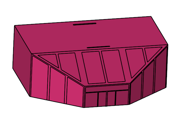

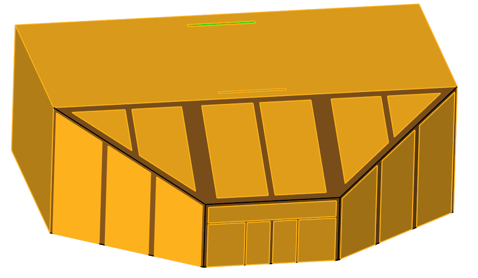

    The model contains an atrium with glass panes supported by an aluminum frame in the front. Air enters from the opening on the roof in the front and exits through the outlet in the rear.

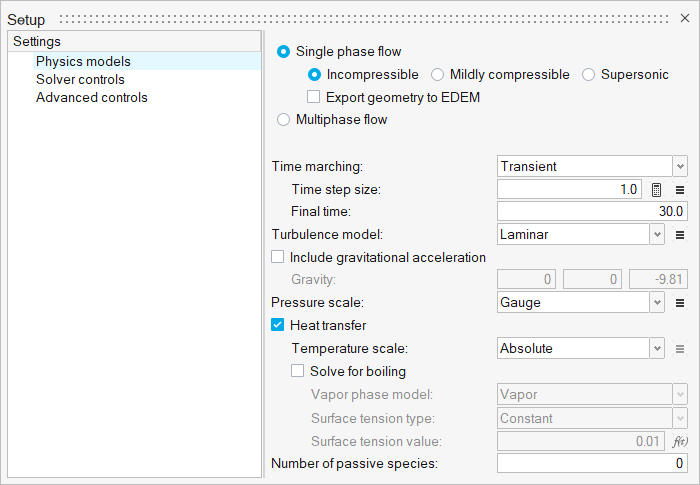

  2. Under the Physics models setting:
    1. Set Time marching to Transient.
    2. Set the Time step size to 1 and the Final time to 30.
    3. Set the Turbulence model to Laminar.
    4. Activate the Heat transfer checkbox.
    Figure 10.

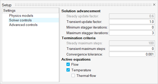

  3. Click the Solver controls setting and set the Maximum stagger iterations to 3.
    Figure 11.

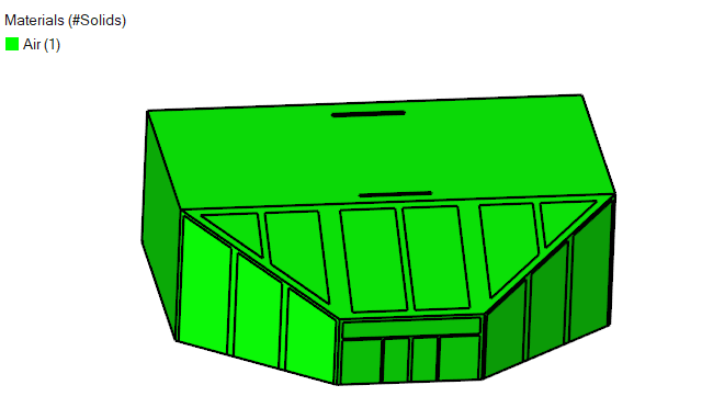

  2. Verify that Air is assigned as the material for the fluid domain.
    The legend in the top-left corner of the modeling window lists all the material models assigned to the current model.
    Since this model has a single volume, by default air is assigned as the material for the fluid domain.
    Figure 13.

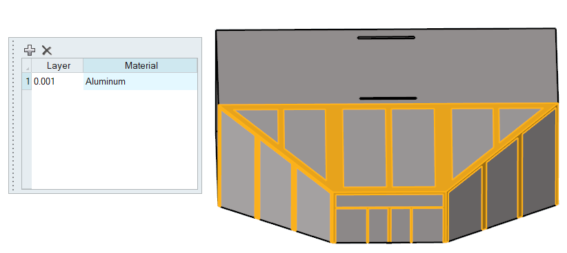

In this simulation, you will model the aluminum frames as a thin solid.
  1. From the Flow ribbon, click the Thin tool.
    Figure 14.

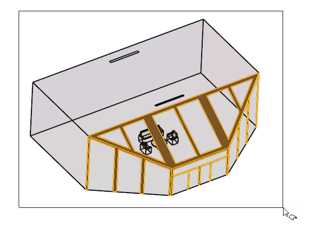

  2. In the modeling window, select the four surfaces highlighted in the image below.
    Figure 15.
  3. In the microdialog, set the Layer thickness to 0.025 and the Material to Aluminum.
  4. On the guide bar, verify that the number of Parent Surfaces selected is 4 and then click to execute the command.
    Once the command is executed, the legend should be updated accordingly to reflect the changes.

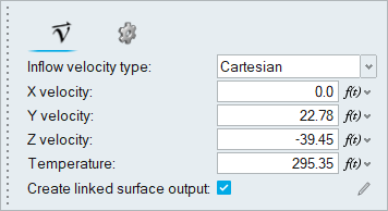

  2. In the modeling window, click the inlet surface highlighted in the figure below.
    Figure 17.
  3. In the microdialog, enter the values shown below.
    Figure 18.
  4. Click on the guide bar to execute the changes.

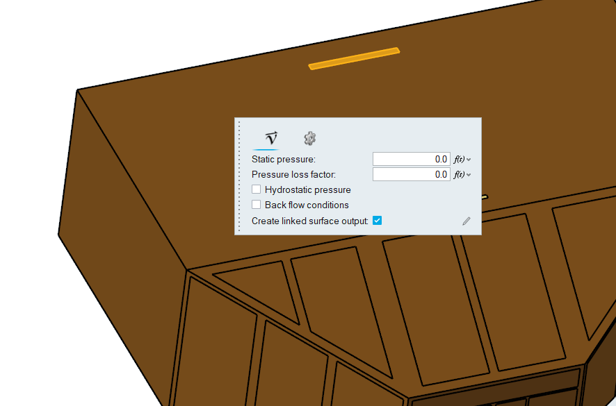

  5. Click the Outlet tool.
    Figure 19.
  6. Select the surface highlighted in the figure below and then click on the guide bar.

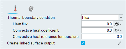

  14. In the microdialog, enter the values shown in the figure below.
    Figure 27.
  15. Click . In the new microdialog that appears, set the Nodal Output frequency to 1.

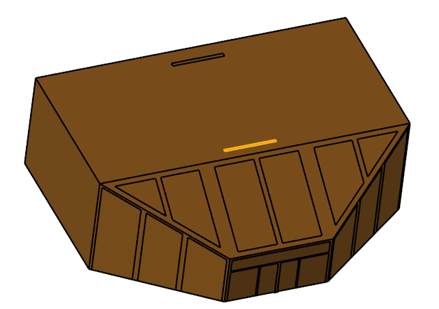

  19. Select all the surfaces except the aluminum frame, as highlighted in the figure below.
    Figure 29.

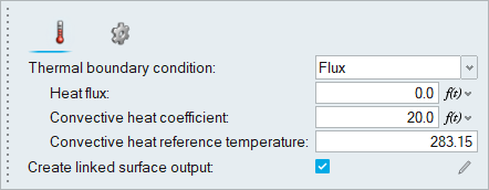

  20. In the microdialog, enter the values shown in the figure below.
    Figure 30.
  21. Click . In the new microdialog that appears, set the Nodal Output frequency to 1.

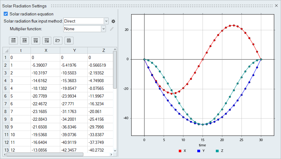

  2. In the Solar Radiation Settings dialog, activate the Solar radiation equation.
  3. Click to load the solar flux input from a file.
  4. In the Open file dialog, set the filter to Dat file (.dat) and select the SolarLoad.dat file provided with the input file for this tutorial.
  5. Click Open.
    The plot in the dialog should look like the one shown in the figure below.
    Figure 33.
  6. Close the dialog and save the model.

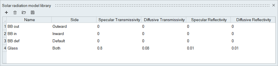

  2. In the Solar radiation model library, click to add a new solar radiation model.
  3. In the Name column, enter BB out and set the Side to Outward.
  4. Similarly, create the other models and enter the values as shown in the figure below.
    Figure 35.

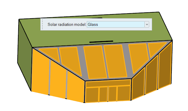

  4. Select all the glass surfaces shown in the figure below, assign the Glass model to them, and then click on the guide bar.
    Figure 39.

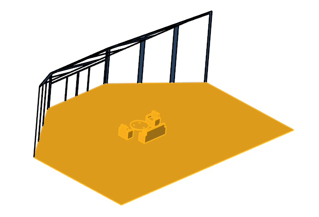

  5. Rotate the model and select the floor surface. In the microdialog, assign the BB in model and then click on the guide bar.
    Figure 40.

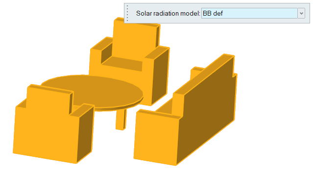

  7. Select the surfaces of the couch, table, and chairs, assign the BB def model to them, and then click on the guide bar.

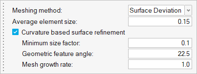

  3. In the microdialog, set the Average element size to 0.15 and the Mesh growth rate to 1.0.
    Figure 44.
  4. On the guide bar, click to execute the command and exit the tool.

  3. Set the Time step interval to 1.
    Figure 47.

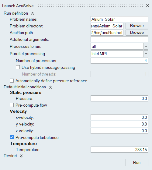

  1. From the Solution ribbon, click the Run tool.
    Figure 48.
  2. In the Launch AcuSolve dialog, set the Parallel processing option to Intel MPI.
  3. Optional: Set the number of processors to 4 or 8 based on availability.
  4. Deactivate the Automatically define pressure reference option.
  5. Expand the Default initial conditions menu.
  6. Deactivate the Pre-compute flow option.
  7. Set the Temperature to 288.15.
  8. Verify that all the values are set as shown in the figure below.
    Figure 49.
  9. Click Run.

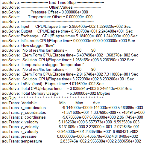

    Once the solution process is started, the Run Status dialog appears.
  10. In the dialog, right-click the AcuSolve run and select View log file.
    Once the run is complete, a summary of the solution process is shown in the .log file.
    Figure 50.

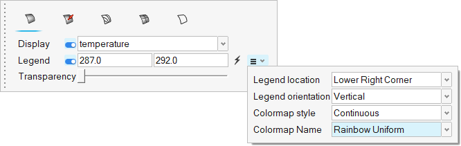

Plot the Temperature Contour
  1. In the Post Browser, right-click the ThinSolid_Floor surface group and select Edit.
  2. In the display properties microdialog, set the display to temperature and activate the Legend toggle.
  3. Set the legend bounds to 287 and 292.
  4. Click and set the Colormap Name to Rainbow Uniform.
    Figure 54.

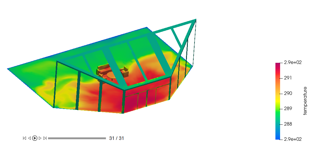

  5. Click on the guide bar.
  6. Drag the animation slider at the bottom of the modeling window to the 31st frame.
    Figure 55.
