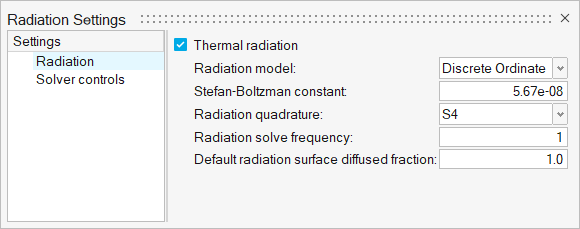

  2. Activate the Thermal radiation checkbox and set the Radiation model to Discrete Ordinate.
    Figure 14.
  3. Set the Radiation quadrature to S4.
  4. Verify that the Default radiation surface diffused fraction is set to 1.

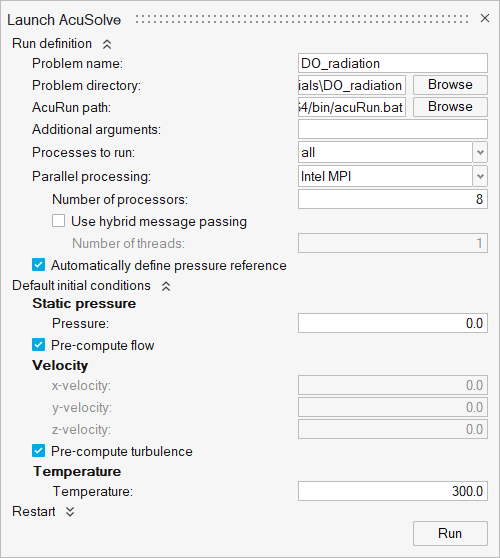

  1. From the Solution ribbon, click the Run tool.
    Figure 23.
  2. Set the Parallel processing option to Intel MPI.
  3. Optional: Set the number of processors to 4 or 8 based on availability.
  4. Expand Default initial condition and set the Temperature to 300 K.
  5. Leave the remaining options as default and click Run to launch AcuSolve.
