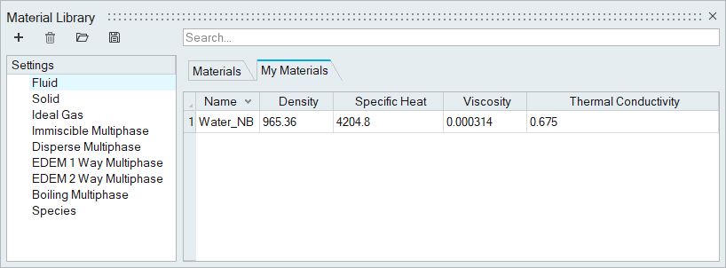

  2. Under Settings, click Fluid, and then click the My Materials tab.
  3. Verify that the material Water_NB has the properties shown below.
    Figure 5.

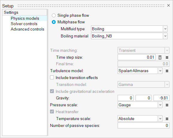

  2. Under the Physics models setting:
    1. Activate the Multiphase flow radio button.
    2. Set the Multifluid type to Boiling and the Boiling material to Boiling_NB.
    3. Ensure that the Time step size is 0.01.
    4. Select Spalart-Allmaras as the Turbulence model.
    5. Set the Gravity value to -9.81 in the z direction.
    6. Set the Pressure scale to Gauge then click besides the drop-down and set the Absolute pressure offset to 200000.
    Figure 8.

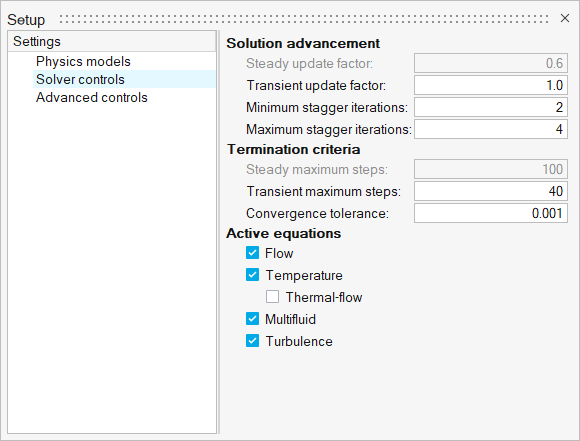

  3. Click the Solver controls setting and verify that:
    1. Minimum stagger iteration is set to 2.
    2. Maximum stagger iteration is set to 4.
    3. Transient maximum step is set to 40.
    4. The Flow, Temperature, Multifluid, and Turbulence checkboxes are activated.
    Figure 9.

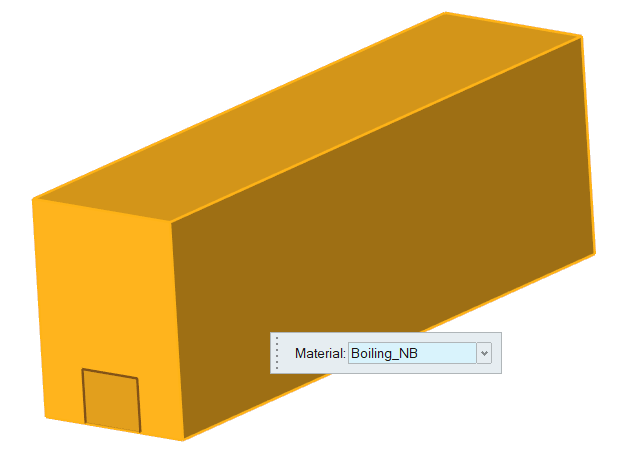

  1. From the Flow ribbon, click the Material tool.
    Figure 10.
  2. Select the model solid.
  3. Select Boiling_NB from the Material drop-down menu.
    Figure 11.
  4. On the guide bar, click to execute the command and exit the tool.

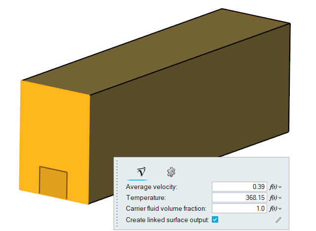

  1. From the Flow ribbon, Profiled tool group, click the Profiled Inlet tool.
    Figure 12.
  2. Click the inlet face, highlighted in the figure below.
  3. In the microdialog, enter 0.39 for the Average velocity and 368.15 for the Temperature.
    Figure 13.

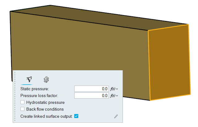

    Figure 14.
  6. Select the face highlighted in the figure below and then click on the guide bar.

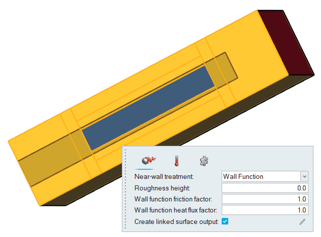

  7. Click the No Slip tool.
    Figure 16.

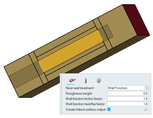

  8. Select the face highlighted in the figure below to create the Heated_wall face.
    Figure 17.

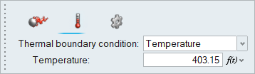

  9. Click the Temperature tab in the microdialog, set the Thermal Boundary condition to Temperature, and set the Temperature value to 403.15.
    Figure 18.
  10. On the guide bar, click to execute the command and remain in the tool.
  11. In the Boundaries legend, right-click Wall, select Rename, and enter Heated_wall.

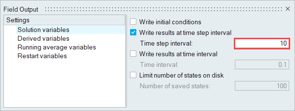

  14. From the Solution ribbon, click the Field tool.
    Figure 21.
    The Field Output dialog opens.
  15. Set the Time step interval to 10.
    Figure 22.

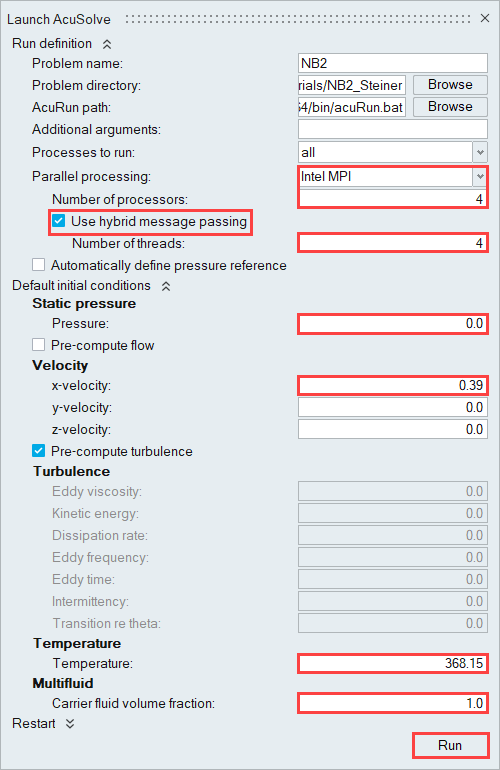

Run AcuSolve
  1. From the Solution ribbon, click the Run tool.
    Figure 25.
    The Launch AcuSolve dialog opens.
  2. Set the Parallel processing option to Intel MPI.
  3. Optional: Set the number of processors to 4 or 8 based on availability.
  4. Check the box for Use hybrid message passing and set the number of threads to the same as the number of processors.
  5. Expand Default initial conditions and enter the values as shown below to define the initial conditions.
    Figure 26.
  6. Click Run to launch AcuSolve.
    The Run Status dialog opens. Once the run is complete, the status is updated and you can close the dialog.

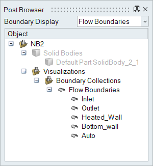

    The solid and all the surfaces are loaded in the Post Browser.
    Figure 27.

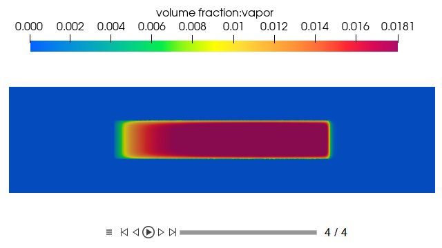

  4. To check the contours of volume fraction of vapor on the Heated_Wall and Bottom_wall surfaces, right-click those surfaces in the Post Browser and select Isolate.
  5. From the Post ribbon, click the Boundary Groups tool.
    Figure 28.
  6. Select all the surfaces on the model.

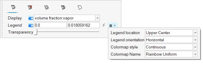

  7. In the microdialog, set the Display option to volume fraction vapor.
  8. Activate the Legend radio button and then click and set the legend properties as shown below.
    Figure 29.
  9. Click on the guide bar.
  10. Move the slider at the bottom of the modeling window to 4/4.
    The volume fraction of vapor contours are displayed on the model.
    Figure 30.
