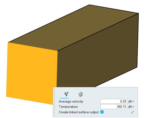

  1. From the Flow ribbon, Profiled tool group, click the Profiled Inlet tool.
    Figure 8.
  2. Click on the inlet face, highlighted in the figure below.
  3. In the microdialog, enter 0.39 for the Average velocity and 368.15 for the Temperature.
    Figure 9.
  4. On the guide bar, click to execute the command and exit the tool.
