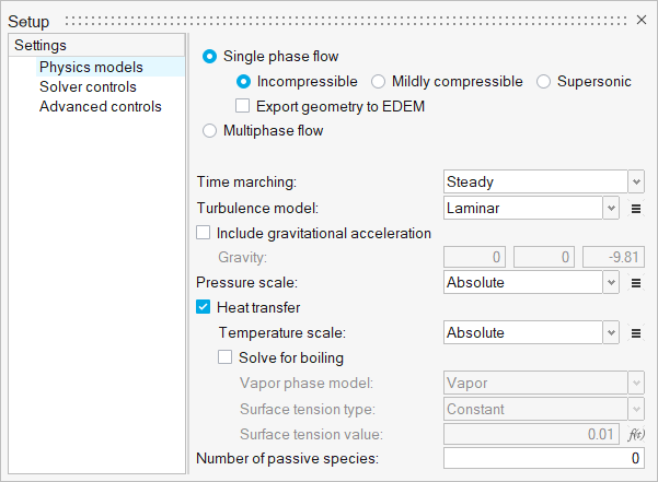

  1. From the Flow ribbon, click the Physics tool.
    Figure 4.
    The Setup dialog opens.
  2. Under the Physics models setting:
    1. Set Time marching to Steady.
    2. Set the Turbulence model to Laminar.
    3. Activate the Heat transfer checkbox.
    Figure 5.

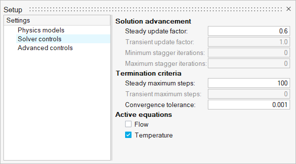

  3. Click the Solver controls setting.
  4. Deactivate the Flow checkbox.
    In this tutorial, you will only be solving for the temperature field.
    Figure 6.

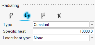

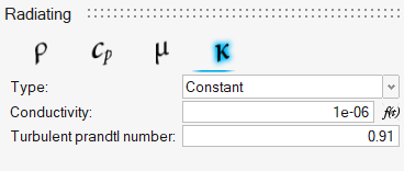

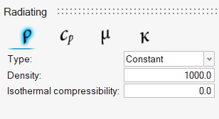

    • Density – 1000 kg/m3
    • Specific Heat – 10000 J/kg-K
    • Viscosity – 1e-5 kg/m-sec
    • Conductivity – 1e-6 W/m-K

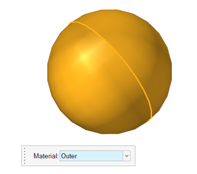

  2. Select the outer solid and assign the Outer material model from the microdialog.
    Figure 10.
  3. On the guide bar, click to execute the command and remain in the tool.

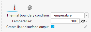

  3. Select the two faces remaining in the modeling window. In the microdialog, assign a Temperature boundary condition at 300 K.
    Figure 12.

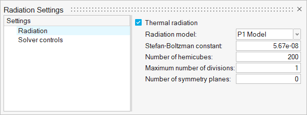

  1. From the Radiation ribbon, Thermal Radiation tools, click the Physics tool.
    Figure 13.
    The Radiation Settings dialog opens.
  2. Activate the Thermal radiation checkbox and set the Radiation model to P1 Model.

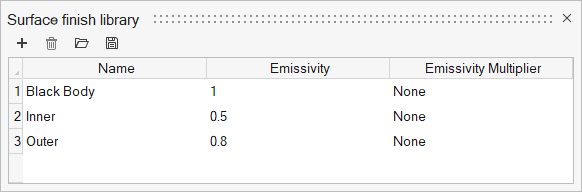

  3. In the table, double-click Surface Finish, rename it to Inner, and the Emissivity to 0.5.
  4. Similarly, create another Emissivity model named Outer with an Emissivity of 0.8.
    Figure 16.

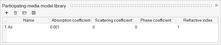

  6. Click and create a model with the following properties.
    Figure 18.

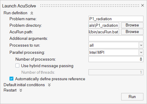

  1. From the Solution ribbon, click the Run tool.
    Figure 23.
  2. Set the Parallel processing option to Intel MPI.
  3. Optional: Set the number of processors to 4 or 8 based on availability.
  4. Leave the remaining options as default and click Run to launch AcuSolve.
    Figure 24.

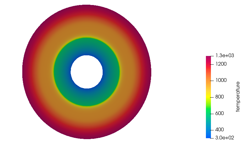

  5. Click the Slice Planes tool.
    Figure 26.
  6. Select the x-y plane in the modeling window.
  7. In the slice plane microdialog, click to create the slice plane.

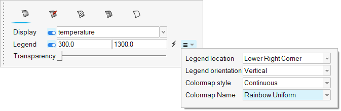

  8. In the display properties microdialog, set the display to Temperature and activate the Legend toggle.
  9. Click and set the Colormap Name to Rainbow Uniform.
    Figure 27.
  10. Click on the guide bar then press F to fit the section cut to the screen.
    Figure 28.
