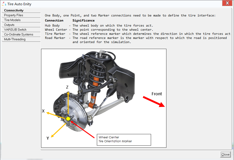

Help
The Help button in the panel area can be used to quickly access information on AutoTire and the associated parameters. On clicking the Help button, the following window is displayed.
The following section reproduces some information available in the Help dialog.

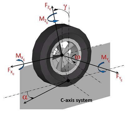

Co-Ordinate Systems
- Tydex-C Axis System
The “C” is for wheel center, and the C axis system has the following properties:
- The origin of the C-axis system is the wheel center.
- The X axis lies in the wheel plane and is parallel to the ground plane and points in the forward direction.
- The Y axis is perpendicular to the wheel plane and points towards the vehicle’s left side so that a positive rotation of the wheel and tire about the Y axis rolls the tire forward.
- The Z axis lies in the wheel plane, differs from vertical by inclination angle, and is perpendicular to the X and Y axis (Z= X x Y).

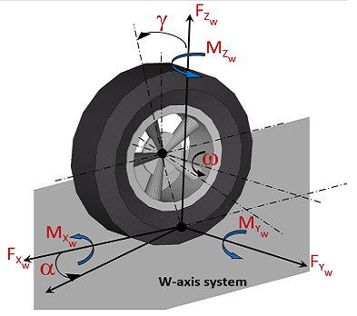

- Tydex-W Axis System
- The “W” is for wheel. The Tydex W axis system considers the local slope of the road
where the tire contacts the road, rather than assuming the road is flat.
- The origin of the W axis system lies at the ideal contact point between the wheel plane and local road plane, which is the intersection of the Tydex C System Z axis with local road plane.
- The X axis points forward along the line of intersection between the wheel plane and the local road plane.
- The Z axis is parallel to the local road normal and hence perpendicular to the local road plane.
- The Y axis is the projection of the wheel spin axis (Tydex C-Axis System Y) into the local road plane. The Y axis is perpendicular to both the X and Z axis (Y = Z x X).
Figure 3.
