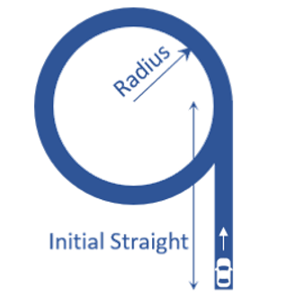

A Braking in a turn event simulates a vehicle decelerating in a circular path.
The purpose of this event is to measure the stability of a vehicle while braking and turning. The vehicle is driven straight for the entry length and then turns onto the circular path. At the "Time to Apply Brakes" time, the brake torque is ramped on using the "Brake Step Duration" time so the vehicle slows at the "Desired Deceleration" rate. The event ends at the "End of Simulation" time.

| Radius | The radius of the circle that the vehicle CG follows during the constant radius portion of the event. |
| Initial straight | Straight distance section of the event before the constant radius portion. |
