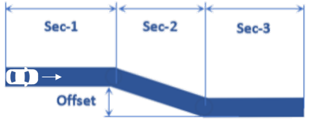

| Lateral offset | Offset distance of the lane. |
| Length- Section 1 | Length of the initial straight section of road. |
| Length- Section 2 | Longitudinal length of the initial lane change section of road. |
| Length- Section 3 | Length of the recovery straight section of road. |
| Minimum Radius | Minimum turn radius for the vehicle while transitioning between sections (applicable for Driver type = Leaning). |
| Velocity | The initial speed of the vehicle. |
| Turn direction | Direction the vehicle turns during the event (as seen by the driver). |
