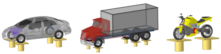

n-Post Shaker
The n-Post Shaker event simulates a vehicle supported on a test-rig by posts.
Input signals drive the posts to excite the vehicle. The vehicle’s response in the form of predicted loads and accelerations may be used to assess durability and ride.
The input signals driving the posts can be displacements or forces and moments. The signals may be synthesized or come from testing. In addition to the standard outputs for this event, the loads for any vehicle components can be output as needed for durability analysis.
