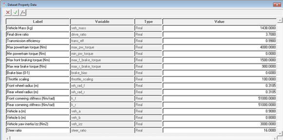

Vehicle Parameters
| Parameter | Type | Range | Comments |
| Vehicle Mass | Real | Value>0 | |
| Final drive ratio | Real | Value>0 | Coupler ratio between drive coupler output and input shafts. Note that drive ratio is 3.7 in case of default RWD model and 1 in case of default FWD model. This value is not parameterized. |
| Transmission efficiency | Real | Value>0 | Input omega/(output omega*Drive ratio). |
| Drive type | Option | Value = FWD or RWD | Four wheel drive not allowed for advanced driver. |
| Max. powertrain torque | Real | Value > 0 | Torque produced by the powertrain at the input shaft of the differential at
100% throttle. *Required only for vehicle models without CSE powertrain. Driver can directly query CSE powertrain. |
| Min. Powertrain torque | Real | Torque produced by the powertrain at the input shaft of the differential at
| Maximum front braking torque | Real | Value>0 | Maximum braking torque on front axle at 100. |
| Maximum rear braking torque | Real | Value>0 | Maximum braking torque on rear axle. |
| Brake bias | Real | 0<Value<1 | Front to Rear. 0 is 100% front, 1 is 100% rear. |
| Front wheel radius | Real | Value>0 | Loaded radius |
| Rear wheel radius | Real | Value>0 | Loaded radius |
| Front cornering stiffness | Real | Value>0 | |
| Rear cornering stiffness | Real | Value>0 | |
| Vehicle a | Real | Value>0 | X component (Vehicle SAE system) of the distance from vehicle front axle to vehicle CG. |
| Vehicle b | Real | Value>0 | (Wheel base - vehicle a) |
| Vehicle yaw inertia | Real | Value>0 | |
| Steer ratio | Real | Value>0 | Ratio of steering wheel input to tire motion (toe). |

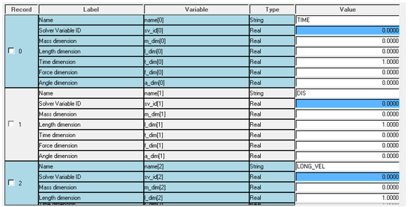

Signal Dimensions
$Example ADF end conditions block
(END_CONDITIONS)
{SIGNAL GROUP ABS OPERATOR VALUE TOLERANCE WATCH_TIME}
LONG_VEL 0 Y SS 0.0 0.0001 1.50
ROLL_ANGLE 1 Y SS 0.0 0.0001 1.50
PITCH_ANGLE 2 Y SS 0.0 0.0001 1.50
YAW_RATE 3 Y SS 0.0 0.0001 1.50
CG_Z 4 Y SS 0.0 0.0001 1.50
$------------------------------------------------------------------------------------------------------------------Using this block in ADF and signals dimension dataset, Driver will know the appropriate conversion factors for each and every value.
