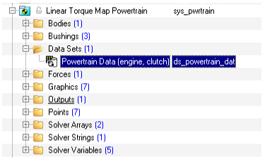

Dataset can be used to enter the data required by the powertrain.Figure 1.
Data Type Comment Throttle scaling Real Max driver throttle output - Min driver throttle output Max. powertrain torque Real Torque at drive joint at 100% throttle Min. powertrain torque Real Torque at drive joint at 0% throttle Transmission efficiency Real Output omega/Input omega of the drive train - IC Engine Friction Clutch Powertrain (Manual Transmission)
