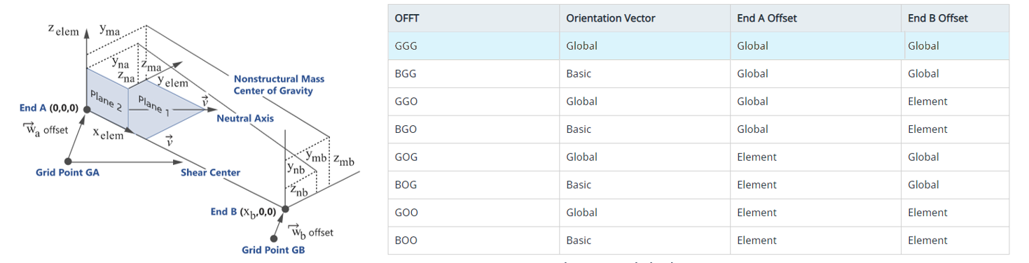

- The orientation direction defines the XY planes. Hence, whenever orientation is set along shell normal, theY-axis matches with shell positive normal as a result.
- All orientation methods, but picking reference node result on X,Y,Z orientation vector, are saved at element level.
- Using the Orientation by Vector tool (with or without system) will assign the OFFT key for orient as B. This means components are expressed in Basic system, see Figure 3.
- Using Orientation in displacement system will set OFFT for orientation as G, see Figure 3.
- Replace Orient by vector is available.

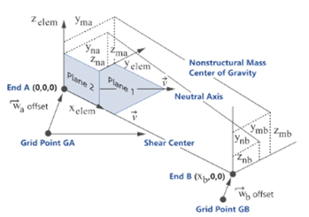

- The orientation direction defines the XZ planes. Hence, whenever orientation is set along shell normal, the Z-axis matches with shell positive normal as a result.
- All orientation methods result in the creation or update of a third node on each bar2/bar3. Hence, there is no concern of Basic/Displacement system.
- Replace Orient by vector is not available as it is meaningless.
