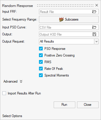

- Random Response Tool
- The Random Response tool has been added to perform random response
analysis using an existing FRF file. The required inputs for the Random
Response tool are a result file (OptiStruct
.op2/.h3d and Nastran
.op2 file types are currently supported) and a
PSD curve in CSV format.

- If the Random Response tool is rerun without closing, the output file will be overwritten. To avoid this, rename the existing file before rerunning.
