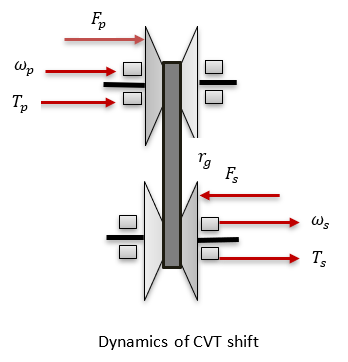

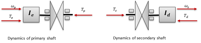

1. Kinematic Evaluation
The input to primary pulley comes from engine RPM and are related as:
The output of the secondary pulley is input to the gearbox and are related as:

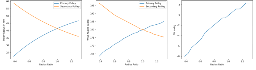

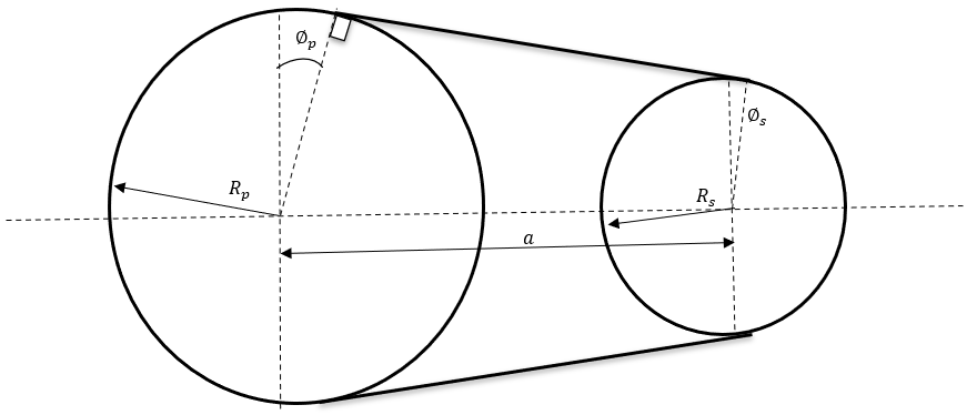

therefore you can use the Newton Raphson method to solve for
running radii and angle
Once you have running radii and angle
you can calculate the pulley’s axial displacements and wrap
angles as follows:
with respect to radius ratio:

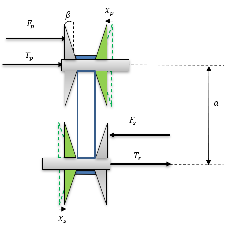

2. Clamp For Calculation
The CVT model is set such that it can model mechanical, electric, and hydraulic CVT. By default, MS models a mechanical CVT based on following parameter in CVT property file.

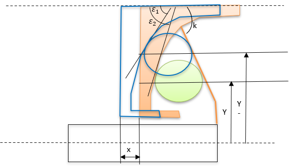

- Primary Pulley Clamping Force:

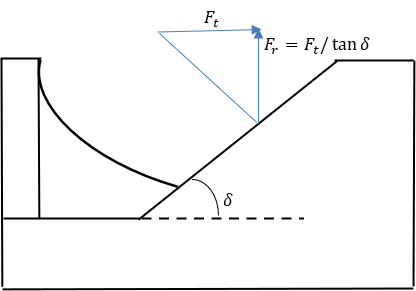

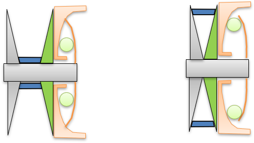

- The ‘CENTRIFUGAL’ mechanism is used mostly in scooters where the clamping force is
generated using the fly weights which rotates about the engine shaft and along the
primary pulley sheave. The sheave has a ramp profile which converts the centrifugal
force generated by flyweights into the clamping force.
Figure 7. Shift mechanism of roller weights on ramp
Figure 8. Roller and ramp geometry

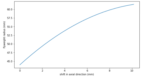

- Ramp Profile
- The curve below shows the relation between the roller distance from shaft centreline
) with axial shift of the sheave in primary pulley (
).Figure 9.

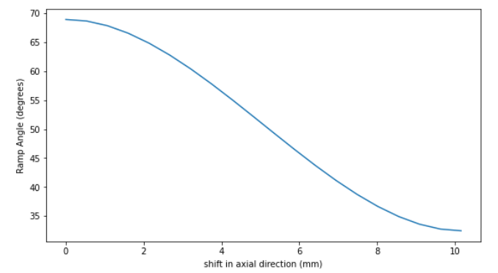

The curve below shows the relation between the ramp angle (
) with the axial shift of the sheave in primary pulley
).Figure 10.

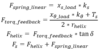

- Secondary Pulley Clamping Force:
- The secondary pulley uses a torsional spring and a torque regulator cam also known
as helix cam to generate the clamping force.
Figure 11. Helix cam/Torque regulator geometry

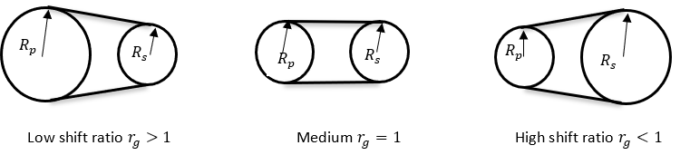

3. Shift Ratio Calculation
To calculate the shift ratio, CMM model is used. According to the CMM model, the variator belt will shift if the clamp force ratio on the primary and secondary pulley is not equal to the stationary clamp force ratio. The stationary clamp force is the ratio of clamp force at which the belt is in equilibrium and does not shift.
