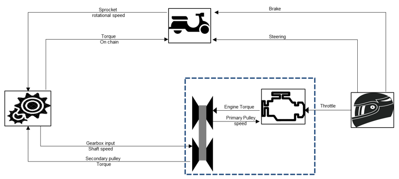

CVT Powertrain is described by a Control State Equation (CSE). The inputs to the powertrain are throttle and gearbox input shaft speed. The output is the secondary pulley torque. There are two optional clamping forces inputs to the powertrain. The CVT property file allows to choose between a mechanical CVT or electric/hydraulic CVT. By default, MS models a mechanical CVT and the clamping forces are calculated based on parameters in the CVT property file.
If the CLAMP_MECH value is something other than ‘CENTRIFUGAL’, the clamping force values
are not calculated and must be input to the model.Figure 1. Schematic of CVT Powertrain

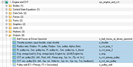

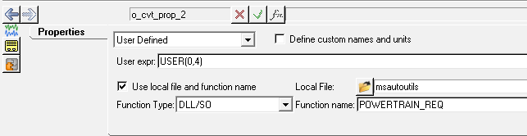

The Request Id refers to the POWERTRAIN_REQ function used to create the outputs.Figure 2.
In MotionView these six outputs access the POWERTRAIN_REQ “USER(0,id)” to display the different plots in HyperGraph.
