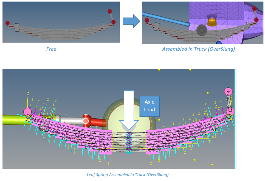

Assembled and Loaded Leaf Spring
An assembled and loaded Leaf Spring is used to model the leaf spring with information that one can easily retrieve. Generally, one can see the leaf spring assembled in trucks and also know the axle load on the leaf spring.
To model the leaf spring with the Assembled and Loaded option, you will need the profile of the leaf spring in the final Loaded Position (after assembling in truck) along with the axle load on the leaf spring. It helps to build the leaf spring model with the provided shape, with preloads on each beam (each leaf in a leaf spring is modeled with a set of beams), which gives the overall load of the provided axle load.

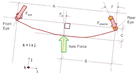

Leaf Spring in Design Shape
The following image shows the leaf spring in design shape, which is in equilibrium.
Solving for Feye and Fshackle:
Moments due to these forces at axle are
If there are n leaves in the system, each leaf should contribute the moment of M/n according to the assumptions.

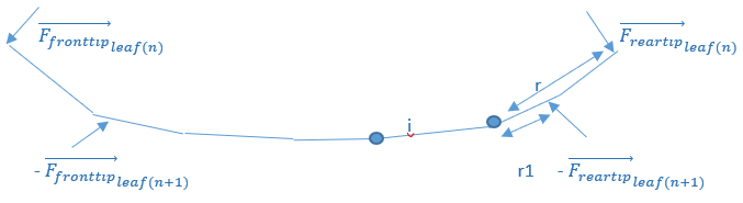

Preloads on Beams
Beams are preloaded to oppose the tipLoads for leaf to be in equilibrium:
For Beam i in leaf n,
Action-Reaction Force with Force and Moments as,
and rX
is added if the beam is on the front side
and
and rX
is added if the beam is on the rear side
And also,
and r1X
and r1X
