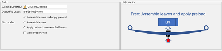

- Run Modes
- Choose any of the three options for the Run mode.

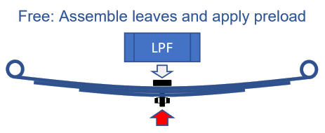

- Assemble leaves and apply preload Used to
generate preloaded system definition in one go without user
intervention. It generates a leaf spring system definitions as a
result, which can be imported into the model.

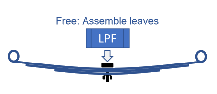

- Assemble Leaves Used to check the initial
model (before pre-loading) and modify some numerical values, but
strictly no addition of any new entities.
Figure 3.

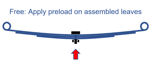

- Apply Preload on Assembled Leaves Runs a
modified .mdl model in batch mode and generates
a leaf spring system definition. This mode is applicable only after
running the script in the second mode (Assemble Leaves). Assemble
Leaves and Apply preload on assembled leaves must be used in
succession, one after the other, otherwise there may be errors.
Figure 4.
