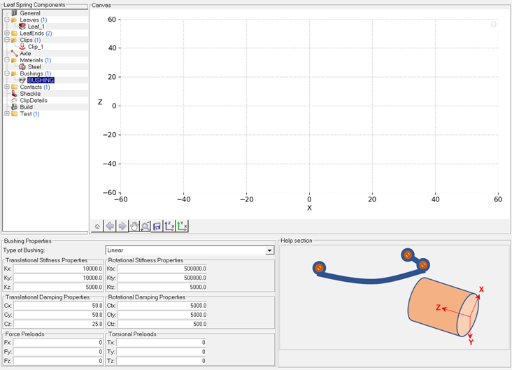

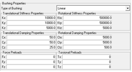

Linear Bushing
When the Linear option is selected from the Type of Bushing drop-down menu, the following options are displayed:- Translational Preload Properties/Rotational Preload Properties
- Defines the initial translational (Fx, Fy, Fz) and rotational (Tx, Ty, Tz)
preloads.
Figure 2. Linear Bushing Properties
